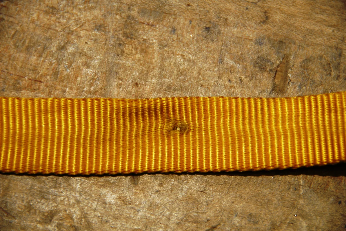

I'd like to see a close-up of the entirety of the sleeve because he is completely full of crap. This is all the damage to the sleeve it takes to completely cut an ATV winch line picking up 2 35" MTR's mounted on rims and it did it in about 15" or less of travel.
