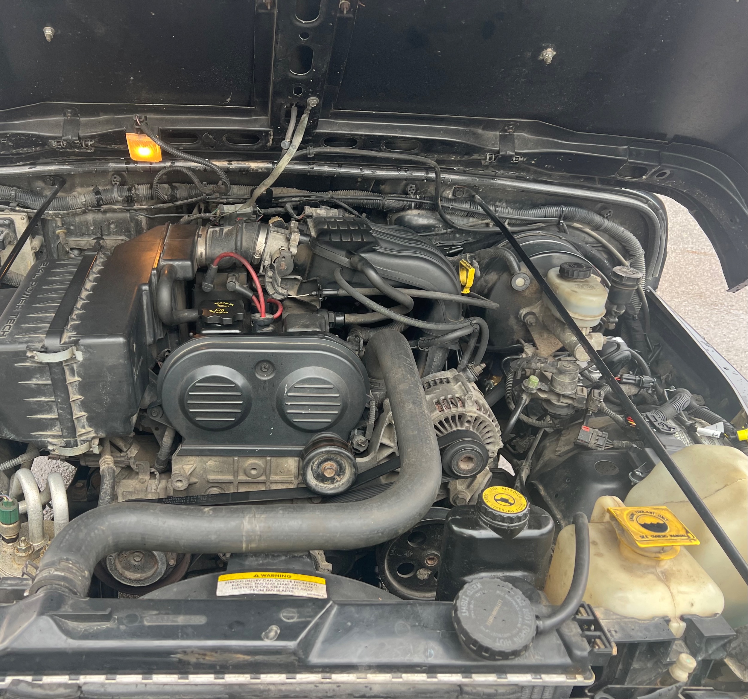

That is a 4.0 sticker on it ! Franz send us a picture of your engine

Yes, they are stickers put there by the previous owner, in fact they are not in the profile photo because I removed them
