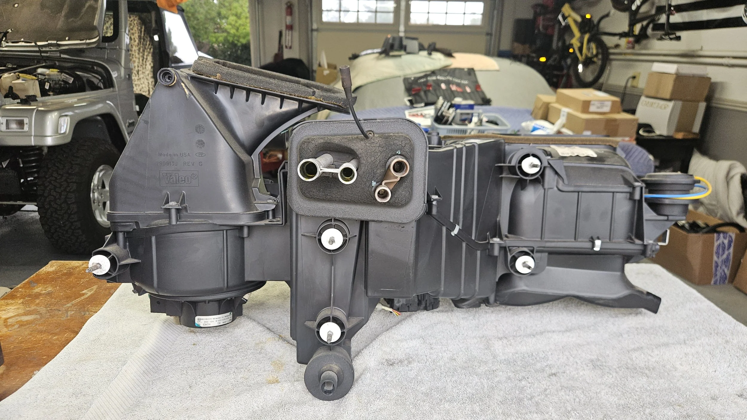

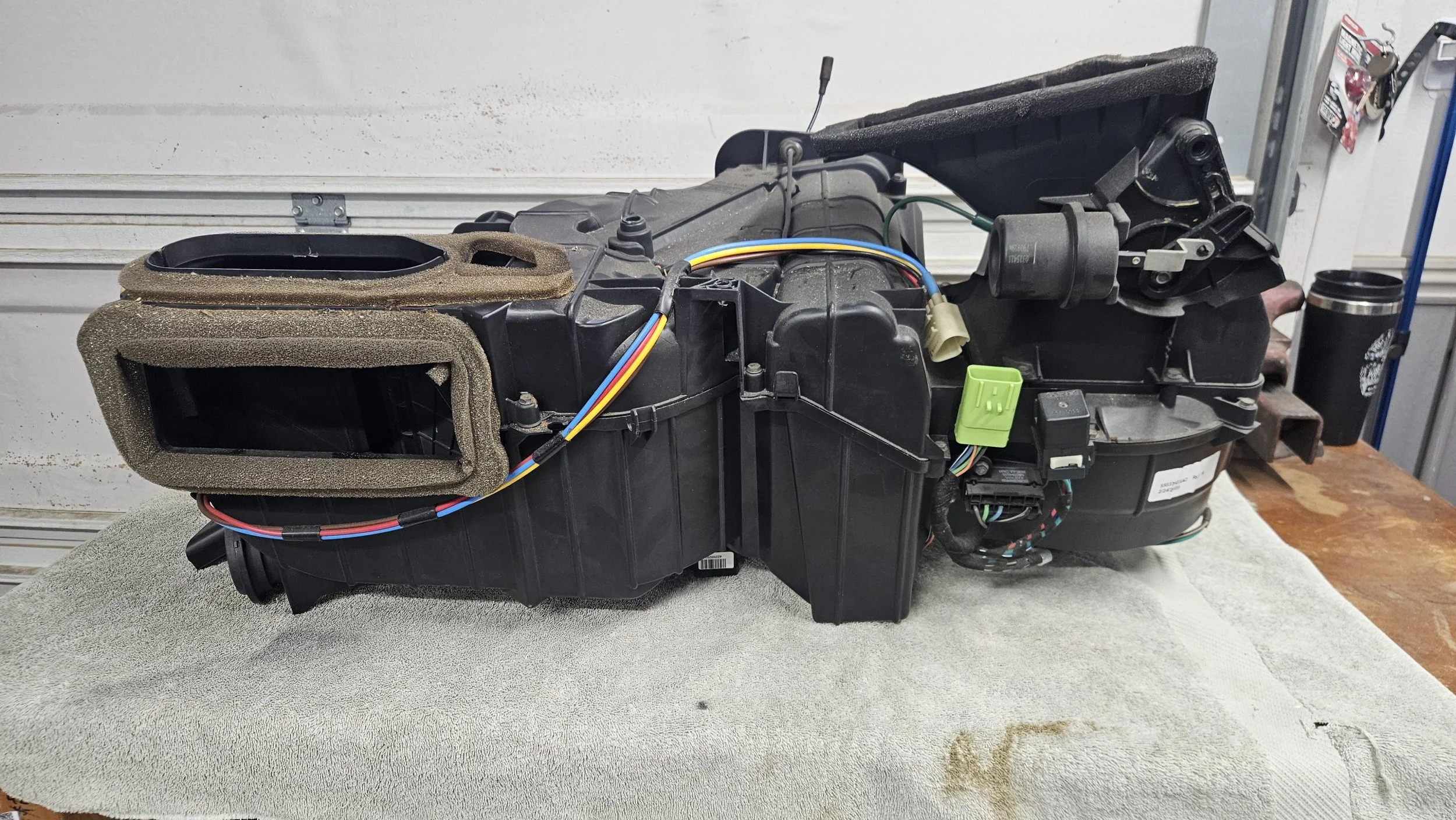

No refund necessary. I was still able to use the seal that goes around the heater lines and AC lines, but I had to butcher it a bit. The foam is super good quality. The drain seal fit well. I used some of the other included foam for the panel vent seal.

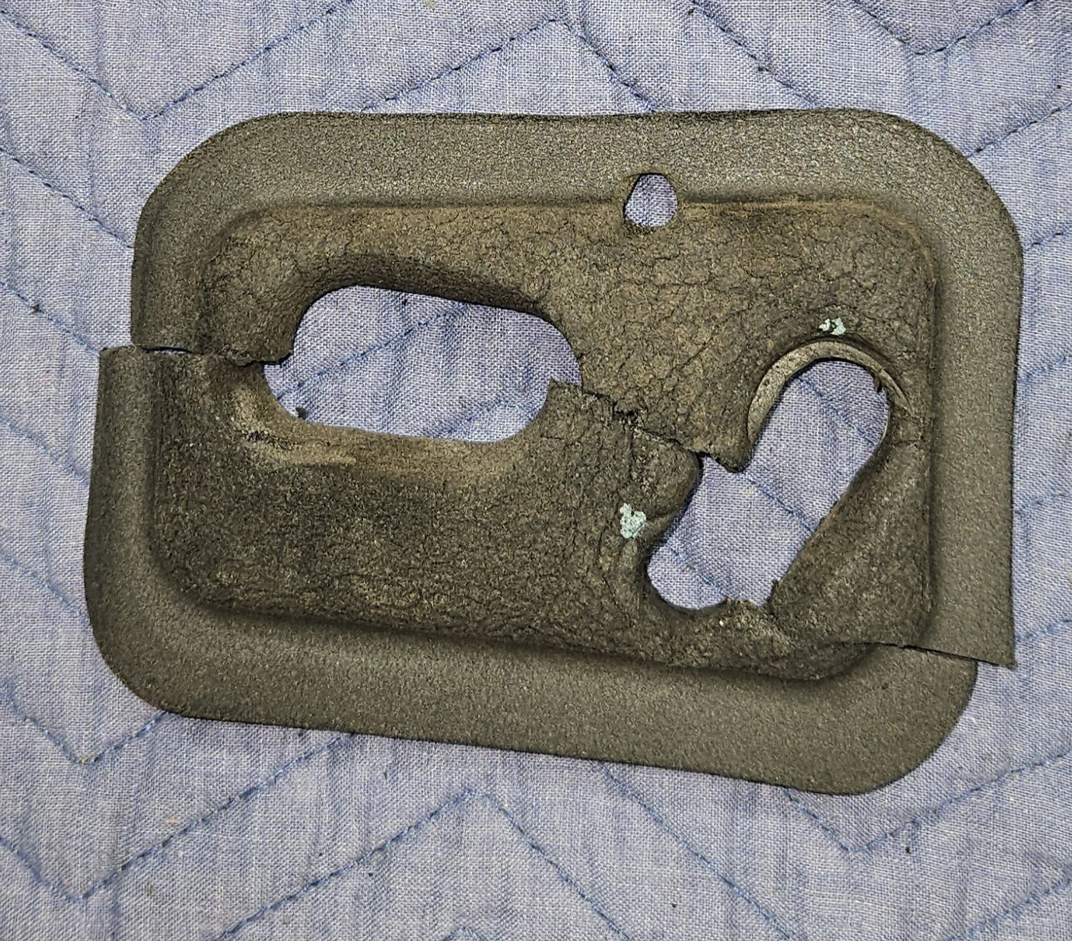

The biggest difference with the heater/AC lines seal is that the OEM heater core lines are offset as opposed to one on top of the other. Here's some photos. I'll include photos of the other foam seals as well.

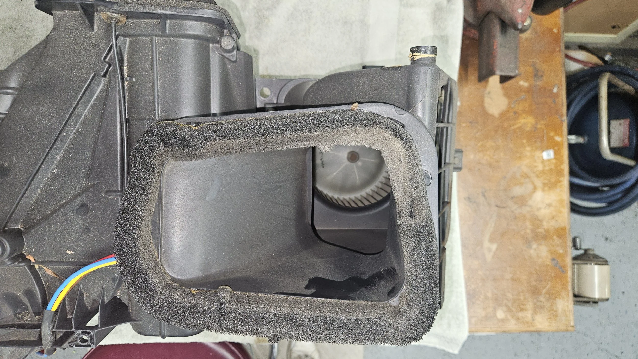

This is the main air Inlet from the cowl.
Original seal..
