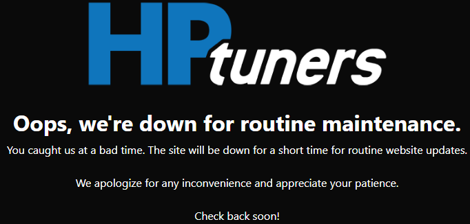

Did I just get lucky and find this thread at the same time as they were doing maintenance? Are Hp Tuners still a good solution for making adjustments? I have a spare PCM from a 2000 but it had the skim key thing and I wanted to test it out in my 2001. It will start but then stop because of the security key stuff not being on the 2001 unit.

Working for me...

https://www.hptuners.com/
Working for me...

Working now for me too thanks.

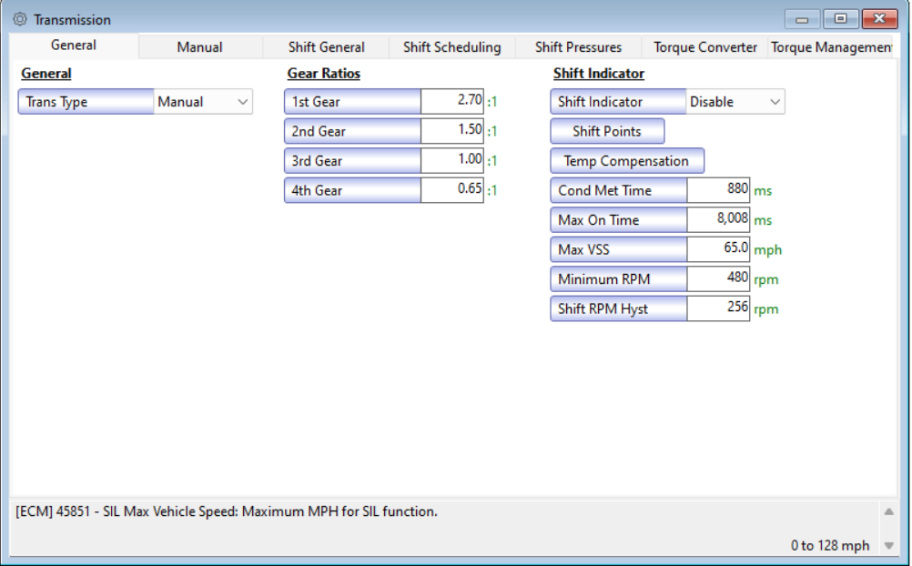

The fundamental issue is that the crank position sensor is set in the bell housing about 180 degrees apart on the autos and the PCM is configured for that, built in with no way to manipulate it to my understanding. In the JTEC+ TJs, the PCM and transmission have to go together or you'd have to machine a mount for the CPS precisely into the bell housing for the Auto position.
It's actually the same problem trying to swap a 05-06 NVG-370 manual into an earlier NV3550 or AX15 TJ. Jeep changed the position of the CPS in the last 2 years of production.

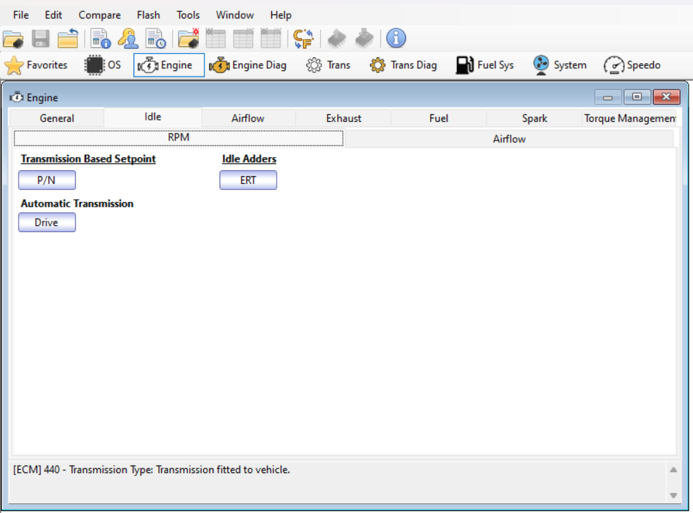

The 99-04 JTEC+ PCM doesn't really have an auto module within it. It doesn't control the automatic. That control is on/within the transmission as I understand it. There are certain auto transmission components within the JTEC+ file even when you are a manual (as I am). All the gear ratios here are for the auto 42RLE and there is a torque converter table.
And in engine controls there are idle controls based on the auto, even though I'm a manual.
