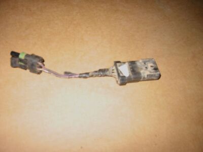

* There is one more little step that we can’t forget to overlook. Look at the wiring harness where the AX15 once was. Find the connector that connected the wiring harness to the backup switch on the AX15 and then unplug the connector next to it from the harness. This connector does 2 things. First it completes the circuit for the backup lights. Second it is the manual transmission neutral safety jumper. We need to completely remove this from the TJ for good. It provides a ground and bypasses the neutral safety switch. Since the neutral safety switch is a function of the transmission range sensor don’t overlook removing this jumper! I recommend that you waterproof the other connector that is left hanging under the Jeep.

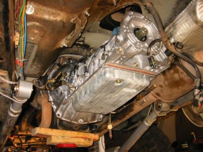

It should now look something like this:
Now you will want to bolt up the transfer case. Once that is complete you need to fabricate a plate for the tranny mount.

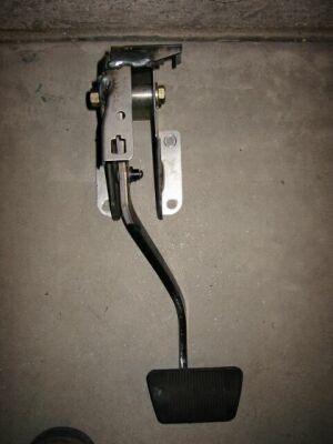

At this point we need to look at the shifter assembly and brake pedals. I started with removing the brake and clutch pedals. Boy this was a real pain! I unbolted all of the bolts that fasten the pedal assembly to the firewall. Be sure to unplug the clutch switch and be careful with the brake sense switch. From under the hood pull the master cylinder and clutch cylinders back. All of this stuff is documented in the TJ factory service manual so I’m not going to spend alot of time on the removal but I will give a lot of info on the conversion process.
Here is a picture of the pedal assembly removed from my TJ. You can see the auto pedal that we are going to install.
Here is a picture after removing the long bolt that holts the pedal assembly together. It was interesting to find out that the pedal assembly was modular. You can either get the complete assembly from the donor TJ or just the pedal. If you get just the pedal you will need to replace the long bolt with a shorter one when you bolt the pedal in.
Here is a picture of the reassembled pedal.

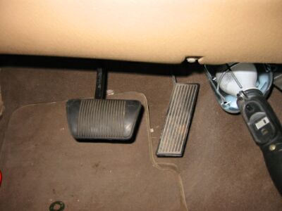

And here is the finished product. You may find that the pedal does not contact the switch when the install is done causing the brake lights to stay lit. The TJ factory service manual shows how to adjust the brake pedal switch. I recommend that you look this up.
* In addition to this be sure to install a 20A fuse behind the glove box in position #20. This is the clutch interlock ignition bypass. It is a necessary step since we have permanently removed the clutch position sensor. Failure to do so will result in the Jeep not starting!

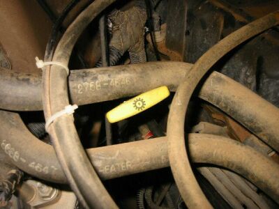

I chose to go with a remote cooler due to the high temperatures we experience in Arizona. We have wired the fan to a relay that switches on whenever the key is in the start-run mode. You may chose to have a manual or thermostatically controlled switch. It’s entirely up to you and your needs.
Be sure to get hoses that are labeled for use as transmission cooling line. Other rubber hoses cannot handle the high temperatures that they see. I used 1/4 NPT barbed fittings and 5/8″ hose clamps.
Where you mount it is your choice. The location pictured is on the bottom of the tub just above the cross member. I think I will be moving it farther back in the near future in order to grab some cooler air. (Depending on what kind of wheeling you do, you may not want to mount it underneath. Efficiency is lost if it gets covered in mud.) Like I said earlier, this is entirely up to you.

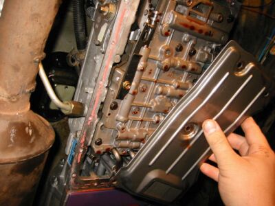

  • Change the tranny filter
  • Reinstall the oil pan

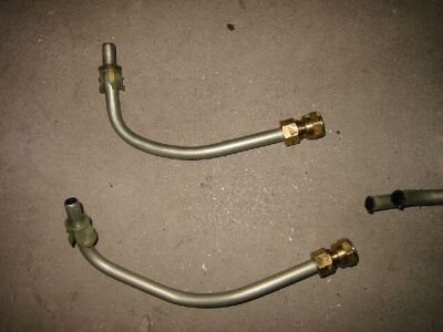

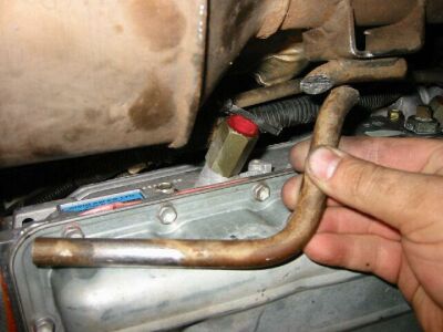

  • Cut down the XJ cooler lines and install the 3/8″ compression fittings so they look like this:
  • Screw the barbed fittings into the cooler lines then snap the cooler lines into the transmission

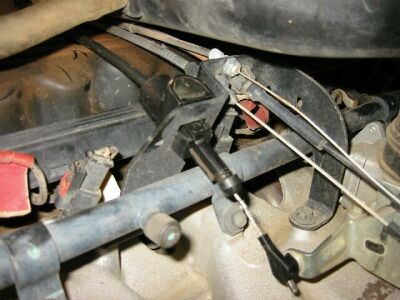

  • Remove the throttle body return spring and snap in the kick down cable that is attached to the AW4. It will look like this:
