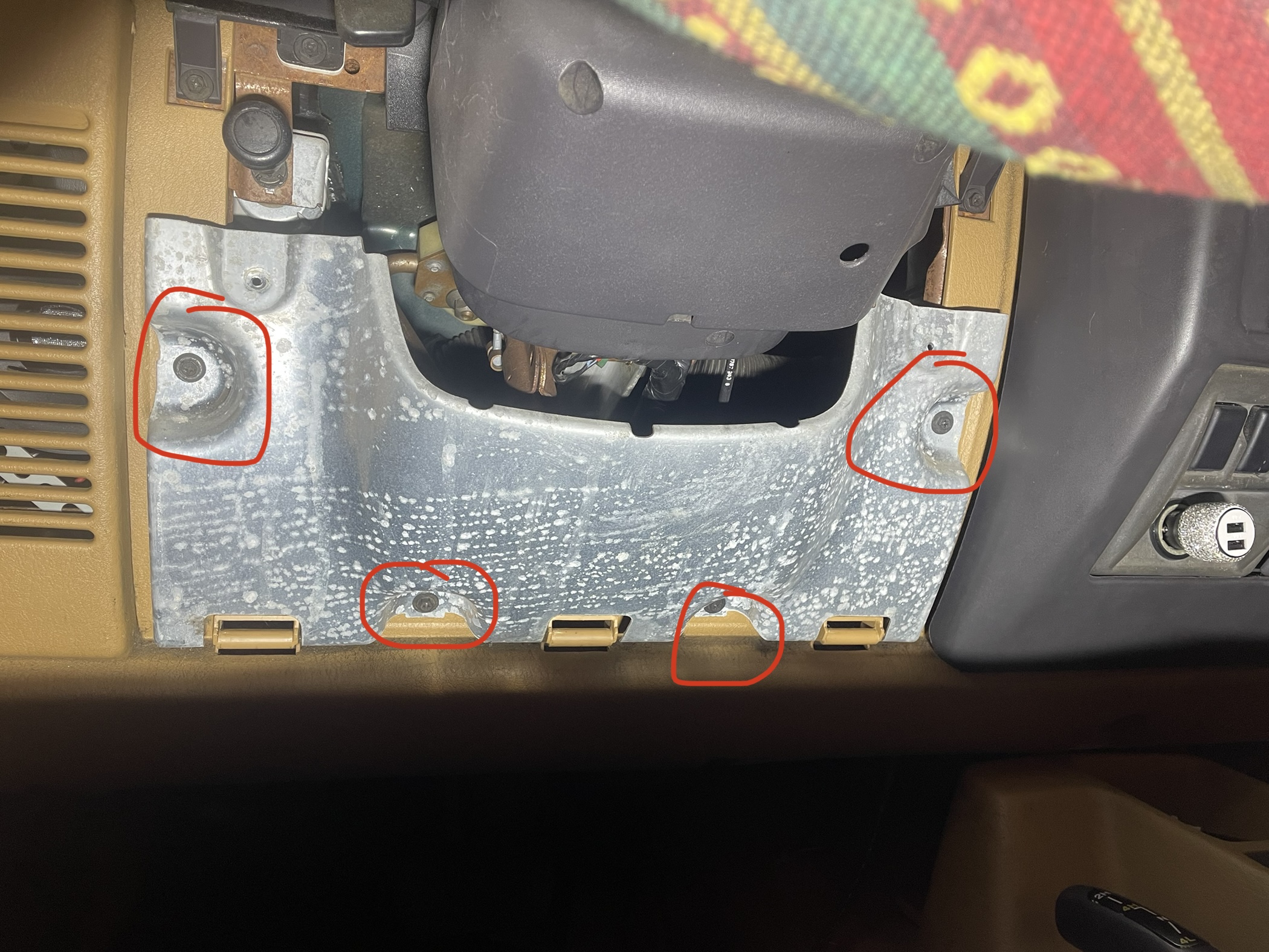

2. Remove the 2 phillips head screws on the knee panel under the steering wheel, and set the panel aside.
3. Remove the 4 phillips head screws on the metal panel mounted behind the knee panel, and set the panel aside.

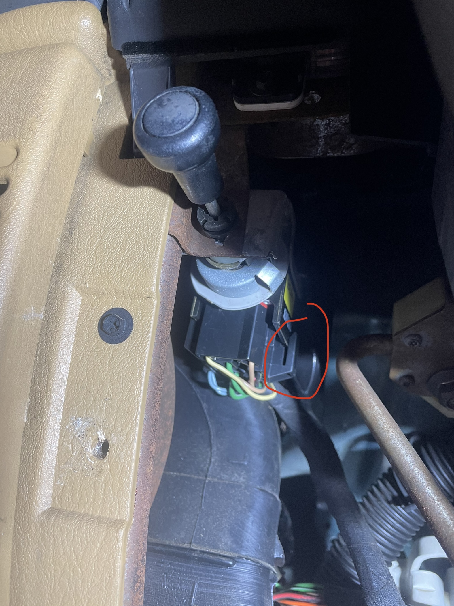

6. Unplug the connector from the bottom side of the switch. There is a tab on either side that need to be pulled away to allow the connector to unseat from the switch. The one on the right is easy to get at, but the one at the left is a little harder. I found that using 2 long flat head screwdrivers to open up those tabs worked well. You may also find that the tab on the left is most easily reached from around the speaker, hence step #4 above.
7. Once the tabs are opened up, work the connector free from the switch in a downward motion. There are many spade connectors providing enough friction to make this a little bit hard. I took a small flat head and worked it in the gap and got it started that way. Whatever you do, don't go full-on gorilla man because you really don't want to replace that connector.

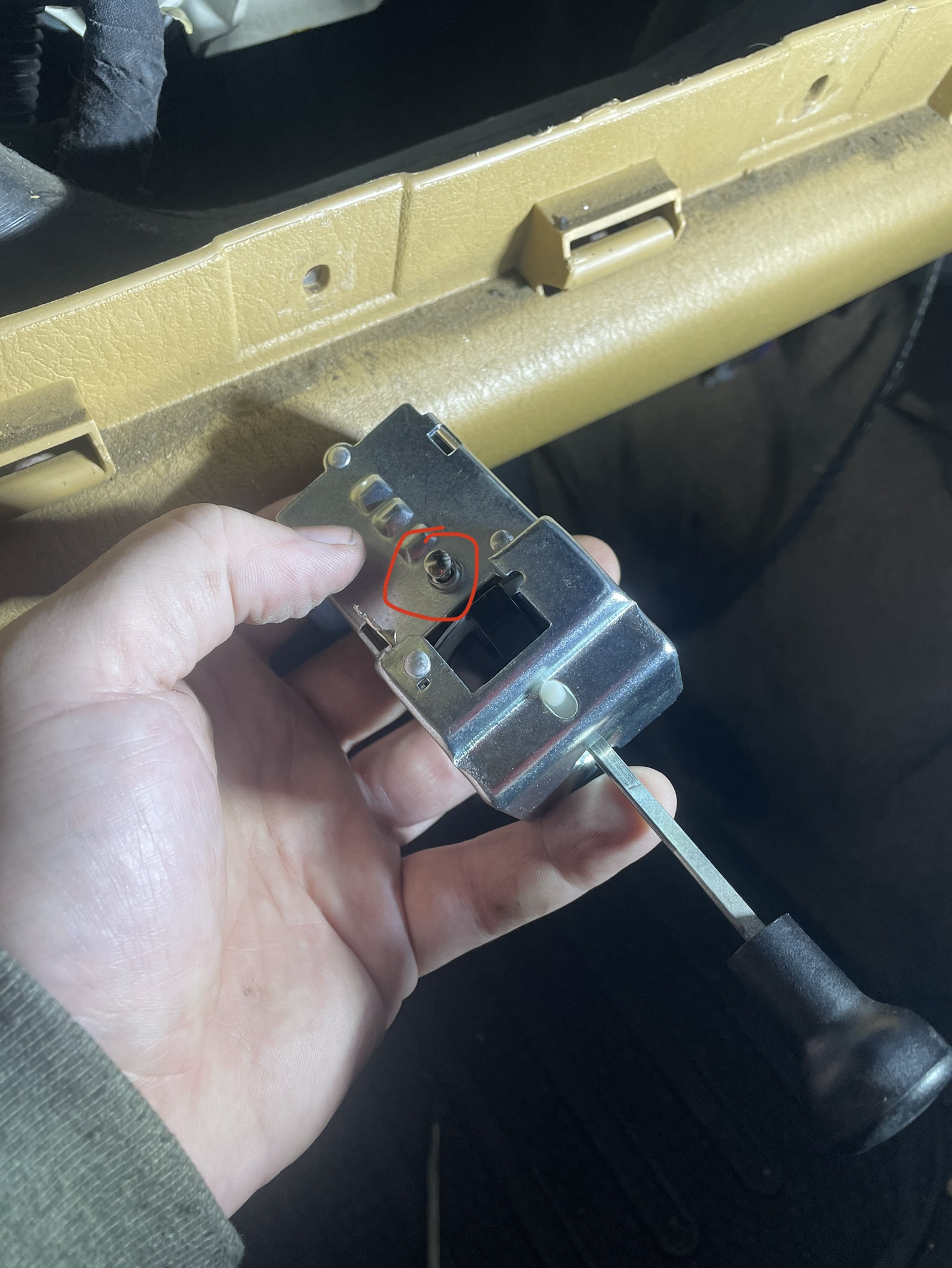

8. The switch itself is held on by a strange sort of screw that threads through a bracket extension on the dash and then on into the front portion of the switch. Unscrew that, and the switch will come right back out.

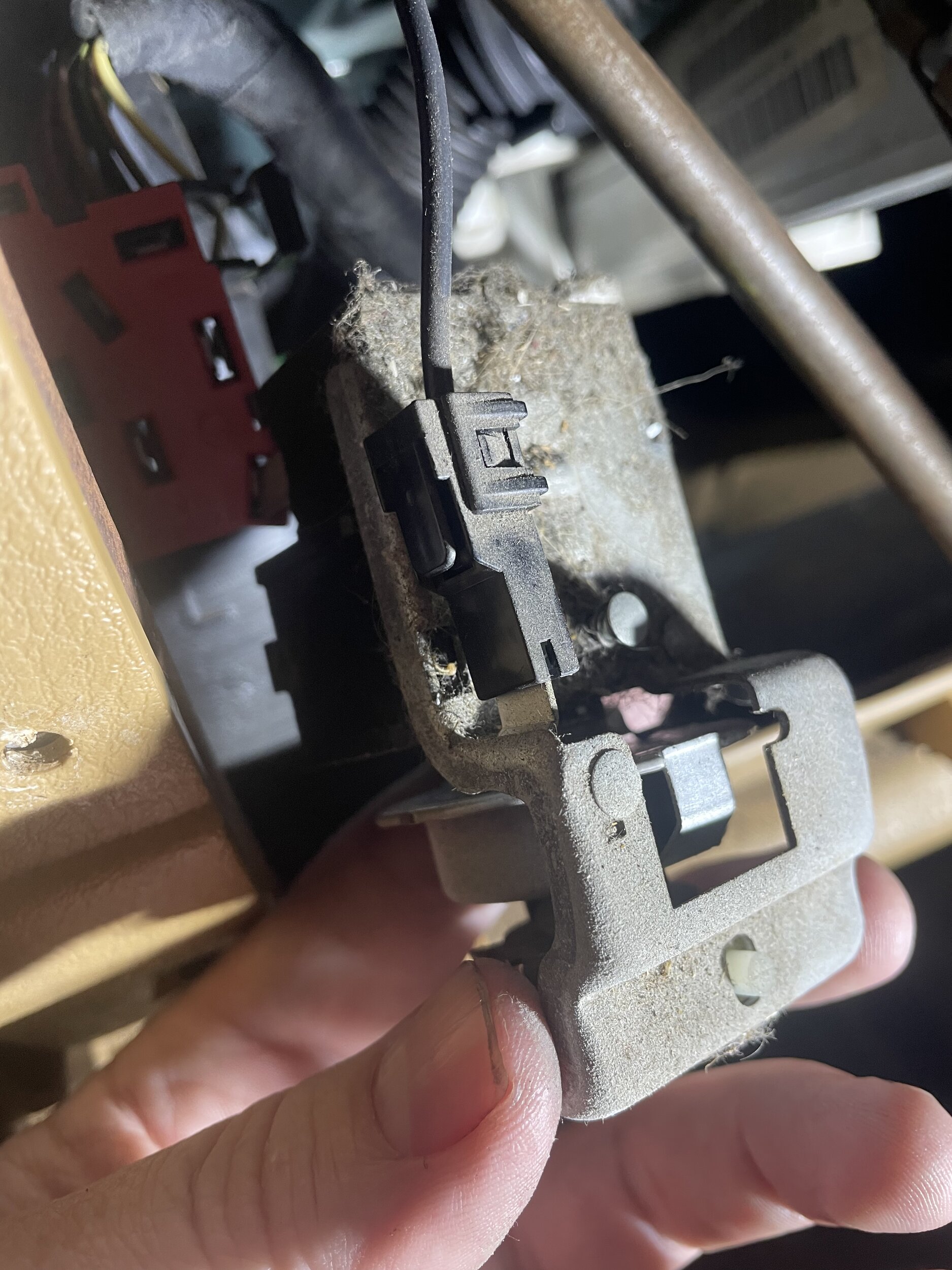

9. Once it's free of the bracket, you'll find one more black wire on top. Squeeze the connector and slide it off.
