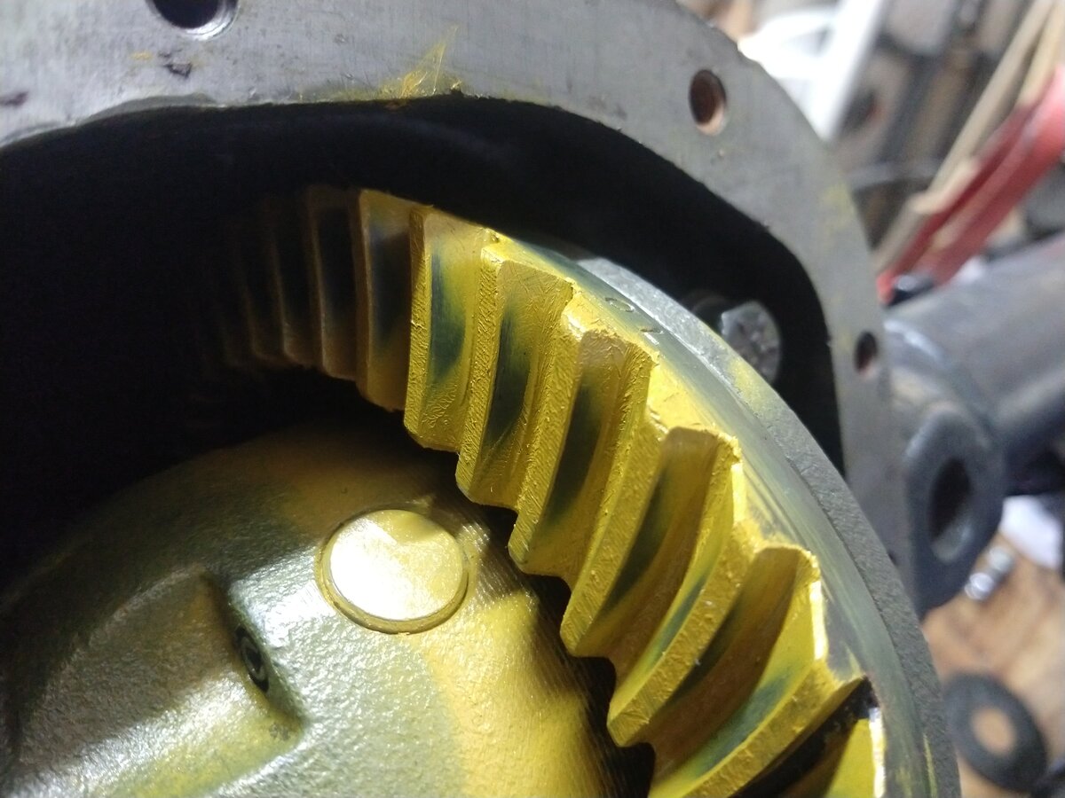

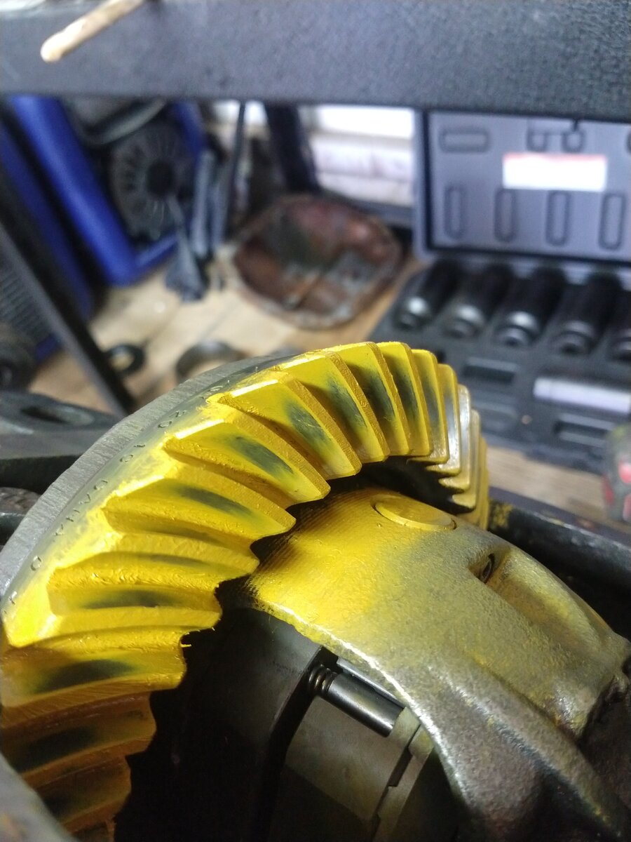

What's wrong with this pattern? Genuine question here just trying to learn about gears.
The sharp cutoff on the top side indicates that the pinion depth isn't quite right. Using what little knowledge I have on gears. Its darn close to being correct though.
