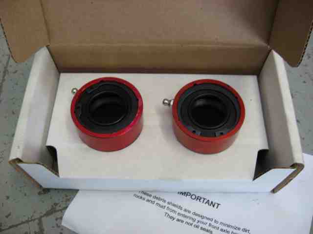

Alloy USA has a solution to the problem, billet aluminum CNC machined axle tube seals. They fit both Dana 44 and Dana 30 TJ axle tubes. Shipped two to a box, a pair of seals and a simple one page instruction sheet give you everything you need (except for a couple of wrenches) to install the seals in the ends of your axle tube.
I spoke with Ron, owner of Alloy USA, and found that the seals I was installing were actually the third generation design. In an attempt to build a better and more reliable product, the seal has been refined over time. From a few photos I've seen, the previous design had a couple of o-rings on the section of the seal that fit into the tube. This version now has a grooved sleeve that fits over the aluminum seal and engages the inner surface of the axle tube. From the looks of it, it should do a good job of ensuring nothing gets past the seal to axle tube interface.
The sealing surface between the seal and the axle shaft is a fairly flexible two lipped rubber seal that provides a sizable pocket that is filled with grease. As seen in the above photo, a standard grease fitting provides easy filling for the inner sealing area. The "seal of grease" also helps ensure the rotating axle shaft does not wear the sealing surface away as well as making a tight seal to keep out debris and moisture.

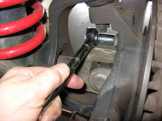

With the tire removed from the driver's side, slide the brake rotor off of the wheel studs. The next item on the list to remove was the brake caliper. The 13mm socket works fine for this. There are two bolts located near the top and bottom of the caliper that must be removed.
If your caliper is stubborn to remove once the two bolts are out, use a small pry bar or a big screwdriver to help coax it off of the rotor.

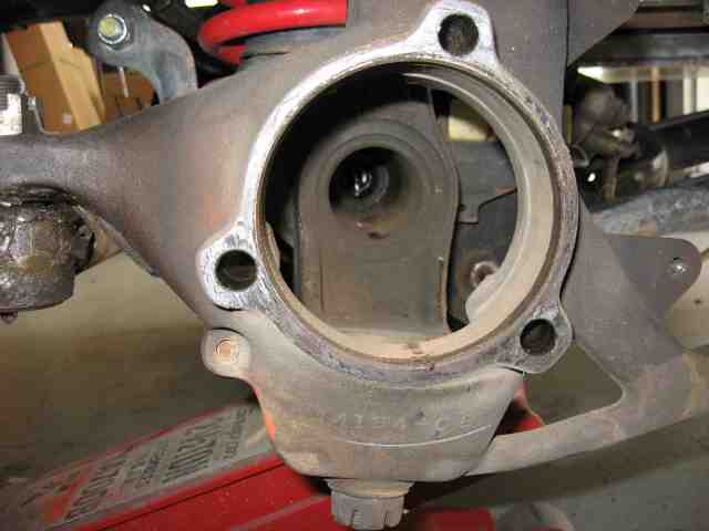

Set the caliper out of the way. Using the twelve point 13mm socket (or wrench), remove the three bolts on the back side of the knuckle that hold the unit bearing (or hub) in place. With the three bolts removed, the unit bearing (or hub) can now be removed. Grasp the rotor and pull straight out and away from the knuckle.
Once the bolts are removed, you may find yourself in a situation where the unit bearing assembly doesn't want to come out of the knuckle. It's not uncommon for the unit bearing to become rusted into the knuckle.

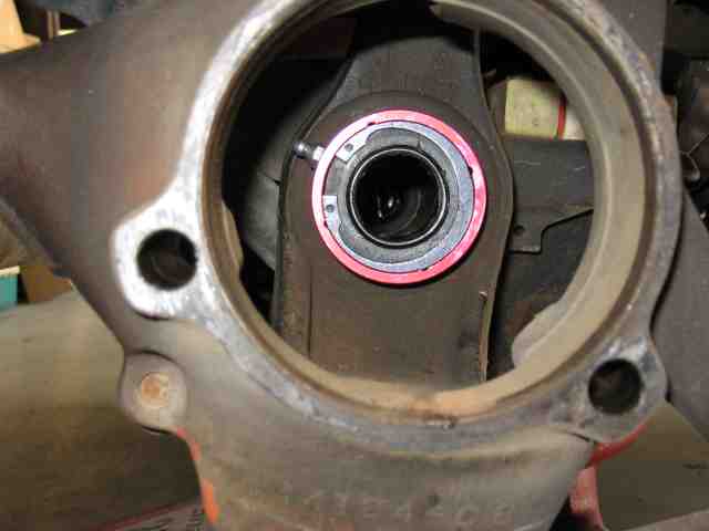

Here is the business end of the steering knuckle with the unit bearing (or hub) removed. Hopefully your axle tube isn't too dirty. I had my front axle apart this past year and when it was, I took the opportunity to clean out the axle tubes. If you have a bunch of debris in yours, you'll need to determine the best method to clean it out. Remember, there is a big hole way down there where your axle shaft goes through the shaft seal and into the differential. You do NOT want to get carried away with an air or water hose. At a minimum, clean the first couple of inches at the axle tube opening as you want to ensure the RTV will adhere well to the axle tube.

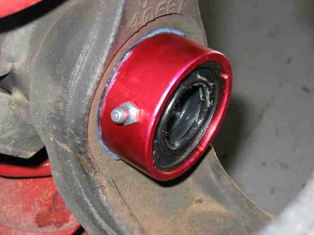

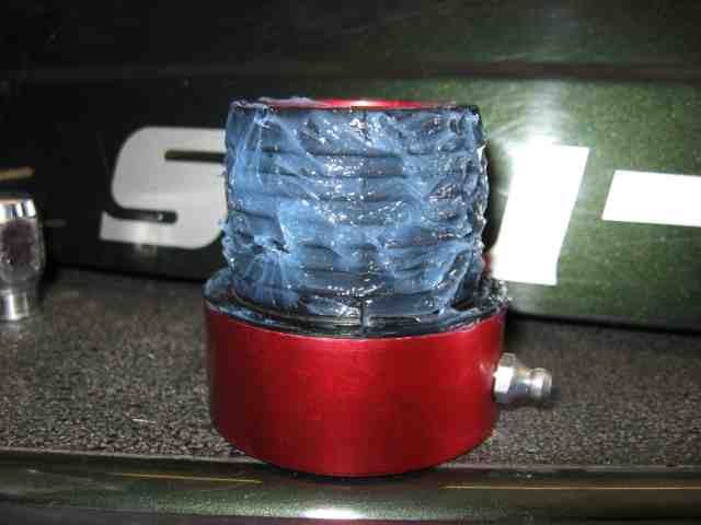

Time to get your fingers sticky with a bit of RTV sealant. I used some blue RTV that was left over from some other project. Apply a film (enough to fill the grooves) over the black sleeve.
I was able to push the seal into the end of the axle tube with just my hand. No reason to beat it into position.
The installation is now complete except for two things:
#1. Let the RTV cure. The tube I used states full cure is reached in 24 hours. You don't want the seal to spin in the end of the tube when you drive away.
Note: If you are using Warn hubs (as am I), you can drive (in less than the cure time) as along as you have the hubs unlocked and you don't use 4WD. Since your axle shafts will not be turning, the RTV will have time to properly set up.
#2. Apply a liberal amount of grease on the black inner sealing surface. This will help the axle shaft slide into position when you reassemble everything. A very fine coating of grease (applied via a rag) on the axle shaft will prevent the ever typical rust that forms on unprotected shafts.
Once the axle shaft is installed, use the grease gun and apply grease to the fitting until resistance is met or you see a small amount seep past the edge of the seal.

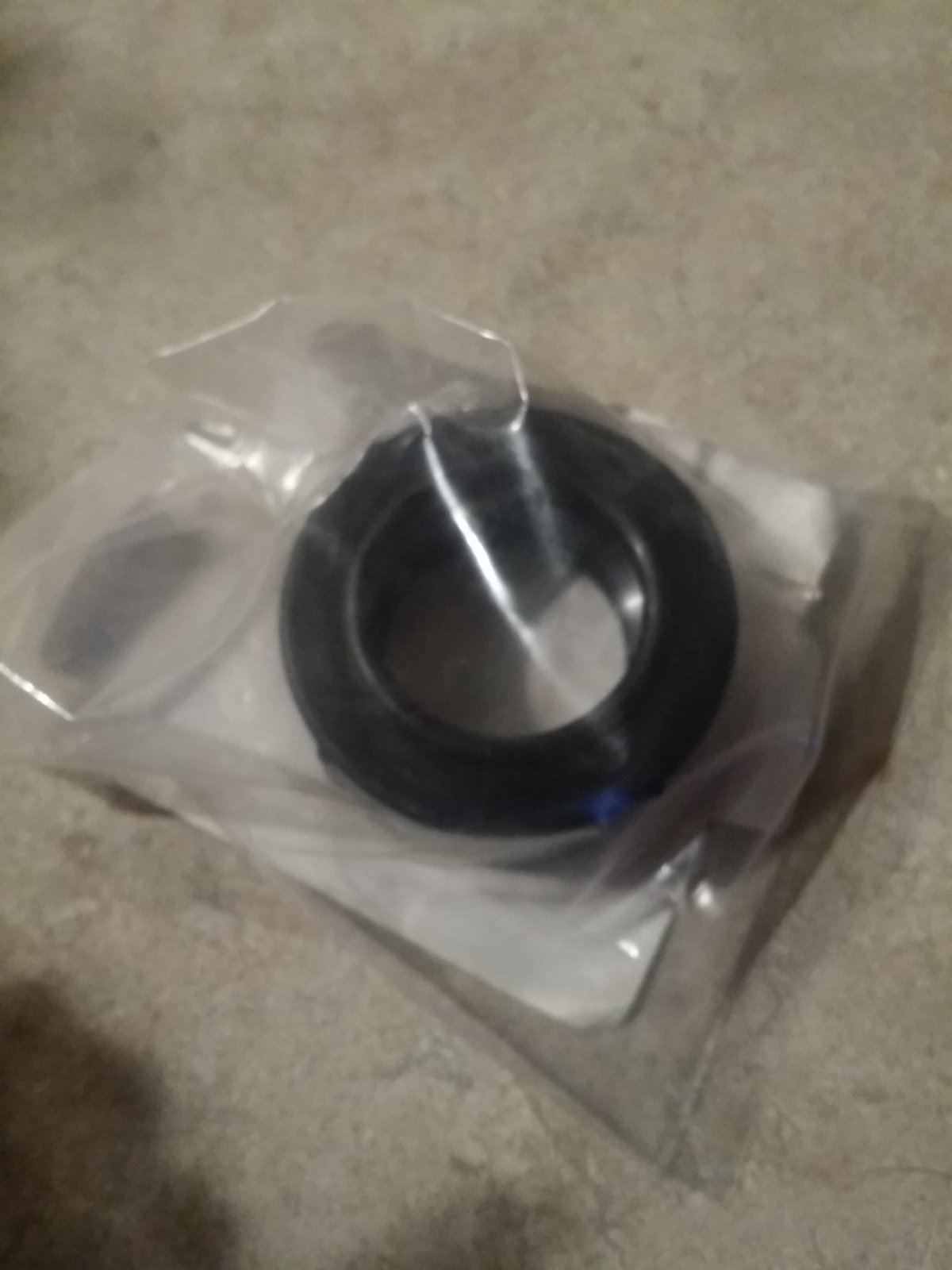

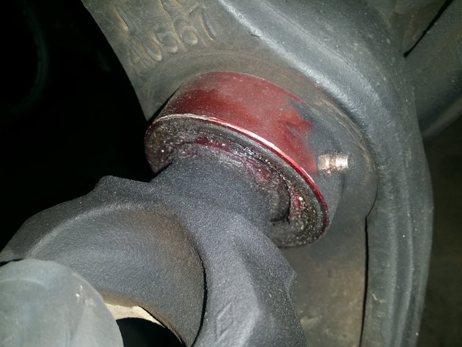

Good read. I had these already installed when I bought the jeep. It wasn't until I did a break job recently that I noticed the rubber seal was torn on both driver and passenger side. I haven't found any videos or tutorials on replacing just the seals themselves but I found replacement seals and just received them today so tomorrow thats what I'll be doing along with changing the diff fluid. The replacement seals are rubber but I'm not sure if I'm supposed to use rtv or not. 20160509_005309.jpg20160509_010827.jpg
Good read. I had these already installed when I bought the jeep. It wasn't until I did a break job recently that I noticed the rubber seal was torn on both driver and passenger side. I haven't found any videos or tutorials on replacing just the seals themselves but I found replacement seals and just received them today so tomorrow thats what I'll be doing along with changing the diff fluid. The replacement seals are rubber but I'm not sure if I'm supposed to use rtv or not. View attachment 4522View attachment 4523[/QUOTRTV will only make it harder to remove when you finally decide to throw them away.:rolleyes:
