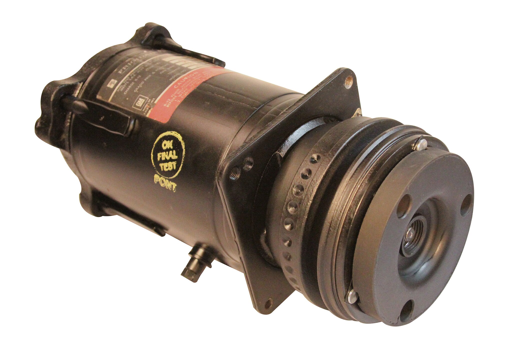

My 69 Camaro 300 h.p. 350 would actually chip the rear tires if you engaged the A/C at 50 m.p.h .
A Frigidaire A - 6 compressor and R -12 could turn that Camaro into a freaking freezer ! If you used max A/C ( recirc. in non GM speak )
at 4000 compressor r.p.m it puts out 42,000 btus. That's 3.5 tons of cooling.
That will cool a average size house.
I've driven my share of cars with those old R12 setups, and you can 100% feel it engage. I can't say that I’ve had it chirp tires, but definitely slow the vehicle.
