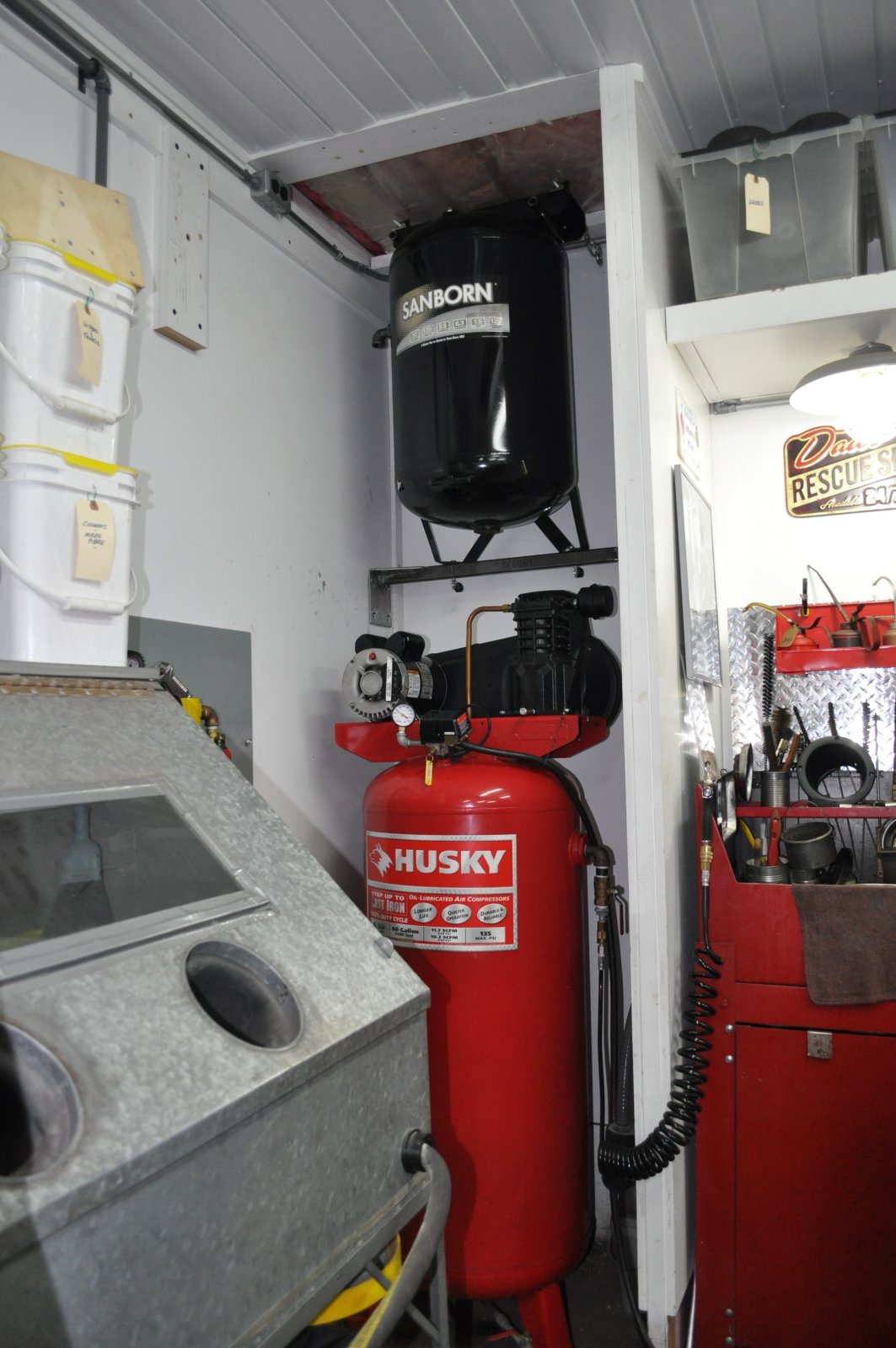

I've had my 60 gal. Husky from Home Depot for 22 yrs. now and it's been good. You're right, the instructions said to take it off the pallet but a lot of guys don't. I mounted mine on isolation blocks lagged to the floor. I also hung a 30 gal tank from the wall and ceiling above it. I usually only fill the second tank when I'm media blasting.
