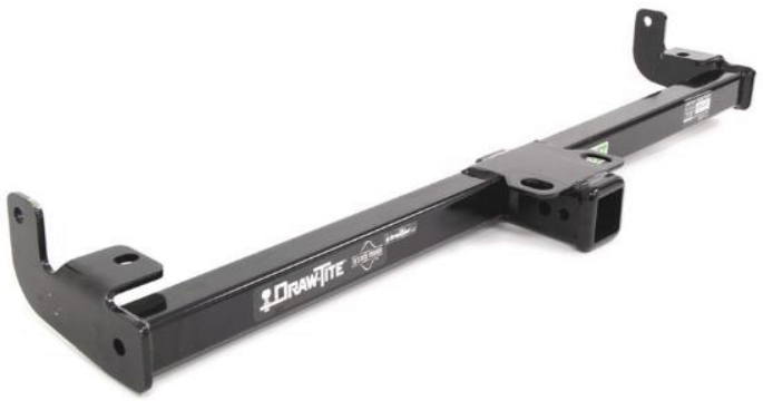

The inner faces of the bracket interfere with the side wall of the skid plate.
Aha. My Draw-Tite has the brackets on the outside of the frame, while your Curt has them inside. Maybe you can find a used Draw-Tite for cheap.
Reactions: Wildman
I have found a few on market place with that style bracket. Im still considering the bumper hitch idea but I do need to move my camper around soon as well.
