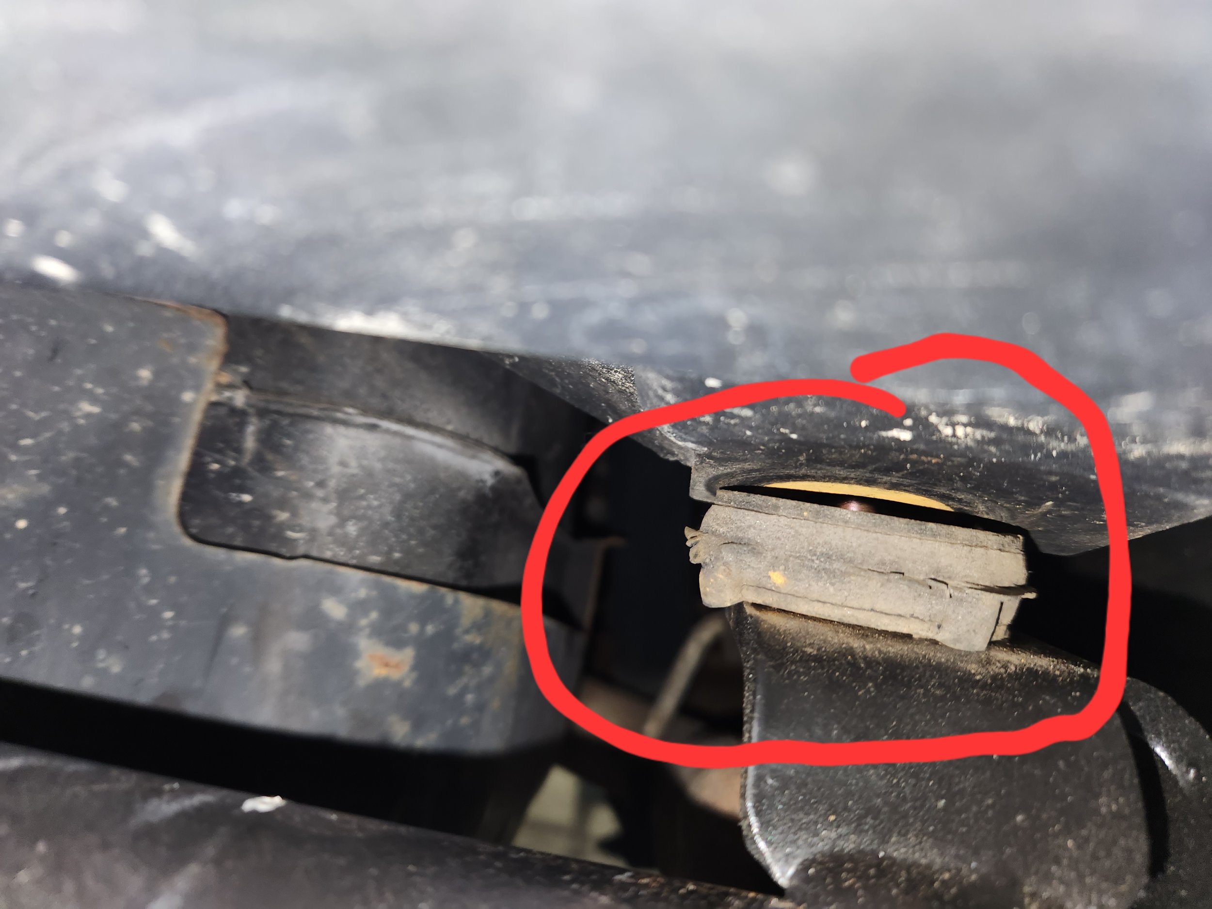

Z Ziondogg Member Original poster Joined May 16, 2025 Messages 70 Location Va Aug 10, 2025 #1 For those of you that have installed a hitch, did you reuse this spacer?
lBasket Branch Manager Supporting Member Ride of the Month Winner Joined Dec 14, 2020 Messages 9,129 Location Florissant, CO Aug 10, 2025 #2 Ziondogg said: For those of you that have installed a hitch, did you reuse this spacer? View attachment 635970 Click to expand... Is that a body mount what is that Reactions: bucky and macleanflood
Z Ziondogg Member Original poster Joined May 16, 2025 Messages 70 Location Va Aug 10, 2025 #3 lBasket said: Is that a body mount what is that Click to expand... I don't know what it is but it is rubber. Just trying to figure out if I should leave it in or bolt it directly to the bumper bracket and frame.
macleanflood I break sh!t Supporting Member Ride of the Month Winner Joined Jul 24, 2021 Messages 9,657 Location Fall Creek, OR Aug 10, 2025 #4 That's what isolates your tub from the vibration of the engine and drivetrain. -Mac
Z Ziondogg Member Original poster Joined May 16, 2025 Messages 70 Location Va Aug 10, 2025 #5 macleanflood said: That's what isolates your tub from the vibration of the engine and drivetrain. -Mac Click to expand... I don't think it's a body mount.
bucky E CLAMPUS VITUS Supporting Member Joined Dec 25, 2020 Messages 2,366 Location SoCal/North Dakota/ N Az Aug 10, 2025 #6 I would not attach any type of hitch to something with rubber involved in the connection. A trailer hitch must be securely attached to the frame not sheet metal.
JMT The Silver Fox 🦊 Supporting Member Ride of the Month Winner Joined Feb 27, 2017 Messages 26,420 Location 🌎 Aug 10, 2025 #7 Ziondogg said: For those of you that have installed a hitch, did you reuse this spacer? View attachment 635970 Click to expand... That rubber mount shouldn’t go anywhere. A receiver hitch should bolt to the bottom and side of the frame on both sides. Reactions: Cossa
