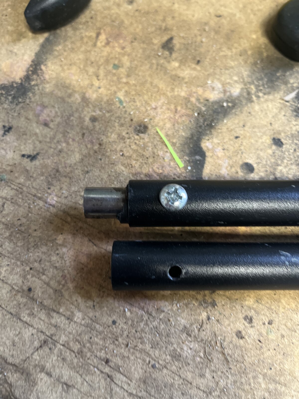

Any way to get a replacement for this arm other than calling bestop? Or any homemade fixes…

You need the header, the arm is fine. Take the phillips screw out, detach the arm, and you can epoxy the post back in the header. Put the arm back on after the epoxy hardens and it will work for a little but, but it won't last forever.
That’s what I was thinking
