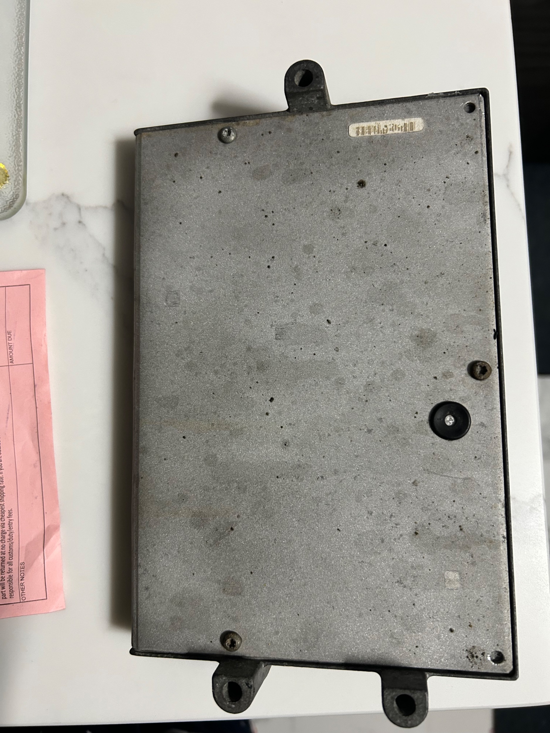

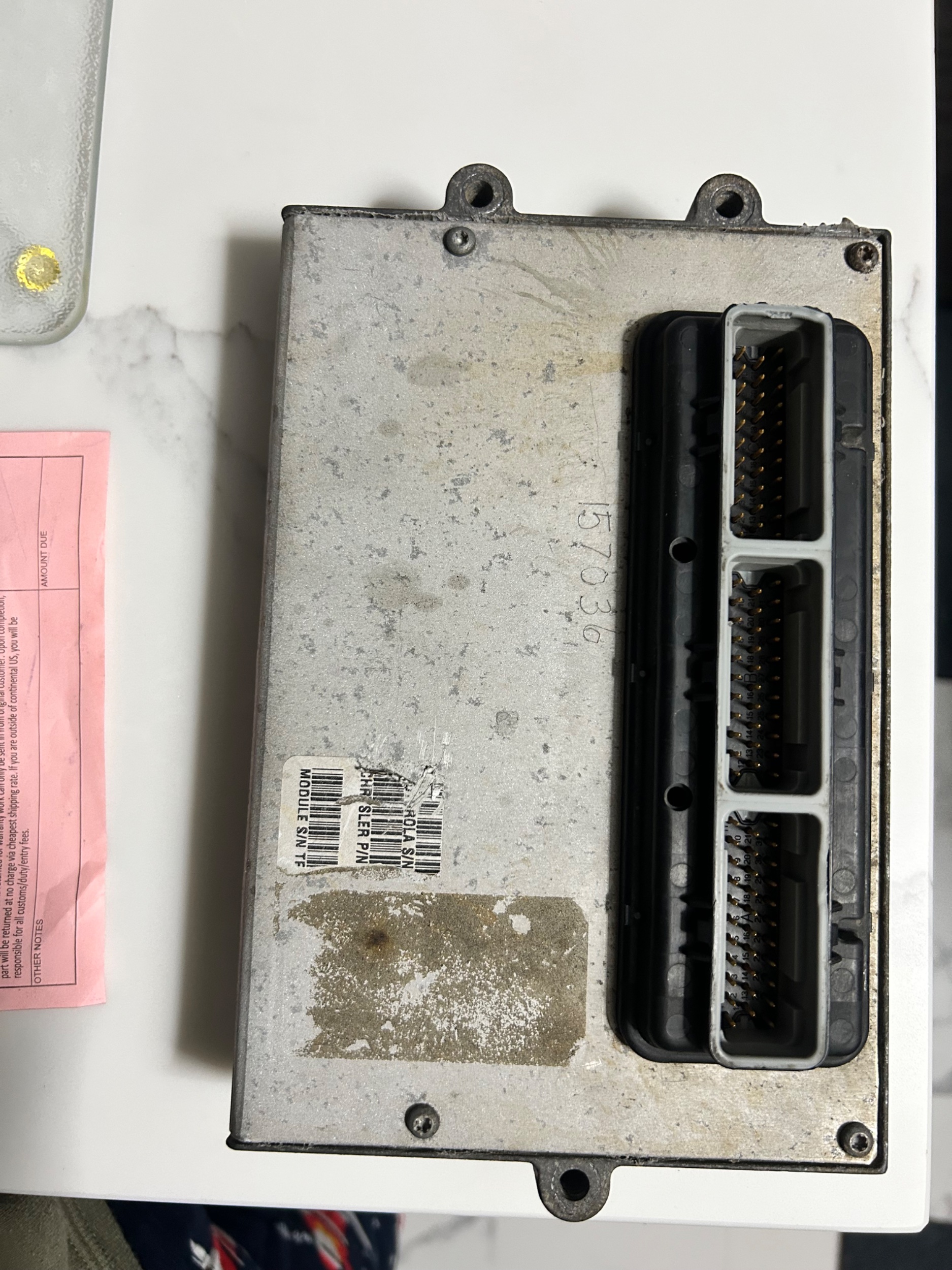

Long story short my 97 wranglers ecu died on me. I sent it out to SIA Electronics to have it rebuilt. They told me the cpu shorted and it’s beyond repair.
I then tried to search my vin number to help find my ecu but found my car had been stolen many times and was probably vin swapped. Supposedly I have a 4 cylinder manual, but I can confirm it’s a 6 cylinder automatic lol.
Side notes:
I have no original stickers on the Ecm
“157036” was scratched in by SIA for them
My vin number doesn’t match my drivetrain and unfortunately I have no old records for the vehicle
I asked SIA if they could help me

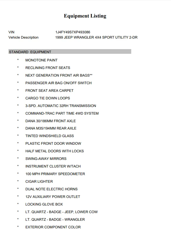

identify it and they gave me “1J4FY49S7XP493086.” I googled it and honestly don’t know what it means or goes to
I’ll attach photos but if anyone knows anyone I could reach out to / how to identify my ecu any help is appreciated. I’m all but stumped. Thanks in advance

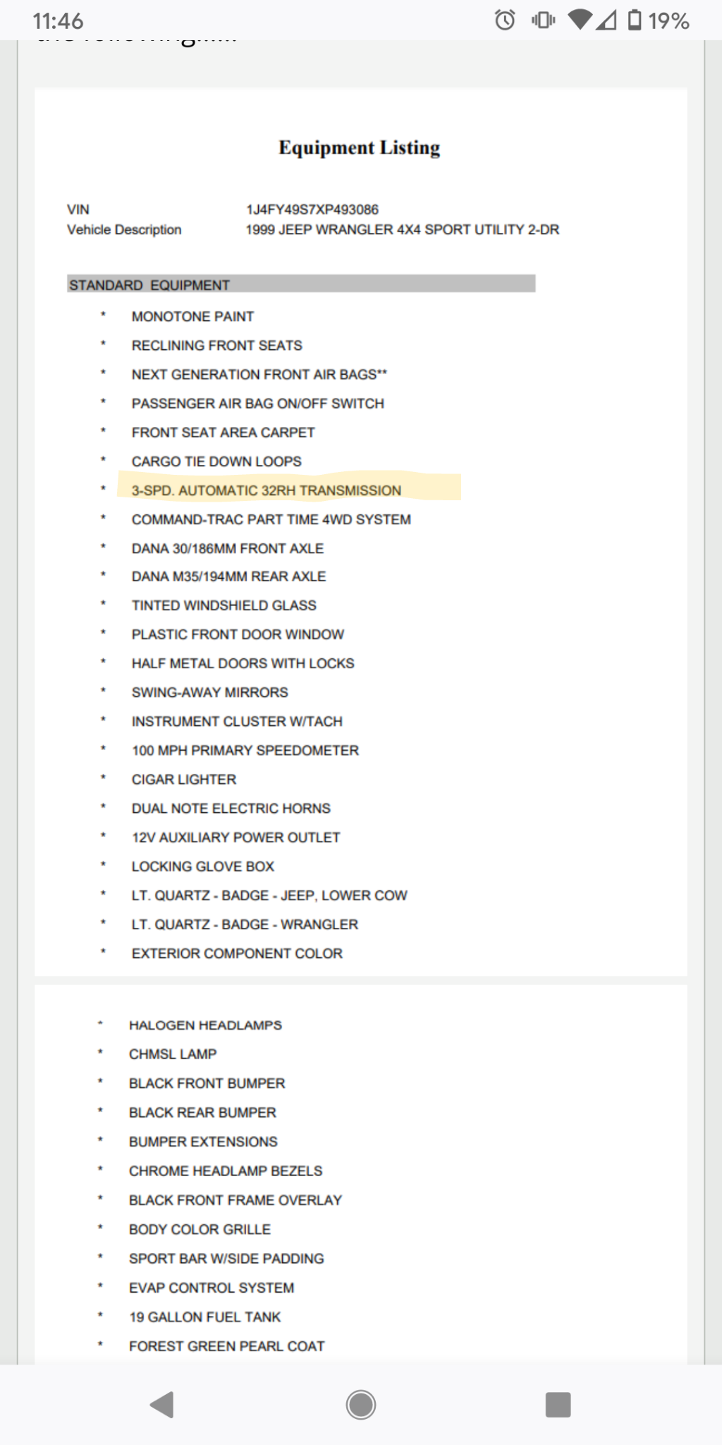

This probably was the VIN that was in the PCM. If we look this up on the FCA Jeep VIN Decoder, we get the following......
