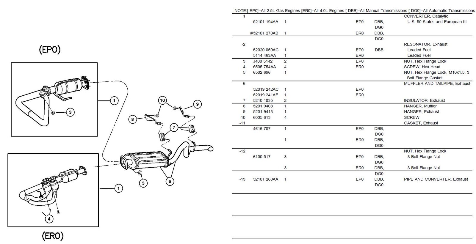

Help determining correct part for 2002 2.5 (header to cat down pipe)
TJistheway
Mar 28, 2023
11
Knoxville, TN
I have a 2002 SE model and need help verifying which down tube will fit my rig because I am replacing everything including headers, downtube, cat, and cat back. I have extensively read on here and plan to refurbish a cast mopar manifold for the headers and ceramic coat or similar. Cat back systems and universal or fitted catalytic converter choices are abundant so no issue there.
The problem I am running into is that my manifold bolts up to a single downtube and the cat is under the jeep in front of the transmission skid. I do not have the double pipe with dual cats in the vertical position that every parts website seems to think I should. I don't know the reason for this because I have owned the jeep since 2009 and the manifold is definitely stock.
Can anyone offer any insight on why parts websites show the dual cat for a 2002 SE and confirm if that is incorrect? Looking at photos and having spent quite a bit of time under the jeep recently, I think that I just need to order parts for a 1998 TJ SE exhaust such as the one linked below.
https://www.extremeterrain.com/crown-automotive-header-pipe-w-catalytic-converter-9700-25l-tj.html
Also, I know aluminized steel exhausts are crap and rust out fast. My plan is to go stainless where I can and use Eastwood's line of high temp exhaust coatings inside and out on the parts that I can only get aluminized (or maybe all the parts). Thoughts on that?
Thanks guys, this site has been a huge help and I appreciate all of you!
The 2002 2.5 does not have dual cats, those who claim it does are thinking of the 4.0 engine. This is from the Mopar parts guide for a 2002 TJ which includes the catalytic converter, p/n 52101194AA. Top p/n as below, yours is the EPO version which is for the 2.5.
