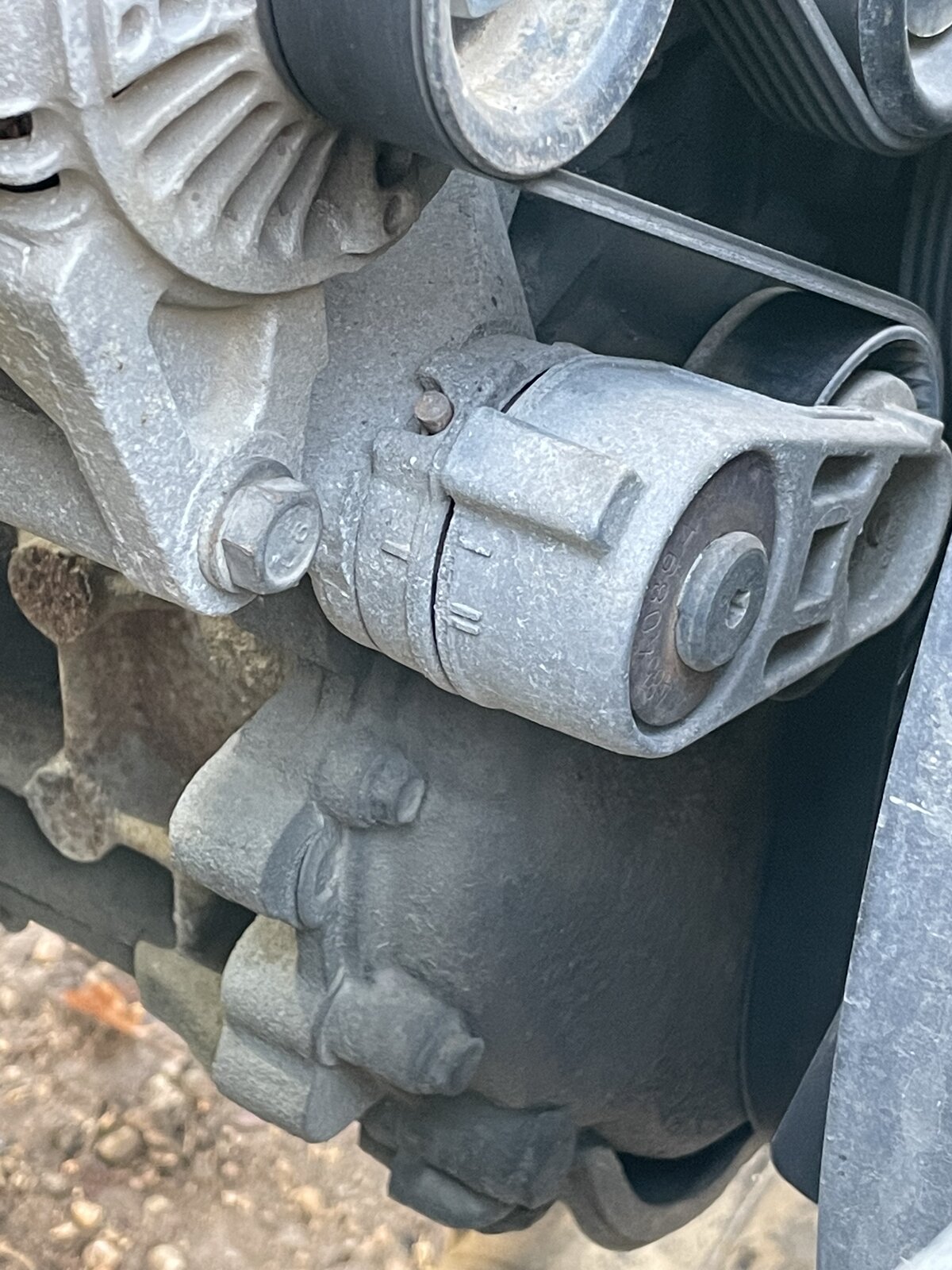

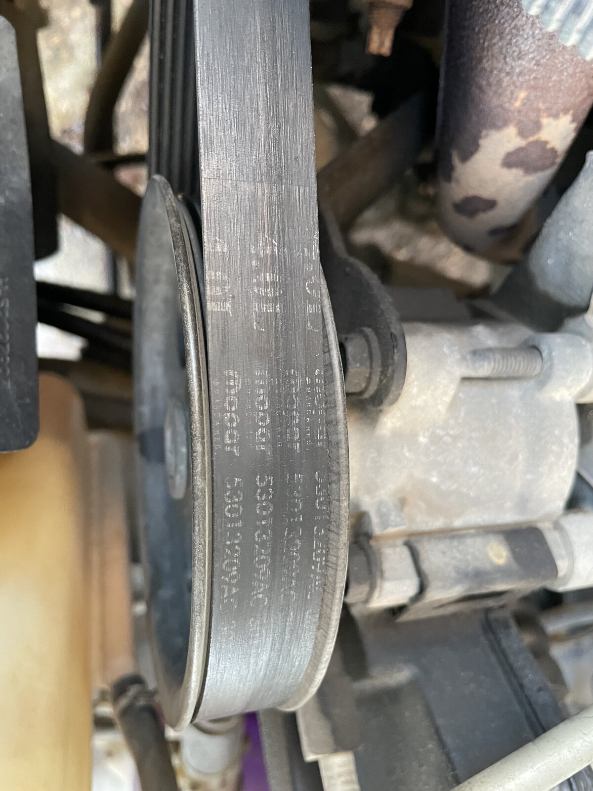

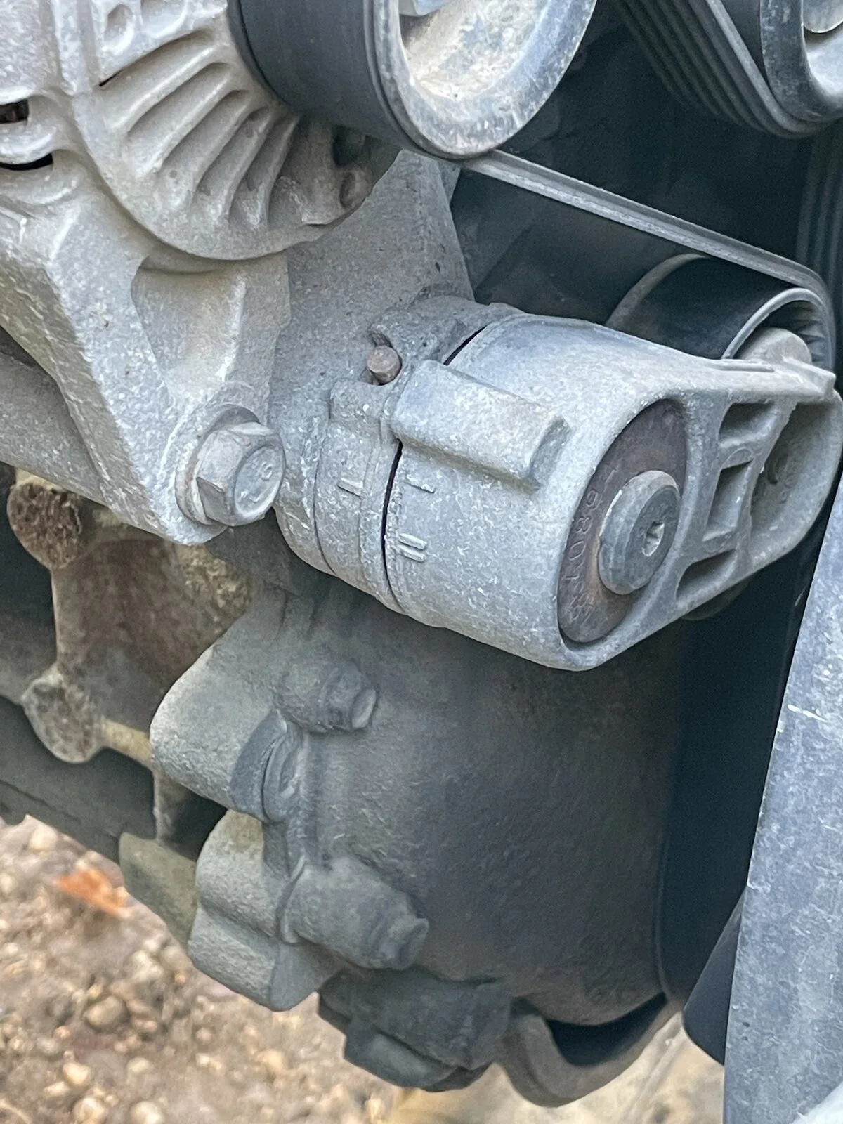

(worn drive belt? my belt doesn’t look to be in too bad of shape but it also looks original to me)
How reliable are the tensioner indicator marks?

I meant yes, you can still run your fan.
I‘m not sure on the accuracy of the tensioner marks.
