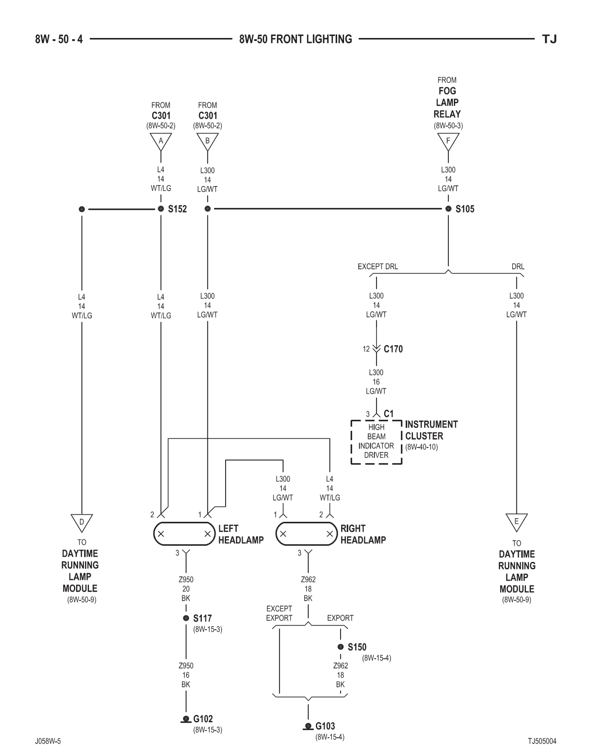

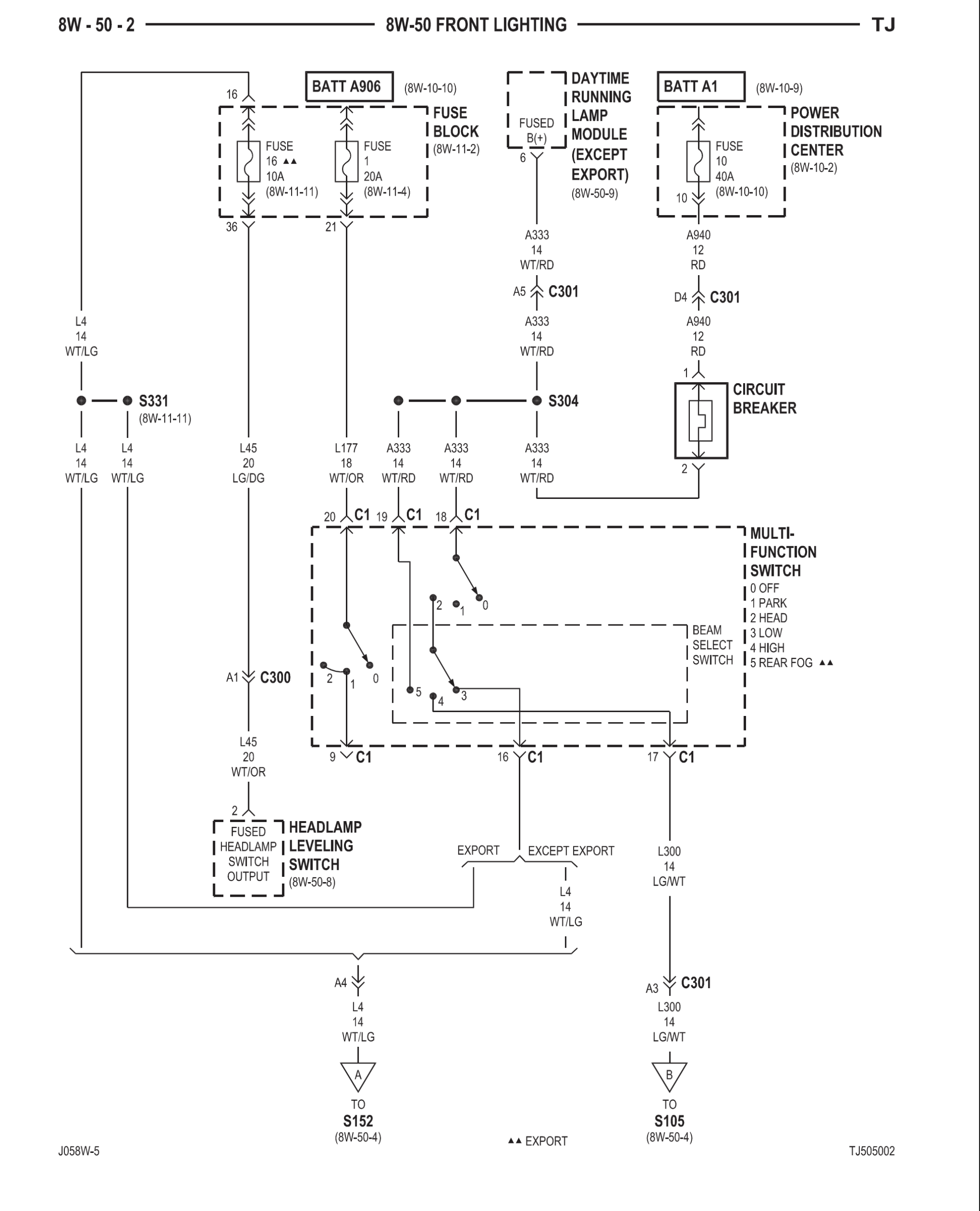

Hope these wiring schematics assist you in troubleshooting your problem.
I appreciate it. I will let my buddy look at those. Im not that good with electrical. The headlight relay looked good. I swapped with another one too and it didnt fix it. I am gonna feel like a real idiot if wires touching at headlight caused this. Im already in it a few 100 🤦
