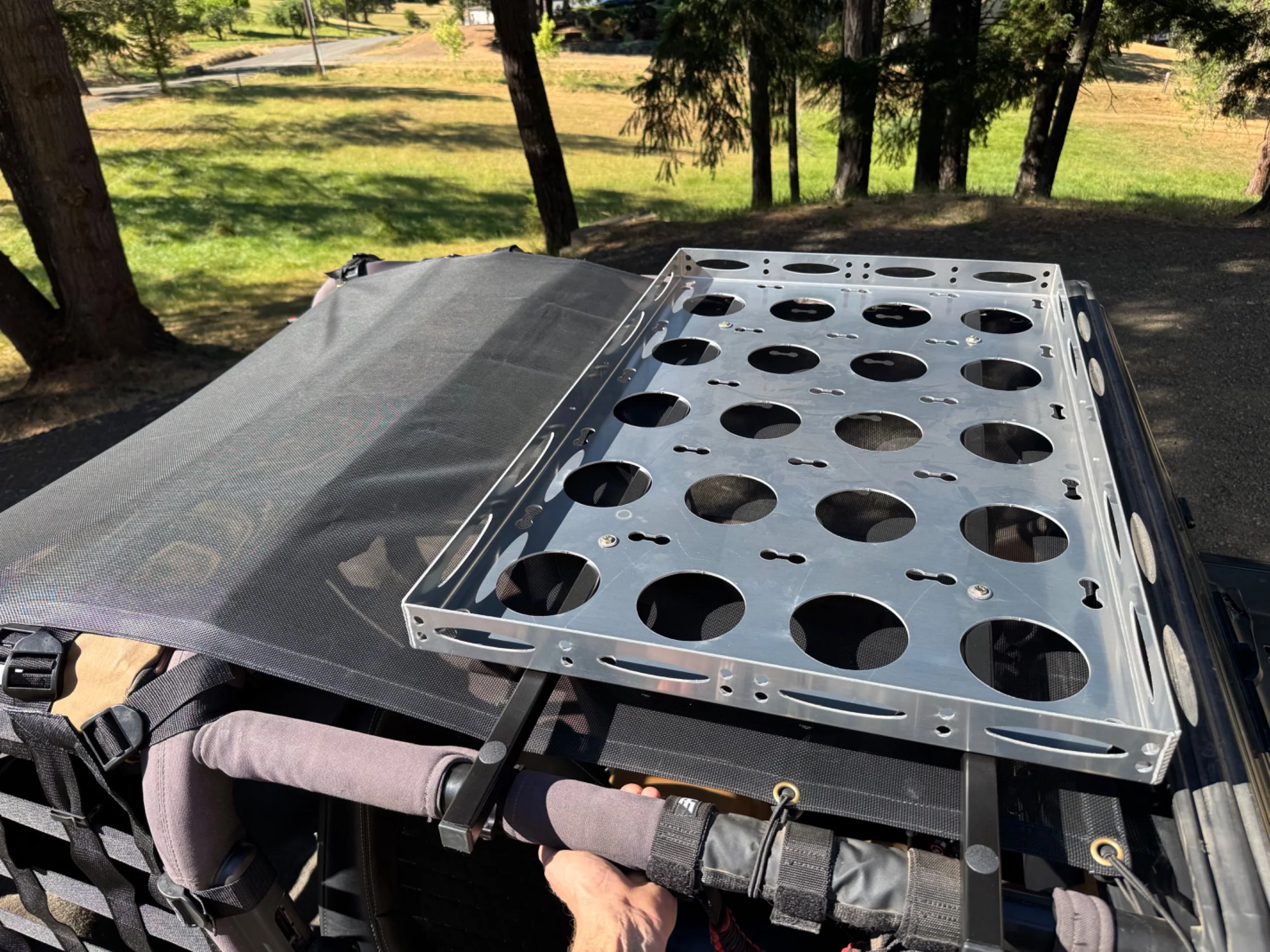

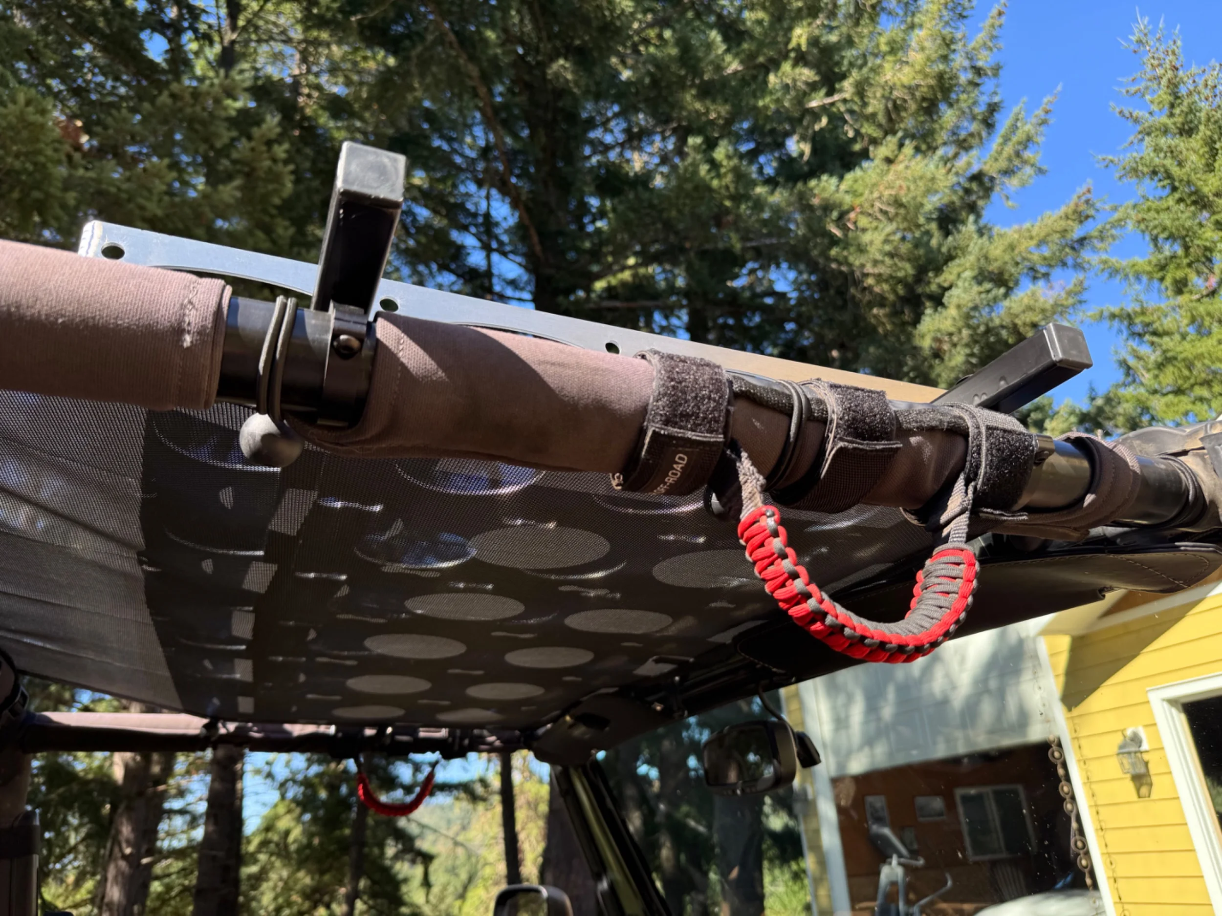

But I just returned from running the Rubicon with a rack held onto those two bars exclusively. I used bar clamps from Summit (2 on each side), 1” square tubes (2) and a Genright aluminum tray:
https://wranglertjforum.com/attachments/img_9795-jpeg.628259/
https://wranglertjforum.com/attachments/img_9796-jpeg.628267/

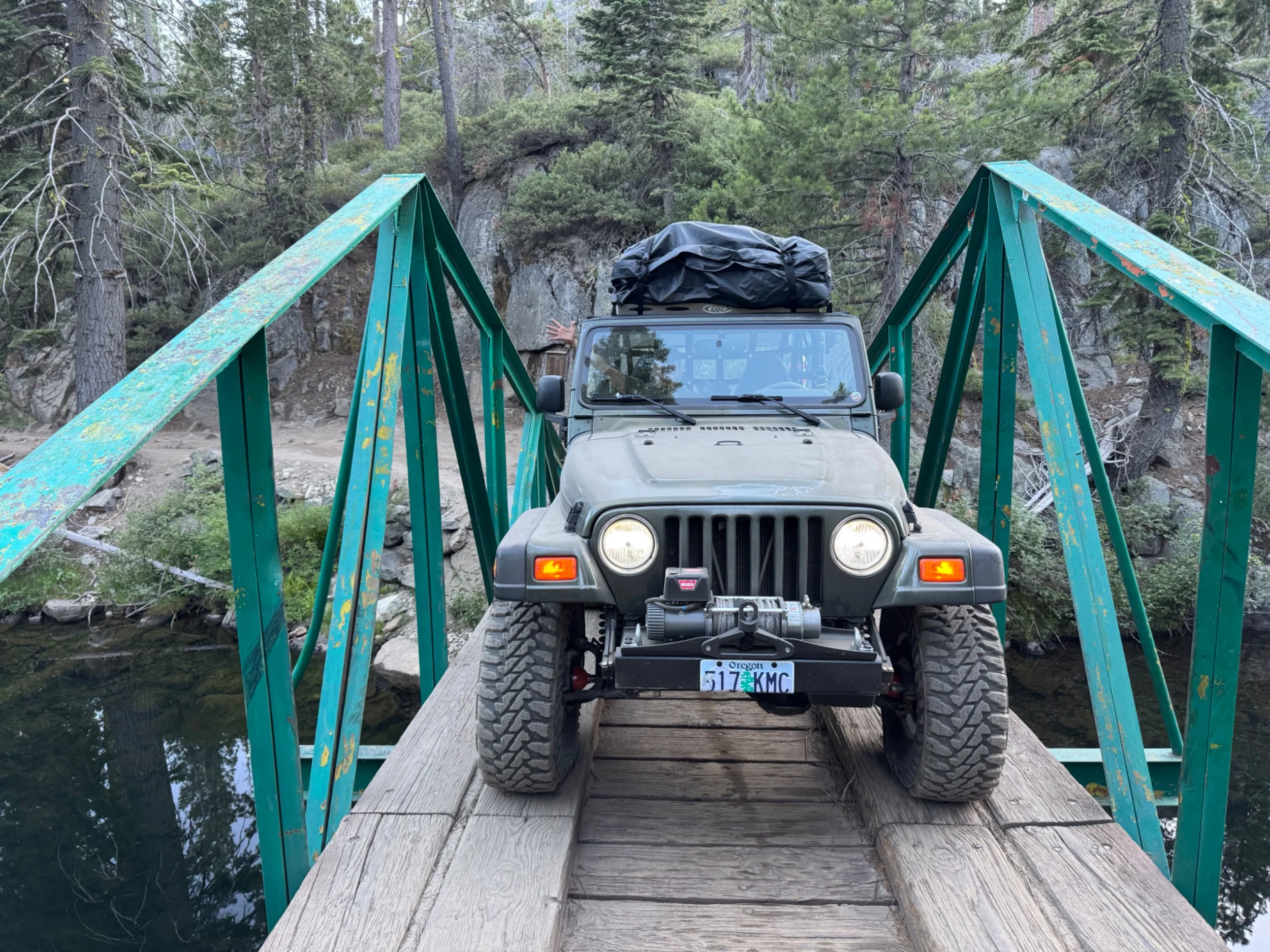

And here it is loaded up on the trail.
Inside the Jeep was myself, my wife and our 2 dogs so everything had to go on top. I’d say there was about 150# up there. No issues.
