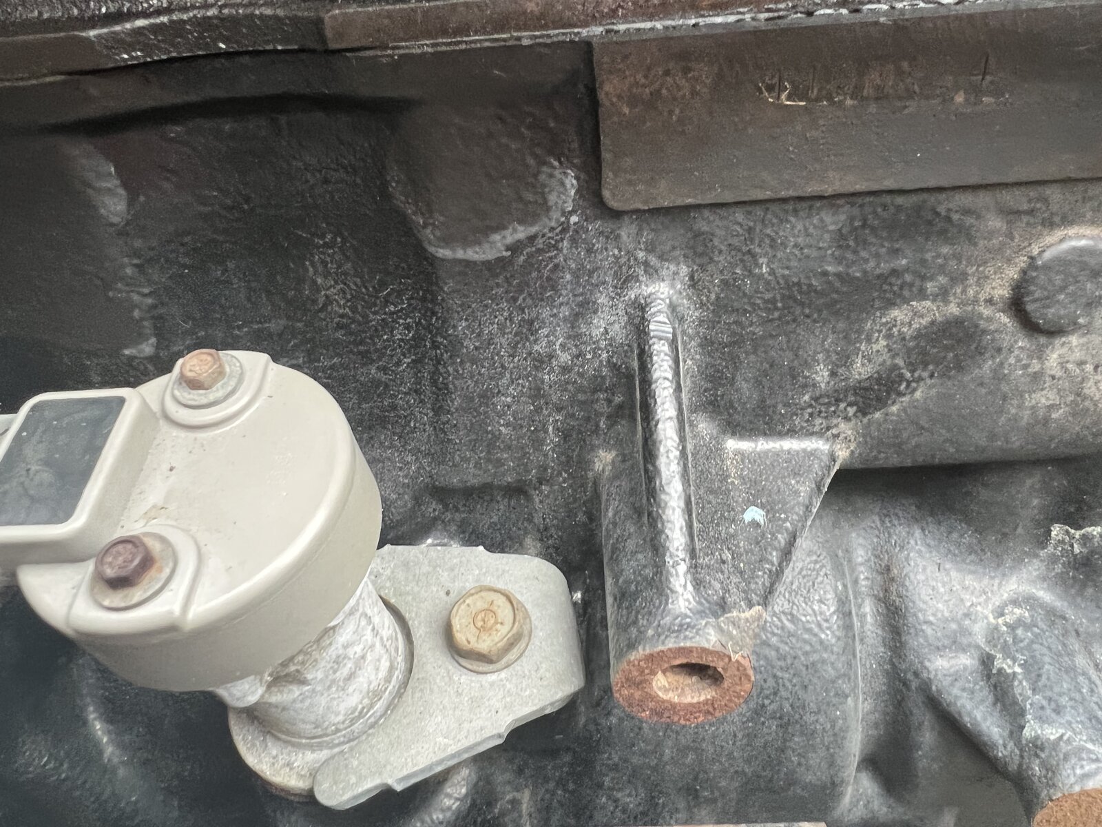

Been smelling that hot engine smell, figured the valve cover gasket was leaking. Well i just seen today on the parting line of the head and block, above the oil filter, a little oil seepage? Whats the next steps?

I suppose a compression test or leak down test would be the right thing to do.
But I'd throw a Felpro head gasket kit at it and some copper gasket spray and see if it sticks.

So not an IMMEDIATE issue. Cool. I was not looking forward to pulling the head this weekend. No oil in coolant or vice versa. Ill keep an eye on it. I have a 2000 so i would rather wait to get a tuppy head before doing it.
I’d give it a good cleaning and keep and eye on it, especially since if no oil in the coolant etc.
