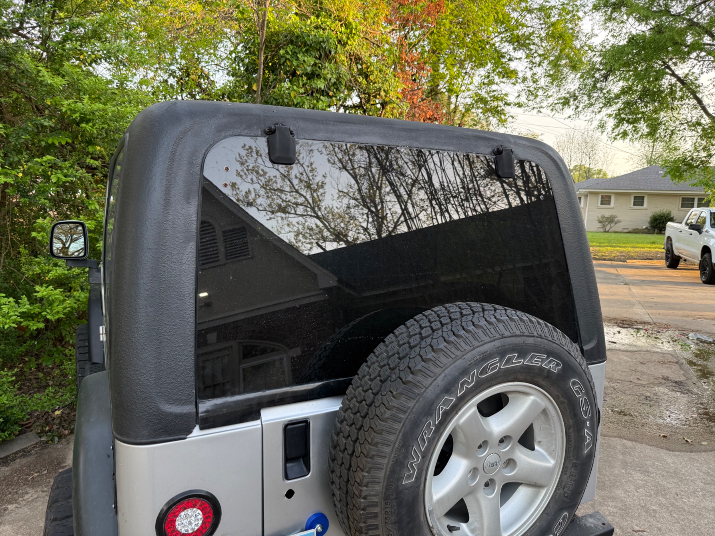

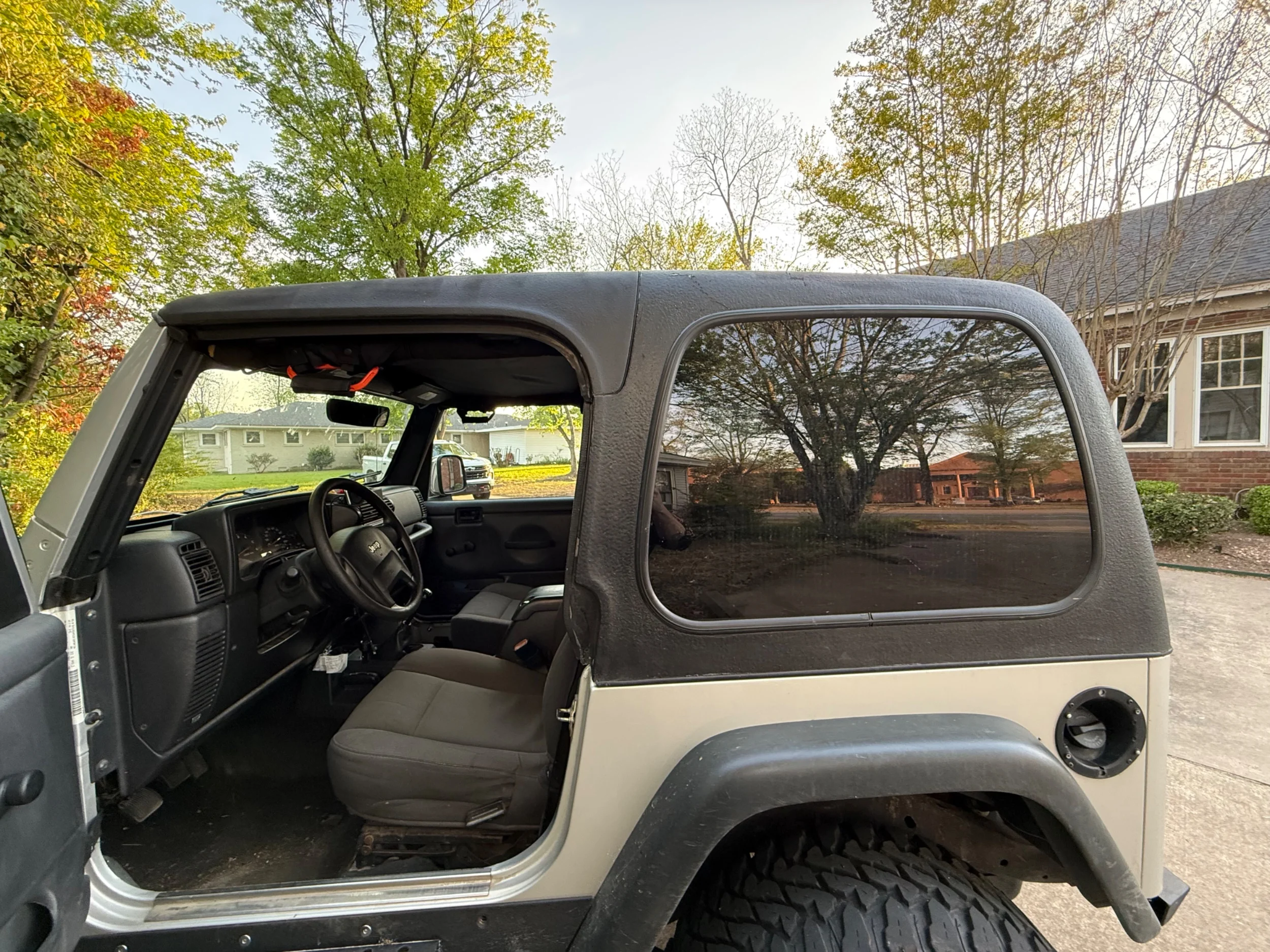

I’ve got an 06 TJ, it came with a hard top on it. The fitment around the doors isn’t great, and the rear glass squeaks while driving around.

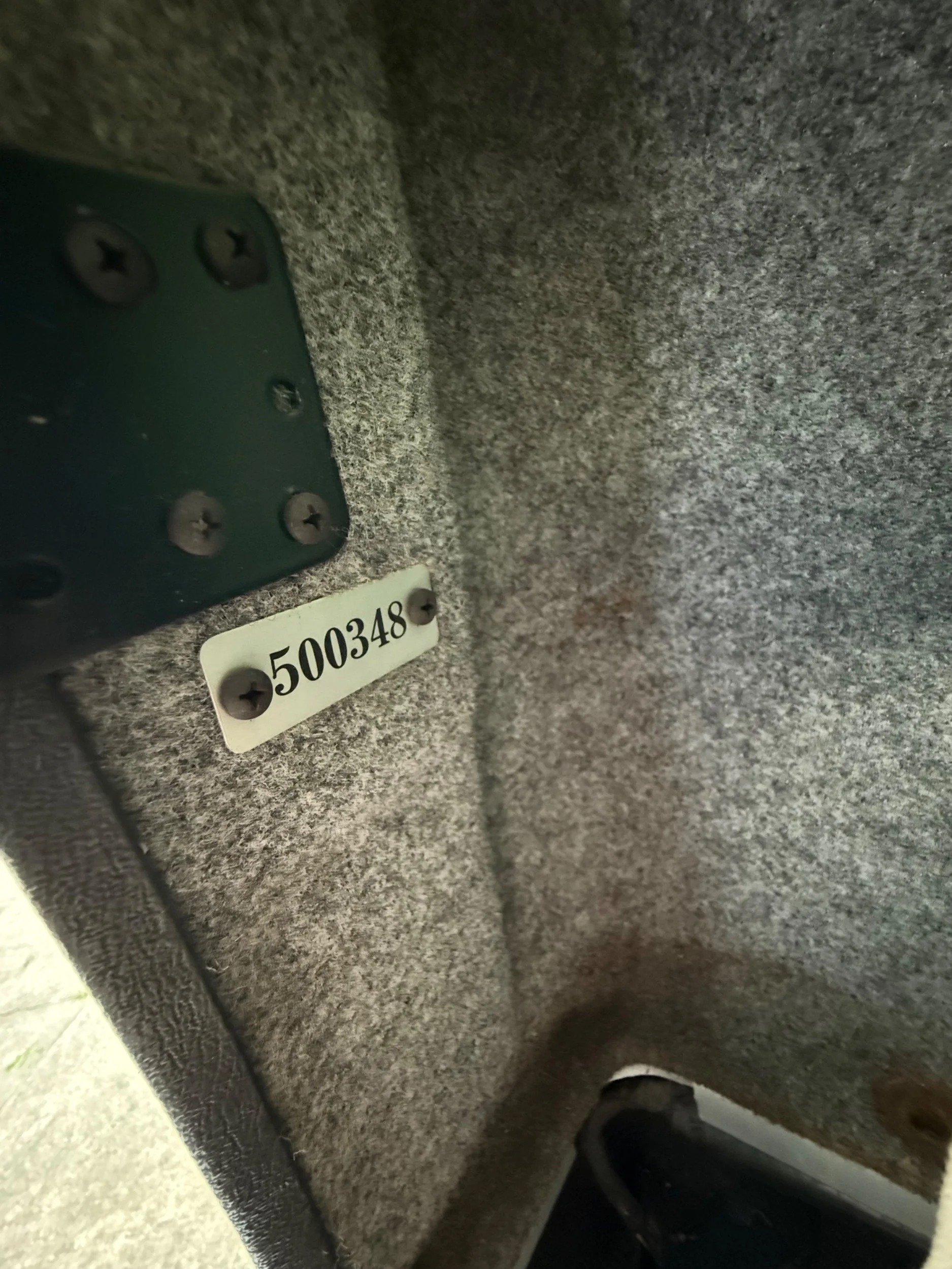

Does anyone recognize the brand?
The only marking that I’ve found is the serial number plate on the inside next to the rear glass

If the window squeaks from the hinges, take them apart, clean them, oil them and reassemble. If it squeaks from the rubber seal, clean it and put baby powder on it. There, I just solved your window issue.
Where the doors don't fit you will have to find additional weather stripping or a body shop can alter the top to fit better.
