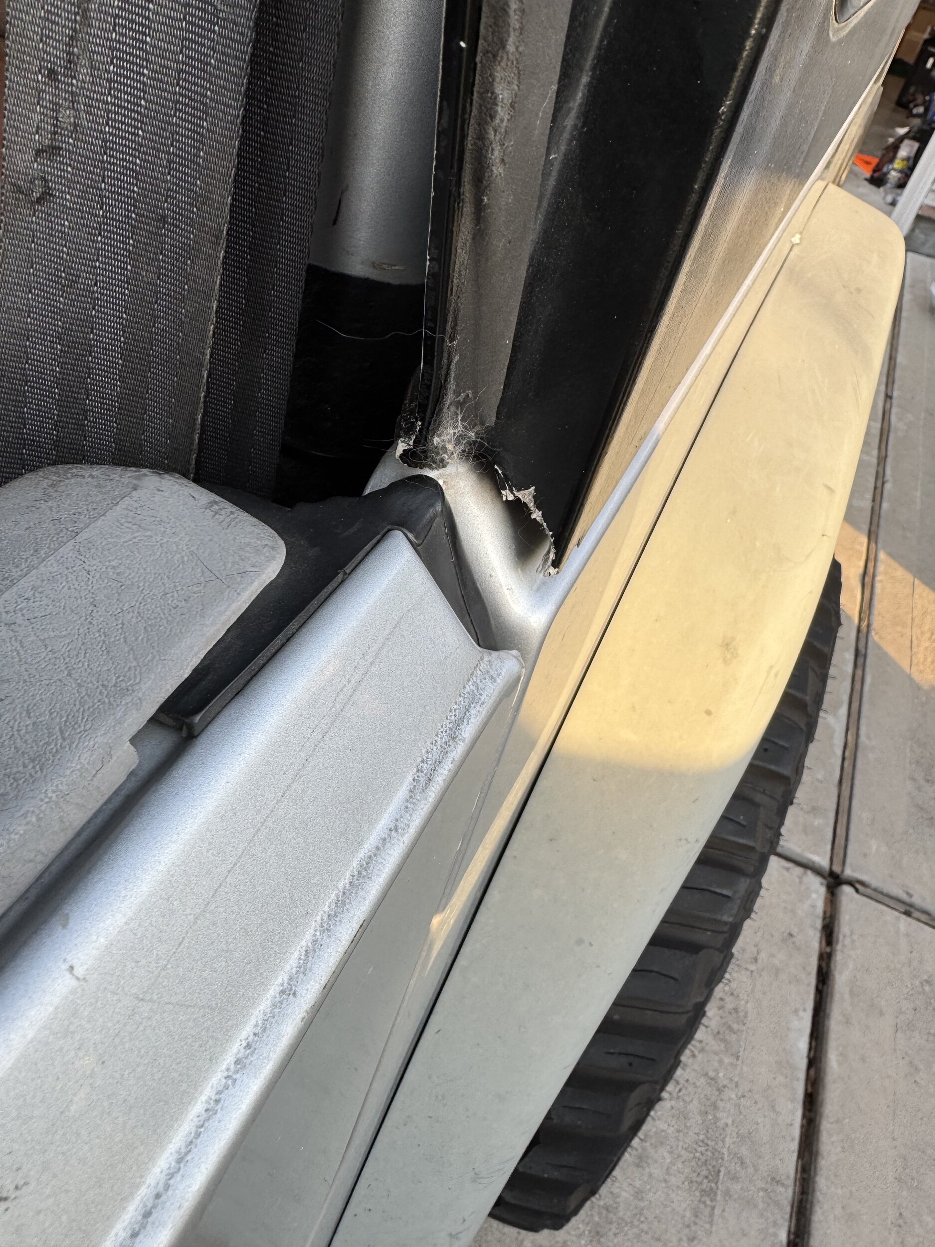

Typical corner cracked off on the TJ. Saw lots on fixing it here but I don’t have the piece that cracked off. Any recommendations on what to use to rebuild the corner so I can epoxy it back on?
I've used urethane adhesives quite a bit but in my experience they're not as good as fiberglass for a repair like the ones you've got to do to repair a Jeep Wrangler TJ hard top. They do bond well to fiberglass/SMC, but two things are lacking:
- A repair using SMC-compatible polyester resin and fiberglass cloth or mat will be stronger than a urethane adhesive repair because the repair will be reinforced with new fiberglass. A...
I need to do this same corner, be thankful yours isn't as bad as mine lol
