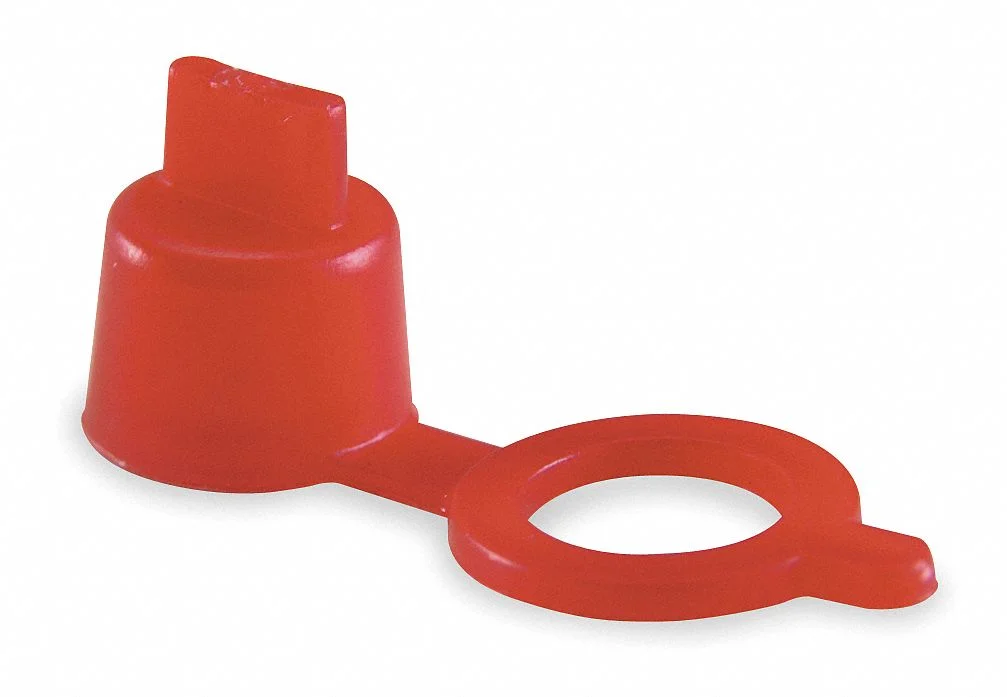

From @astjp2: “You leave a dab of grease on the zerk, when you go to grease again, wipe off the dab and the fitting is clean, then leave a dab again. Just an FYI.”
Or, from @mudmaster, use one of these caps.

I put a cap on all of my fittings
