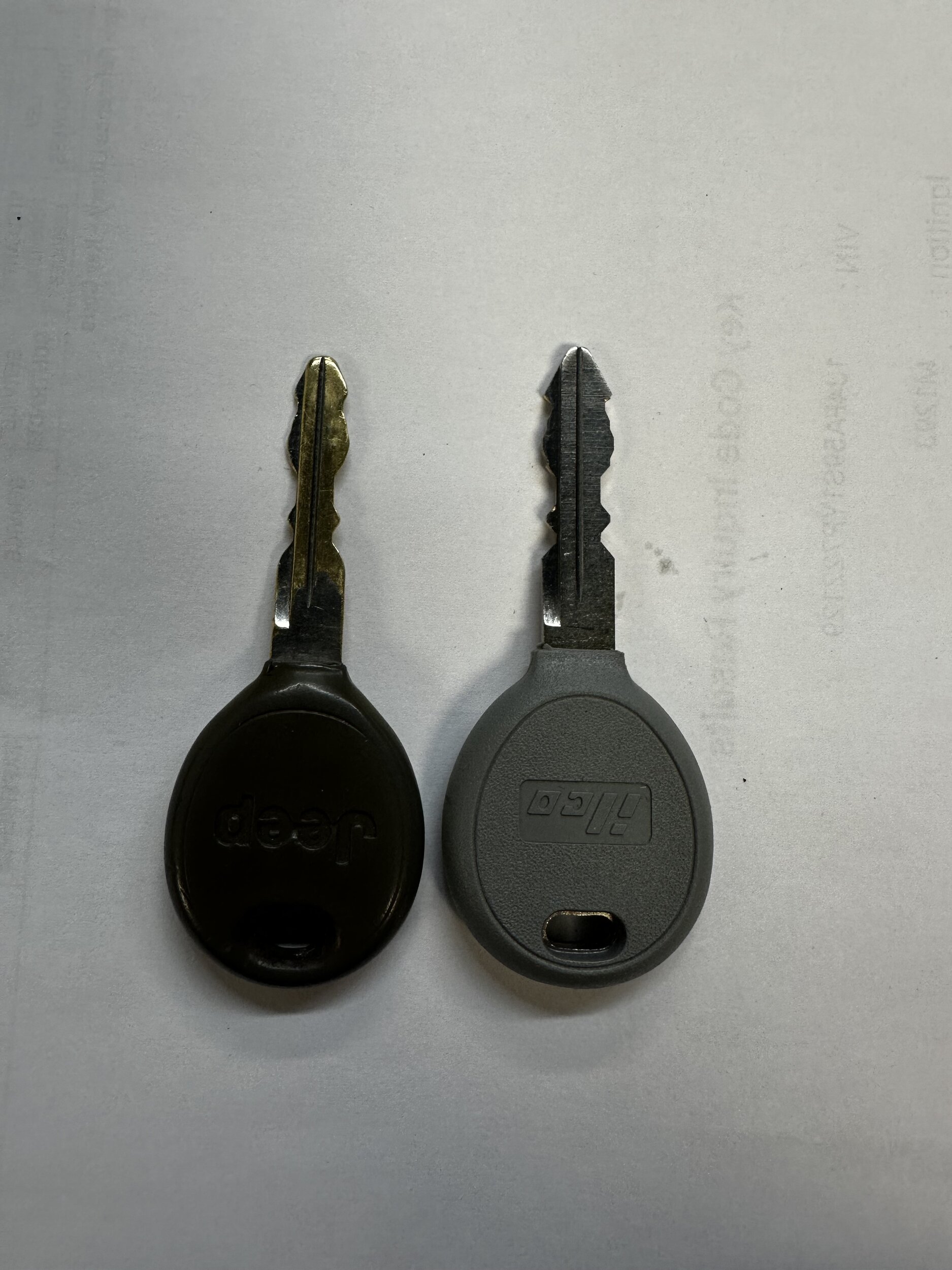

Be careful copying a 20 something year old key:
That’s the key that’s been in my pocket vs the one the dealer cut from the vin. I thought I needed to replace the ignition cylinder again but the issue was the key
I took both my non SKIS keys to a locksmith and they scanned them with a machine that gave them the probable original pattern. They cut a new one from that pattern and it works like a new key would. Only comes out of the cylinder in the off position.
Yep, we almost always cut to the VIN at the dealer for that reason. The exception is the person who keeps a newly cut key to use as a master.
There are 4 different height tumblers if i remember correctly. When i rekeyed all my locks the same i had keys made according to the order of the tumblers since the vin was no longer a useful reference.
Which is exactly why we only cut to the VIN. Even if your tumblers are not VIN specific, we change them until the OEM issued key works.
