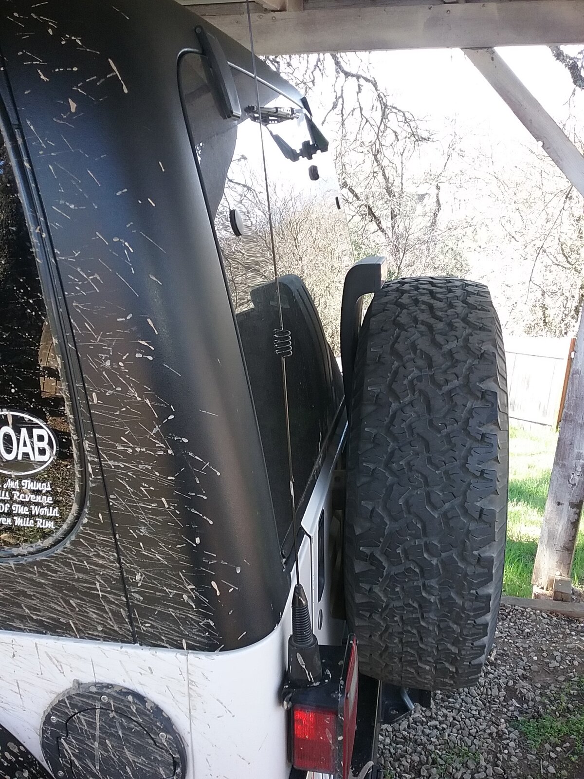

I made the switch a few months ago. Ditched the CB and Firestick for a Midland MXT-275 and their 6db gain antenna. Bought the license and mounted the antenna on the tail light mount. Not an ideal location, but I didn't want it on the hood or cowl. I also picked up a Browning BR-450 antenna just to see if I could get a better SWR. The Midland antenna gave me the best SWR out of the two, so I'll be bringing the spare Browning antenna as a spare. I also got the SW-33 meter to tune them. Best I can get with the antenna where it is is 1.43:1. It's a compromise, but good enough. We have several repeaters in my area and am amazed at the range I can reach with them. You can go to mygmrs.com to get a map of available repeaters. Some you need to get permission from the owner to use them, or get the appropriate PL tones. I also picked up a HT from Radioddity for $39. It's 5 watts and pretty simple to use, and it's part 95E compliant for GMRS, unlike the evil UV-5R, lol!
To answer the question about antenna tuning, you can tune them for a better SWR, but you don't need to take much off. Most you only need to snip a half inch or so shorter. Do it in very small increments with wire cutters, or a saw. Go too short and you throw it away.

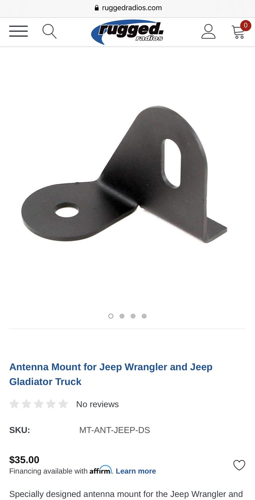

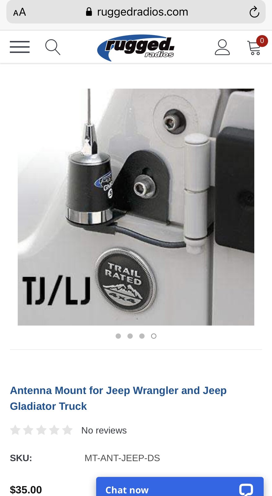

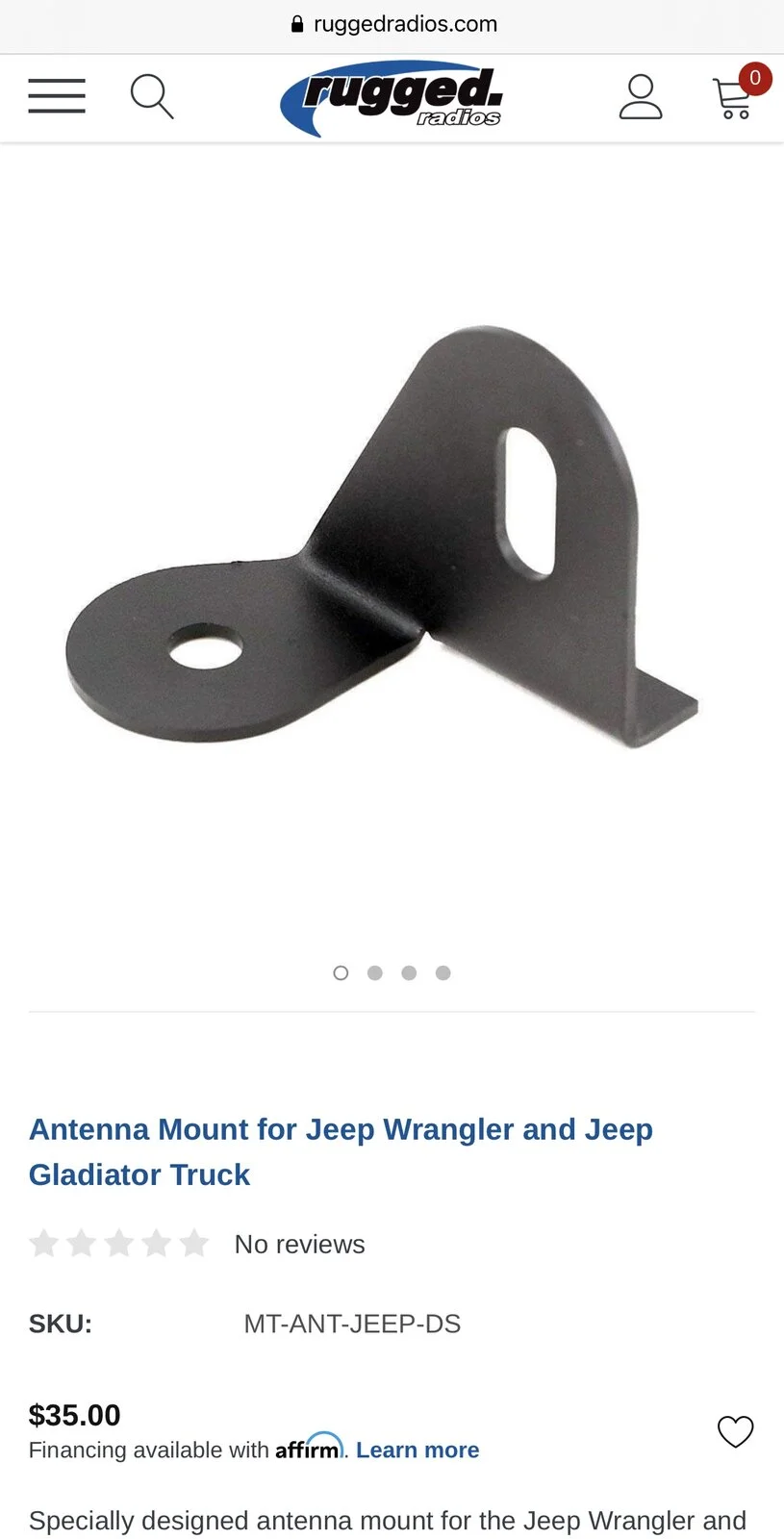

This is the mount I was thinking of using.

Yeah, the proximity to the windshield post will give a high reflective signal back into the radio. It will also give you a dead spot in it’s shadow.
Jeeps are an awful design for good RF... you could probably toss the same setup on any SUV on the roof and be more or less set! It’s all about optimizing for what you need and accepting the trade offs.
