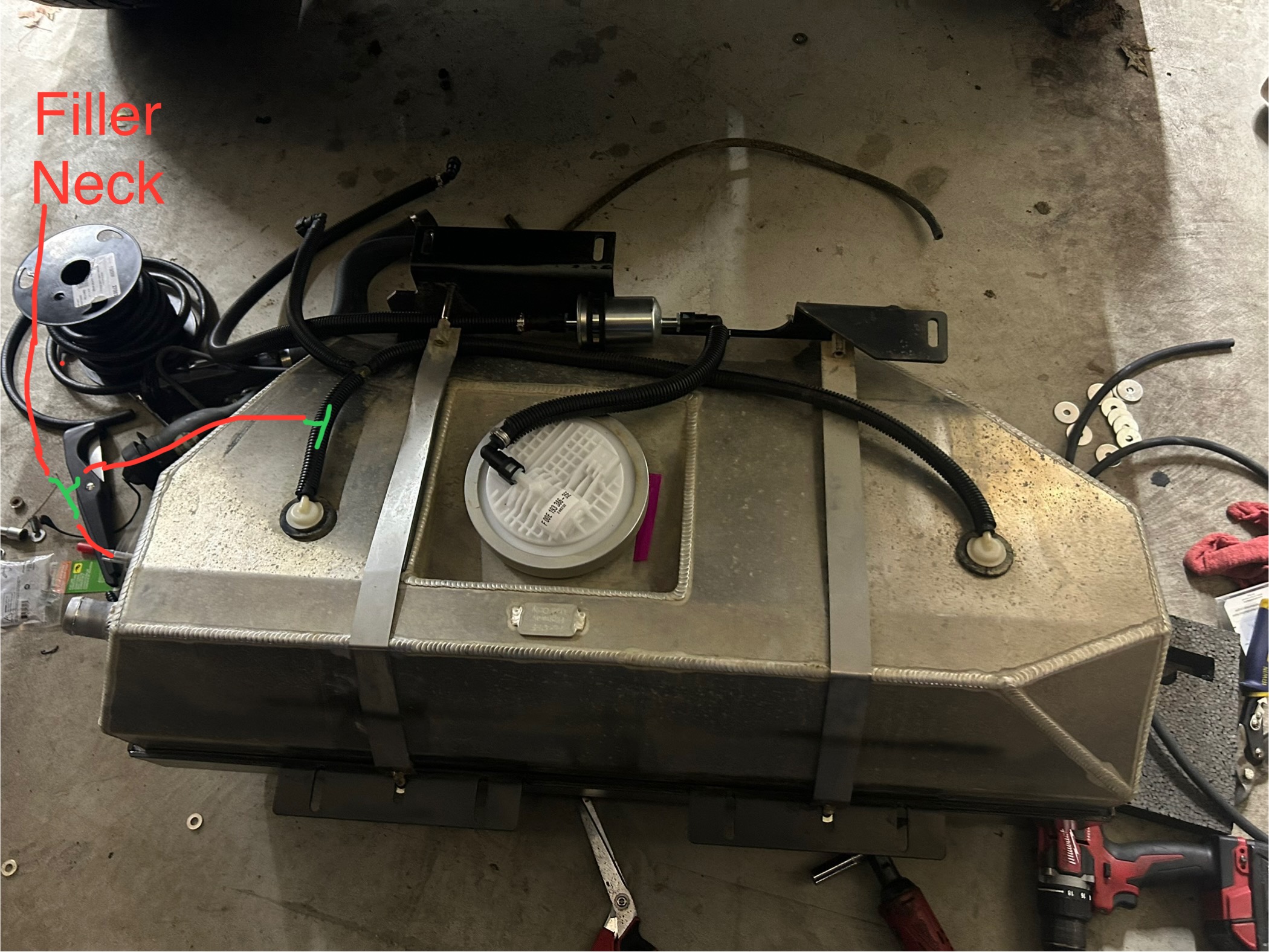

My 2000 TJ with a Genright 25gal 05-06 tank has a slow fill issue where I can only depress the gas pump trigger halfway, so it won't shut off. With doing a 05-06 tank with different EVAP components as the vehicle it was going on and I also had no instructions on the proper way, I just made up what I was doing. I attached the fuel filler neck vent hose (small hose) straight to the small nipple on the tank. I have had this slow fill issues for years but just left it alone since it was more of an annoyance than an actual problem.

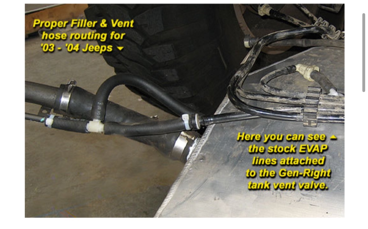

Fast forward to this weekend, I was installing a brand new from Genright 04 LJ Safari Tank that had the instructions, and I noticed on the instructions it had a different vent hose routing setup where it "Ts" off from the small nipple on the tank, the EVAP canister and the filler neck. Now I am wondering could I fix my slow fill issue on the TJ by installing a "T" fitting between the tank nipple, EVAP hose and filler neck vent port?
In the attached photos, the first one is of my actual setup and some lines I drew to represent my thought on routing. Second photo is straight from the Genright instructions on the 04 Safari tank and how the filler vent gets routed.
