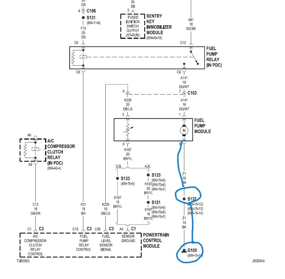

Hello all I'm sorry for having to ask for wiring help but I have read many threads but could not find the solution to my problem. I have completed a chassis swap on my '97 Tj and it won't start. It ran before the swap but now there isn't a proper ground at the fuel pump connector.I have 12 volts at the plug and the fuel pump runs with alternate 12v source, all the relays and fuses are good. the Jeep runs on starting fluid.My problem is I can't quite decipher the wiring schematic, I'm trying to trace the ground wire circuit and it looks like the ground wire goes to a S132 connection then to a G105 connection then an S130 connection and on to PCM cavity A32. Am I to assume I should have continuity between all these points with the key on or off? What are the connecting points S132, G105 and S130, are these ground points on the engine block and body? As you can tell wiring is not my strong point. thanks in advance for any help, Gary

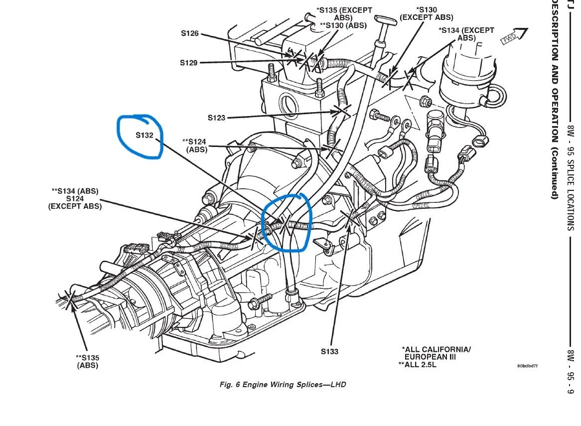

Looking at the diagram, the ground signal from the PCM only completes the circuit to the fuel pump relay, not the pump itself. The ground to the fuel pump module itself comes from ground point 105, through splice 132. So you should have continuity from the negative side of the pump connector to ground at all times whether the key is on or off.
If there is no ground continuity at the plug to the pump and ground point 105 is secure at the right rear of the engine block, check splice 132 located in the loom near the back of the bell housing. See pics.

No, look at post #5 again. That ground is not controlled by the PCM, it's constant. The 12 volts should not be constant, it should only have 12 volts at the pump when the key is on and the PCM commands it by grounding the fuel pump relay.

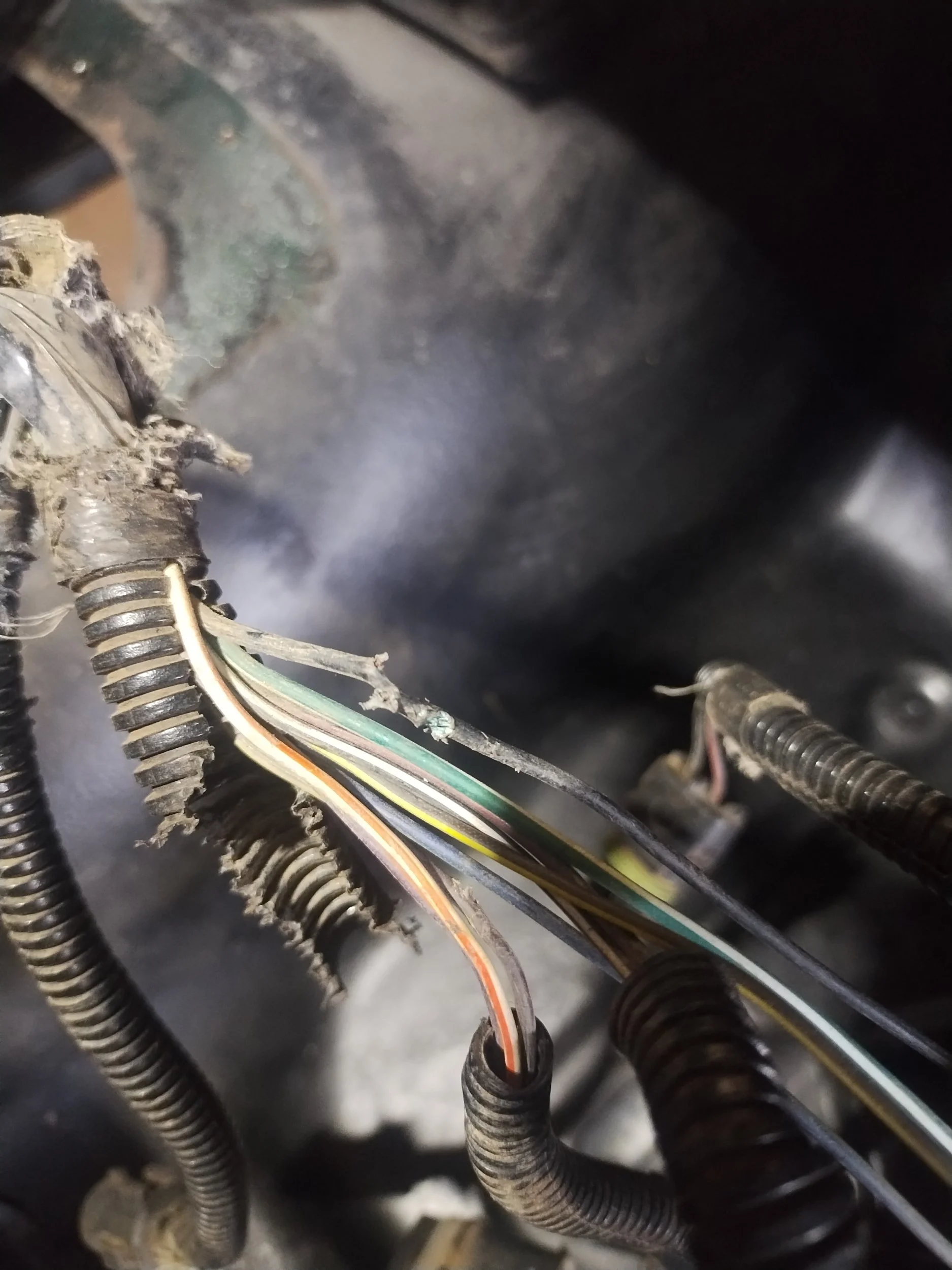

Something tells me you're going to find more damage that just that ground wire.
My guess is the shop pinched or stretched that harness and the pump ground is just the beginning.
