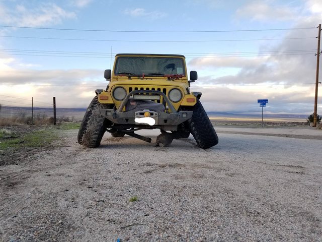

Most people here don’t bother with trussing, as axle beam failure is relatively uncommon unless you are jumping the Jeep. Generally you’ll blow up a ball joint, bend the inner C’s, or tear off a bracket before beam failure.

Here is a (rare) example of a beam axle failure, taken from Reddit:
