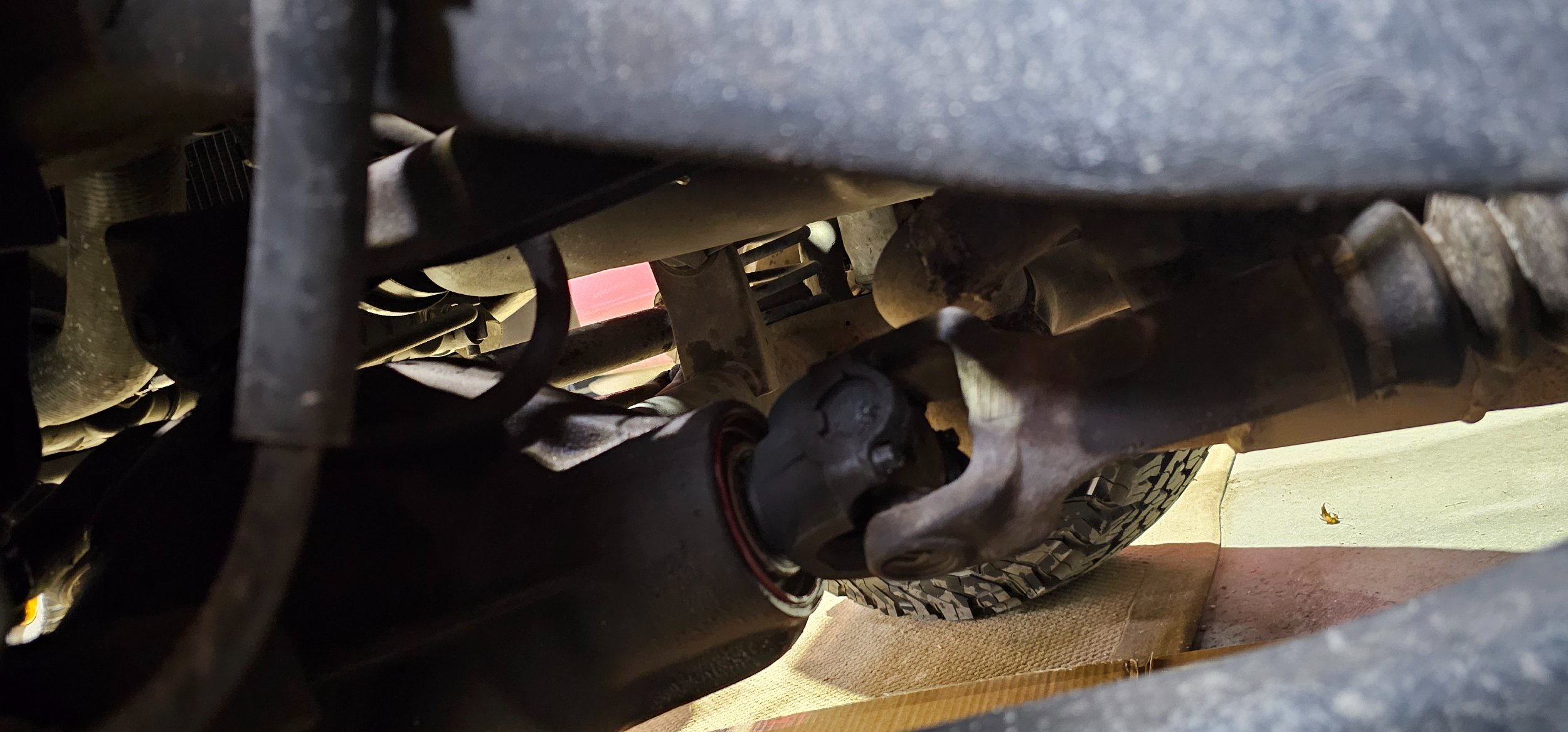

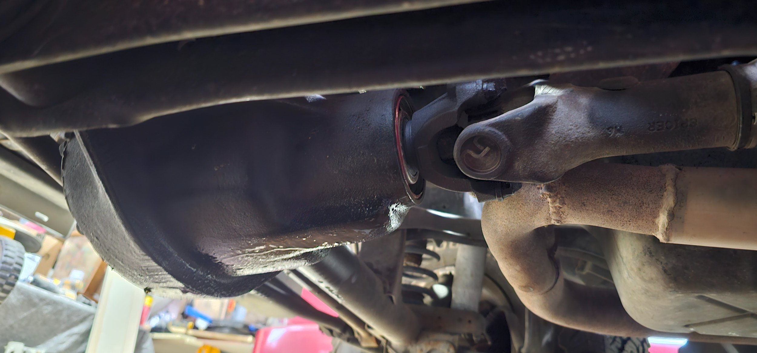

It had a leak and I had it replaced at shop. Leaking again. Yes, I can take back and he'll fix. I feel a little bad because transmission also had a leak, we both thought was pan, so had him service it and replace. Then it started leaking again right after, so he pulled everything and re-sealed it only to figure out it was actually the shift linkage on top that had the drip. In his defense, it was pretty nasty under there due to the leak and all the grime from recent winter weather.
The bigger part is, finding time I can get it to shop as it's my college daughters car and she has crazy hours. So if fairly simple, I'd just tackle it. I have to work on it this weekend anyway for thermostat and maybe EVAP system.
My understanding is there is a backlash that 'needs set' if you do a pinion seal, but stuff I'm seeing online says to punch the nut and the shaft and maybe count threads then just spin off nut pull seal, replace and ensure the correct threads and that the punch marks align and good to go.
Is it that simple or do I have him replace. He's been pretty good to me over the years.
Replace the yoke. If the seal is still in good shape then it probably doesn’t need to be replaced again but since it’s off, it wouldn’t hurt to put another new seal on there
Can the yoke just be pulled and replaced without messing up the seal? Does it need pre-load or anything set? I guess I'm partly wondering, again, if have him do. The seal has only been on about 2 weeks.
Lots of opinions on that and you’ll have to draw your own conclusions. There are some threads on here. Since the seal is only two weeks old, I think it’s likely the yoke is grooved. Happened to me. It’s not a big deal. I’d probably just replace the yoke and leave the seal alone.

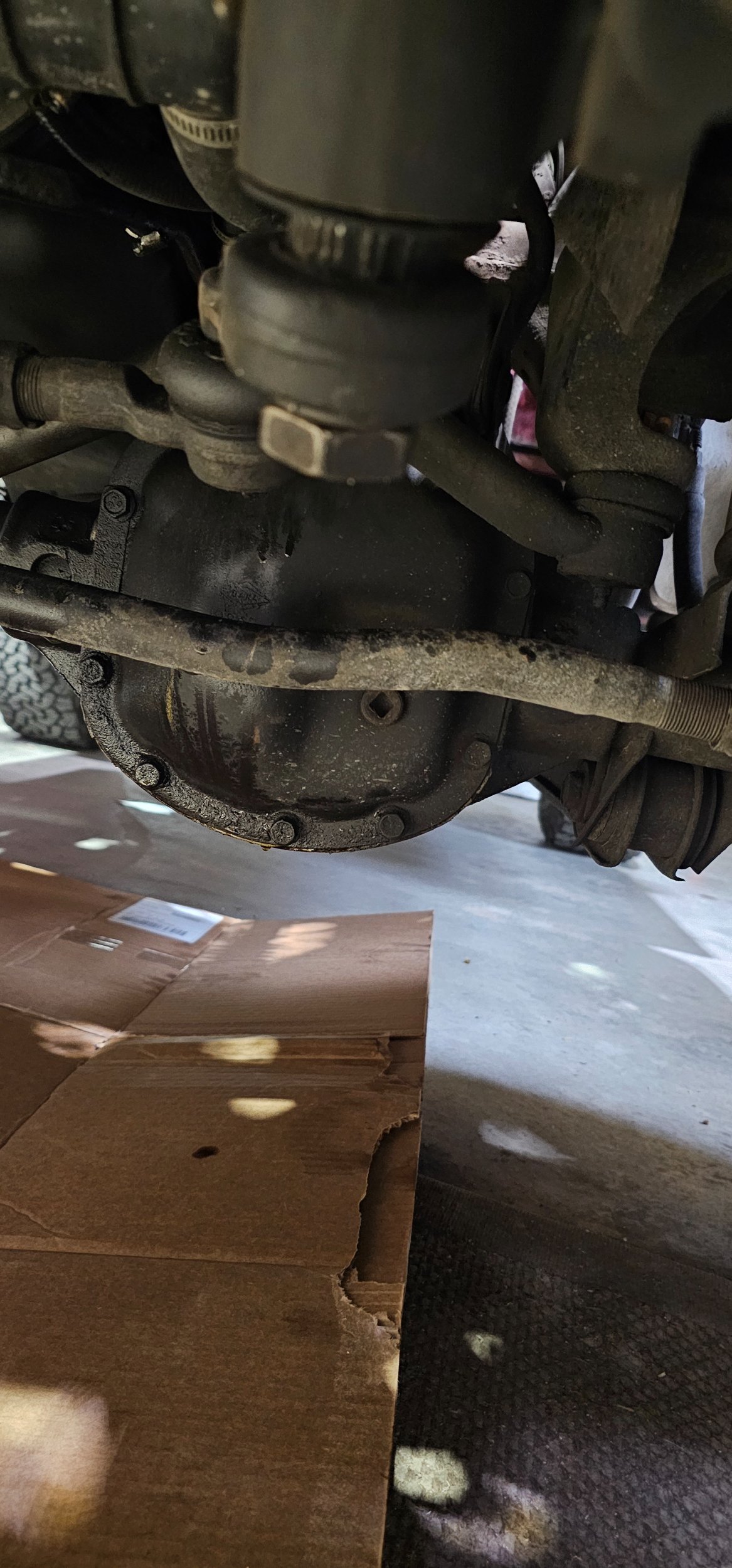

I'll post pic of diff when back home.
That's the one I would purchase.
