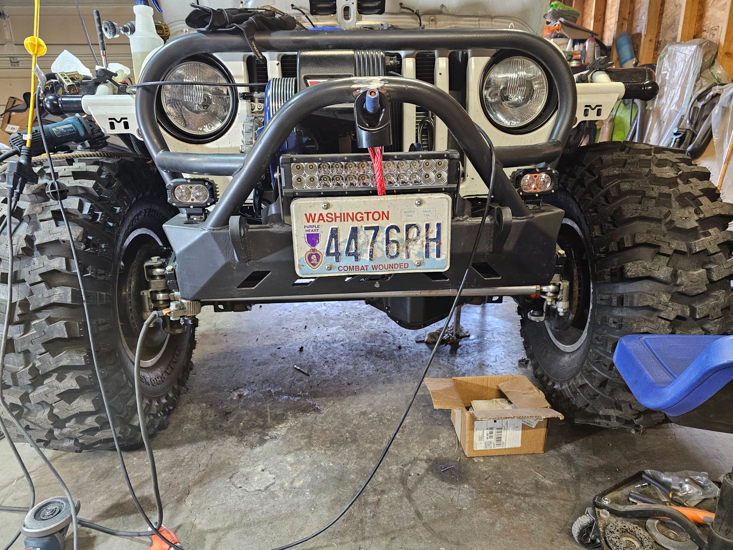

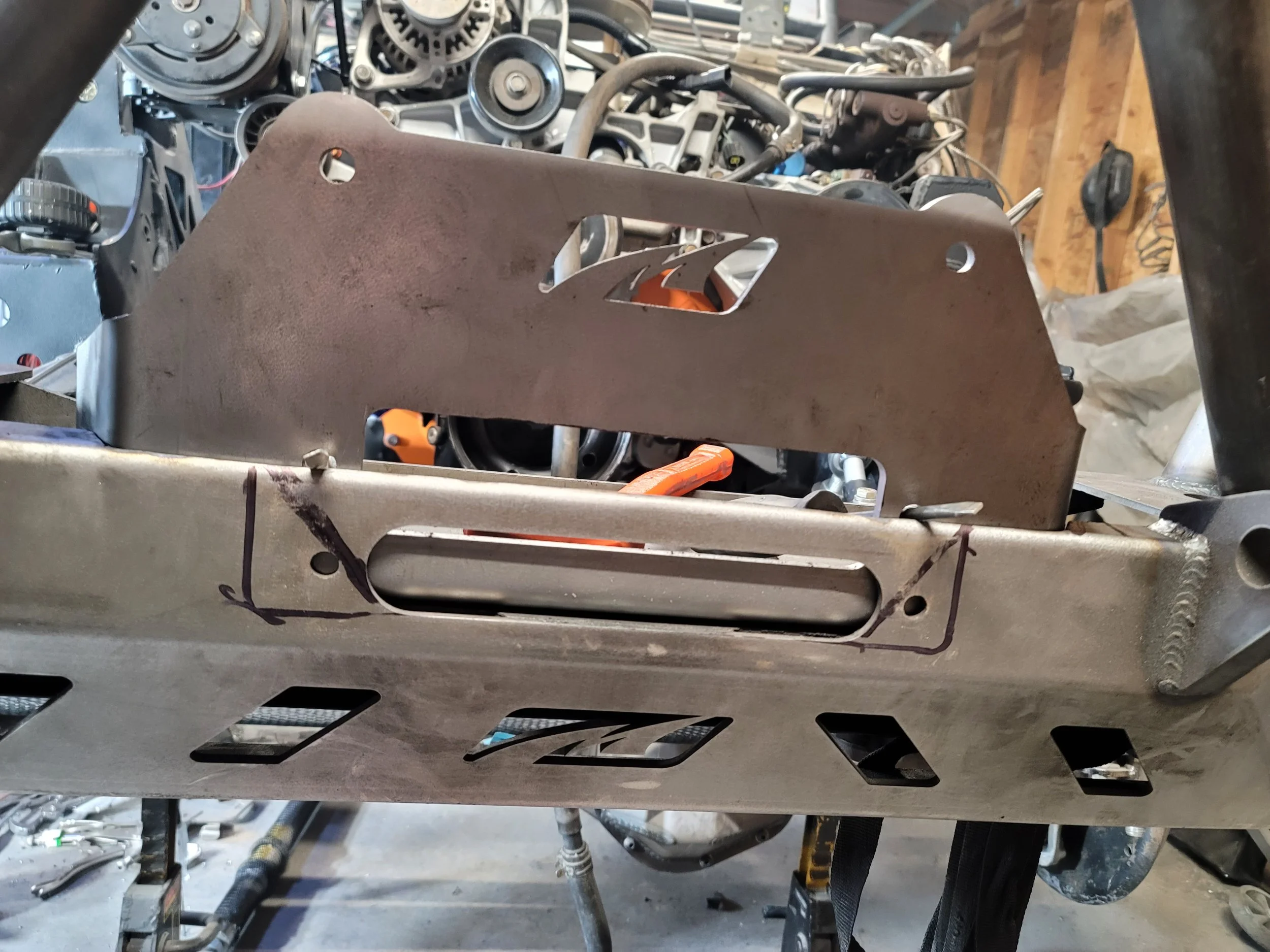

Crossmember or sway bar? I have a motobilt bumper where the winch is sunk lower into the bumper. Won't work with a traditional sway bar, need a swayloc or antirock
Like this?
One without the winch.... Doesn't actually sit any lower than any other winch on a winch plate.
@Wildman yeah looks similar, I don't have the full wrap though. The Crusher? Not a great photo of mine but jeep is buried in snow right now and I'm to lazy to go outside. Had a different bumper from PO when I bought it, this sits couple inches lower than what I had. Has a cut out that drops it and scoots it back next to grill
Yes Crusher with a 8274 plate welded into it. Had to do some trimming to make it all fit.
