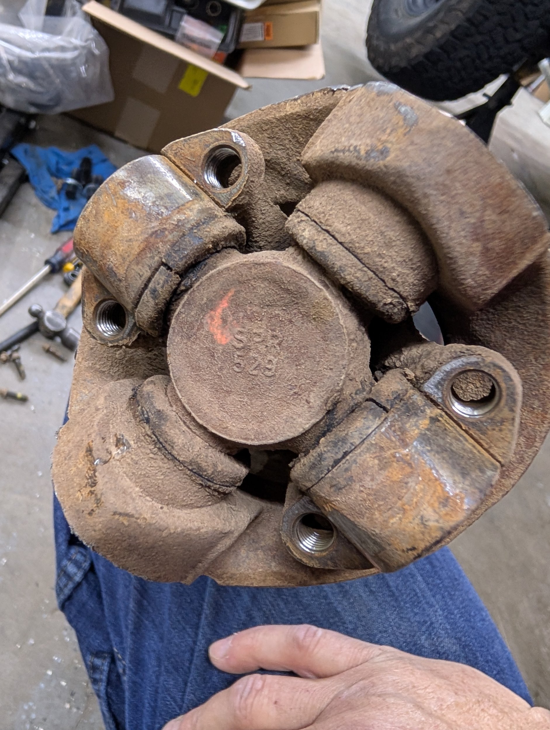

Ok....took the advice and put it on jack stands. It is in the front for sure. Since I'm by myself hard to pinpoint where it is. But for sure in the front. I suppose if there are no comments I will pull the front drive shaft but I figured I would see what you all think.
Reactions: macleanflood
So just help me understand as I'm thinking about this. If I pull the front driveshaft, won't that just prove it's in the front but won't actually tell me where it is coming from? I'm trying to narrow down more accurately where it is coming from. I mean we already know it's the front because it doesn't make the noise in 2wd. So taking the front drive shaft out won't tell me u joint, cardan or axles. I'm just trying to understand.
If you drop the shaft and drive it around it will eliminate the front axle if it's quiet.
On the stands, drop it, inspect the DC centering ball for roughness, verify the noise is gone.
If the centering ball installed was greaseable, and never greased, that could explain the short life.
U joints are shot. Appears to be originals. Nothing moves smoothly. Before I start upgrading everything I want it to run and drive smoothly. So just going to replace all of it to start.
