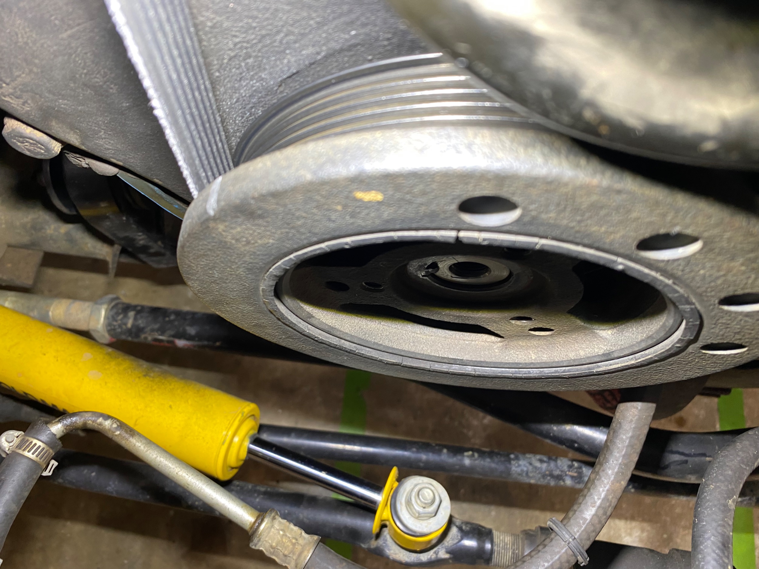

I think @JKP called it. After looking at it closer, it looks like the outer ring has walked off the inner pulley.

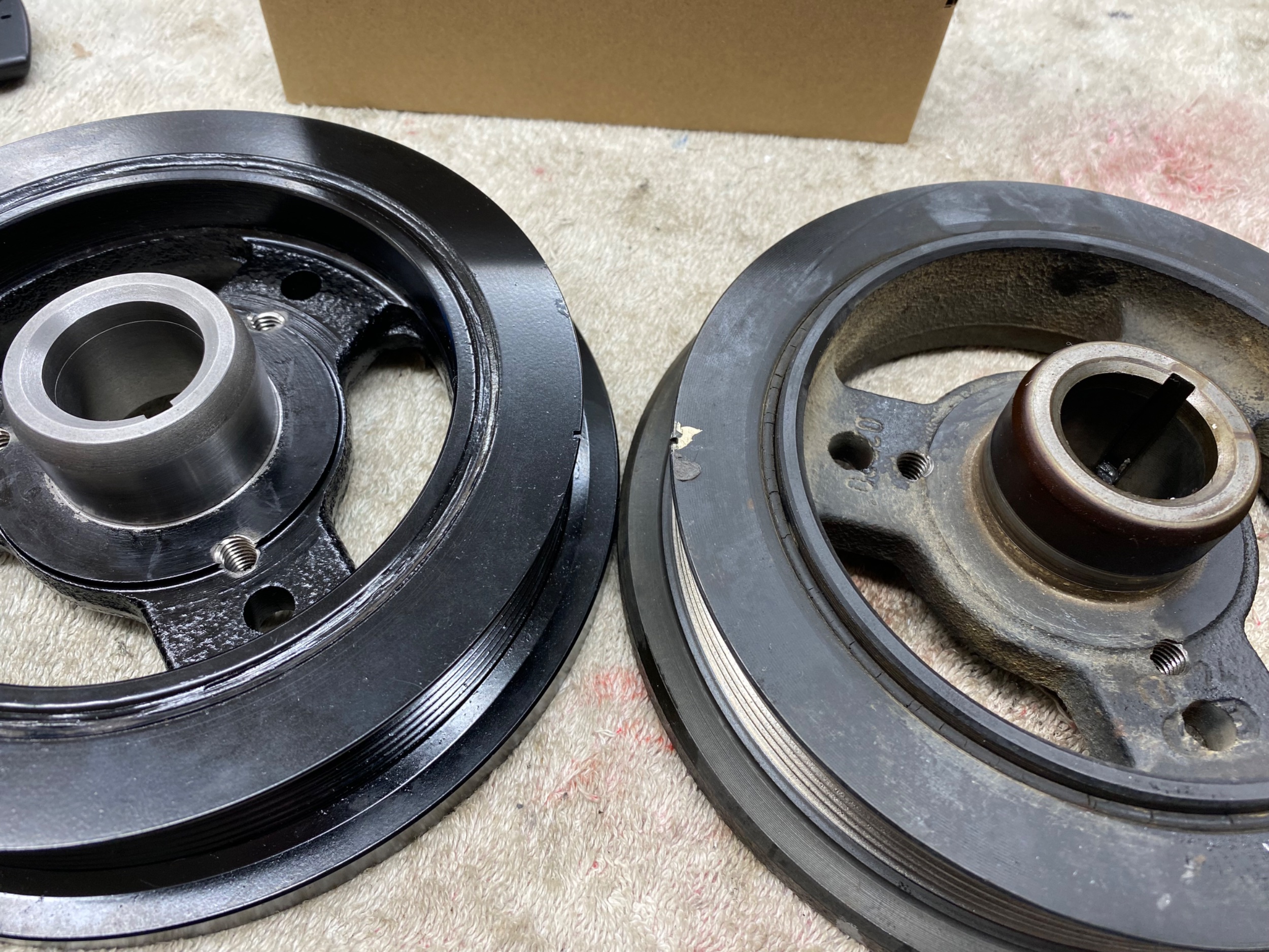

Does it matter that the timing notch in a new harmonic balancer is in a different location in relation to the keyway?
It’s very common for the outer pulley to slip and move the location of the timing mark. The pulley spins as well as walks off the hub.
So the original might not be where it started out at, correct?

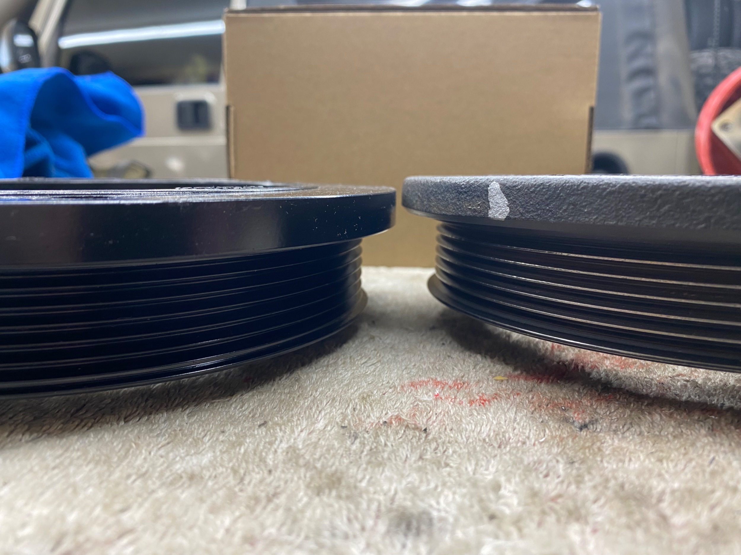

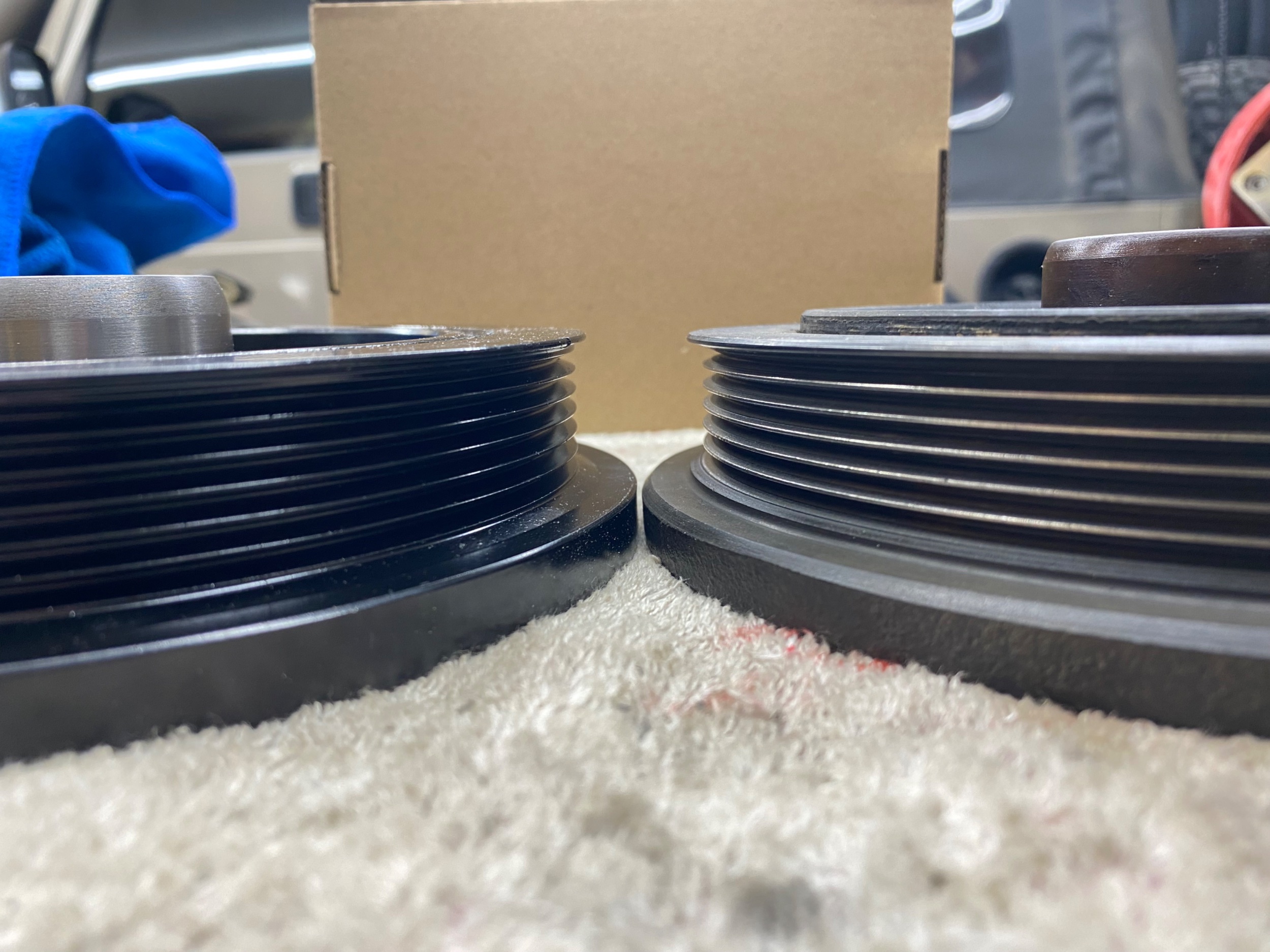

It seems like it’s way off from the Dorman replacement, but the Jeep was running fine, other than the squeak. The Dorman has two marks on the front so you can see if the two halves are lined up. I don’t see anything like that on the OEM.

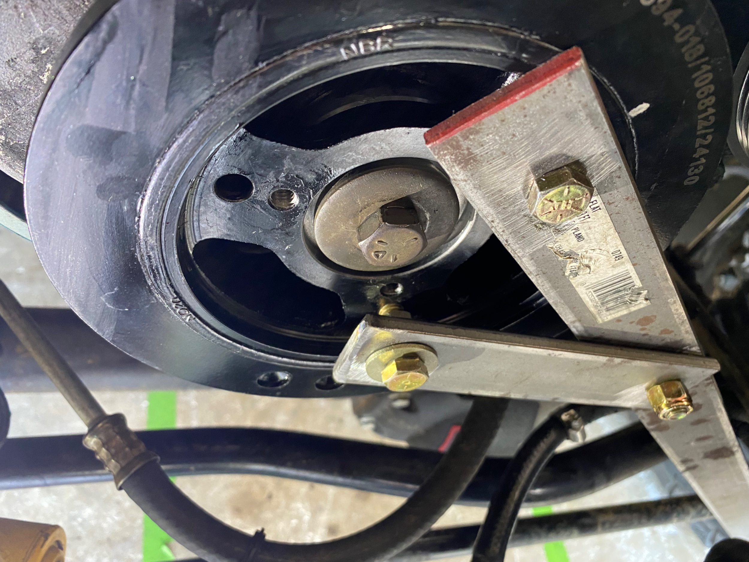

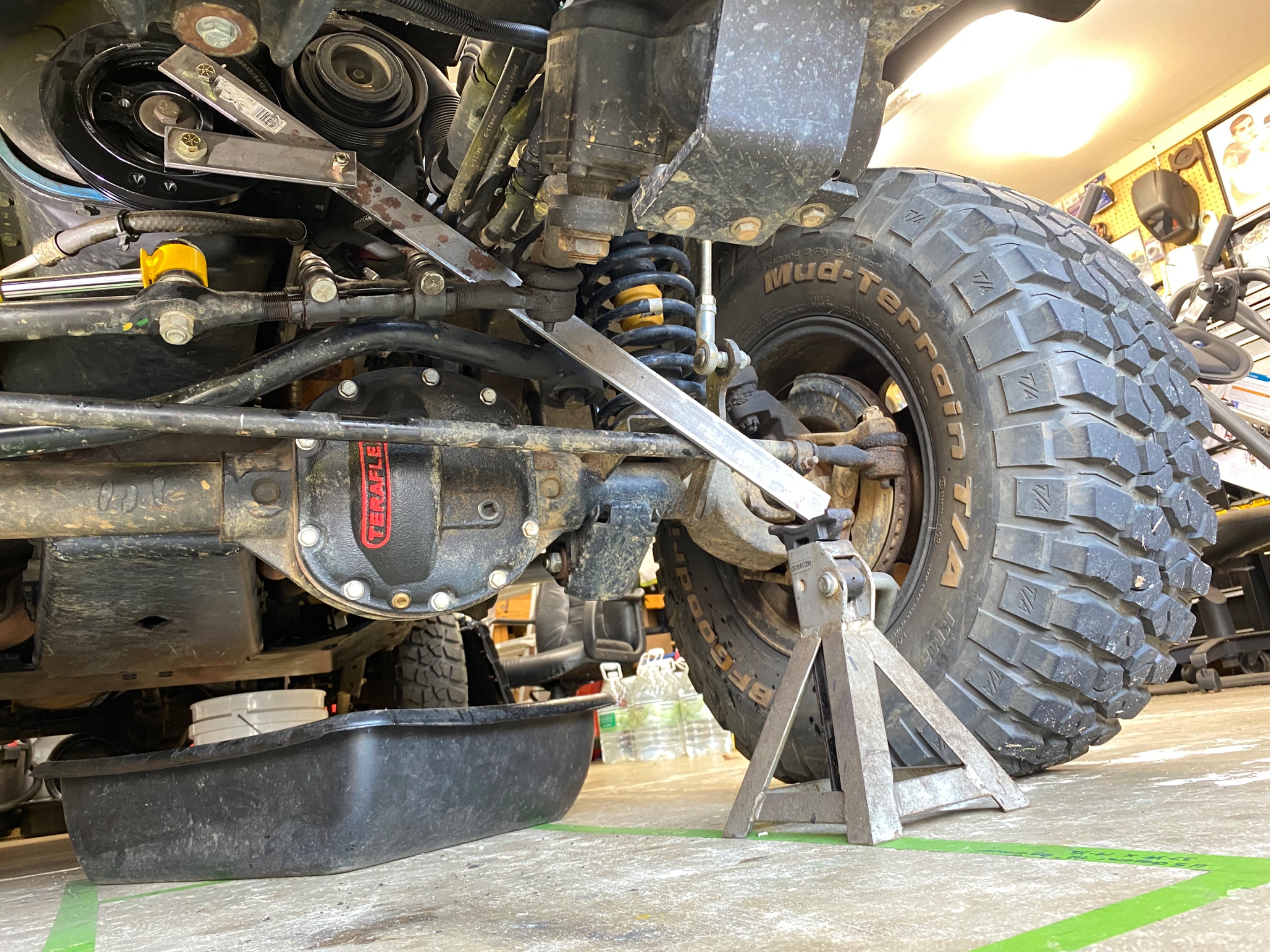

Had to make a tool to hold it so I could torque the bolt without turning the engine. I just used what I had on hand. If the long bar would have been an inch or so longer, I could have rested it on the ground instead of the jack stand.
