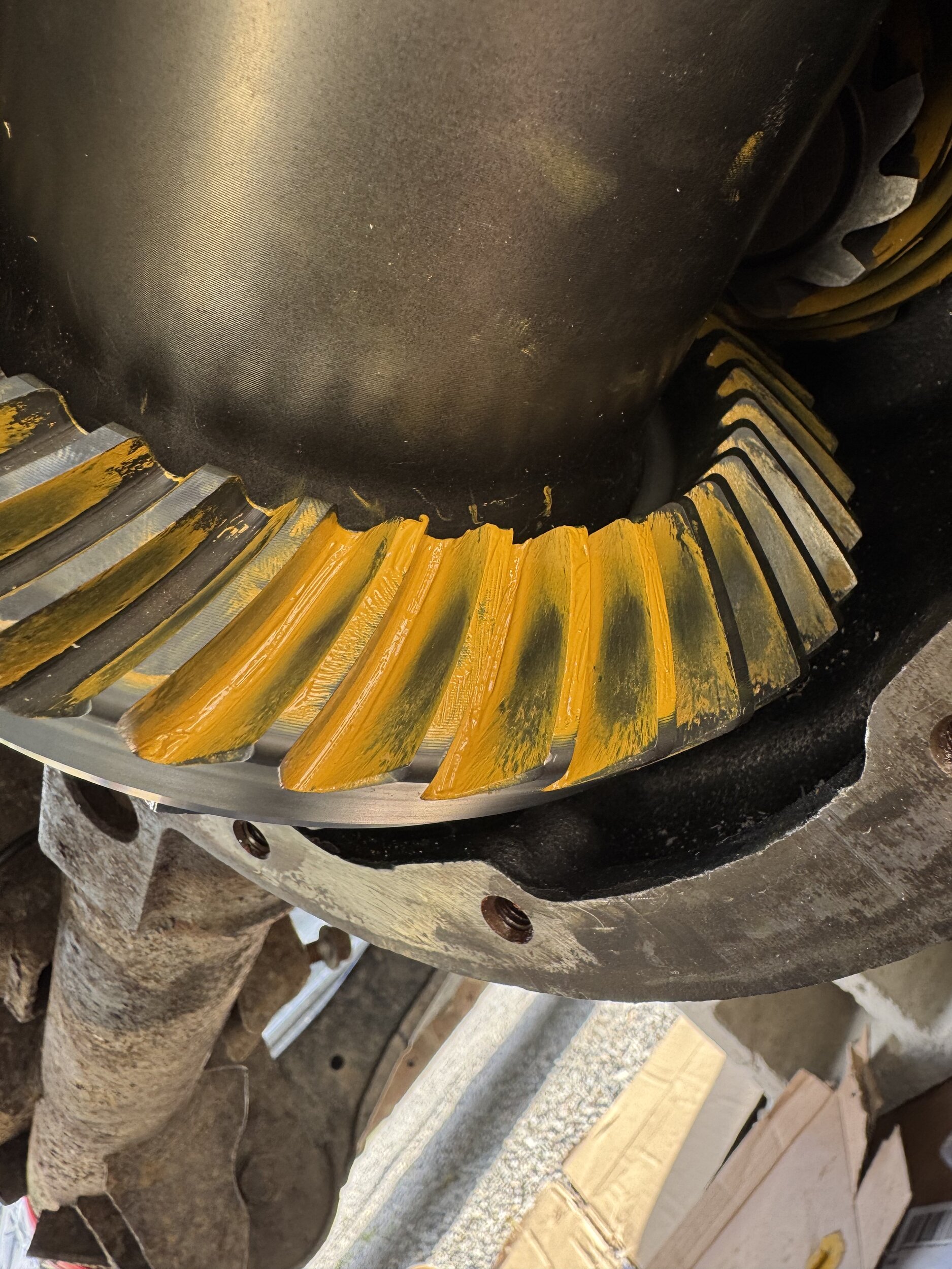

D delawarejake New Member Original poster Joined Aug 19, 2025 Messages 9 Location Idaho Sep 14, 2025 #1 Just for peace of mind since this is my first regear. I feel good about this pattern but curious on others’ thoughts who have more experience. Backlash is 0.006. Pinion depth 0.035
hosejockey61 FAFO Supporting Member Ride of the Month Winner Joined Apr 9, 2020 Messages 4,429 Location Parker, CO Sep 14, 2025 #2 I'm no expert, maybe even an armchair quarterback..... But run it, looks good. Reactions: NashvilleTJ

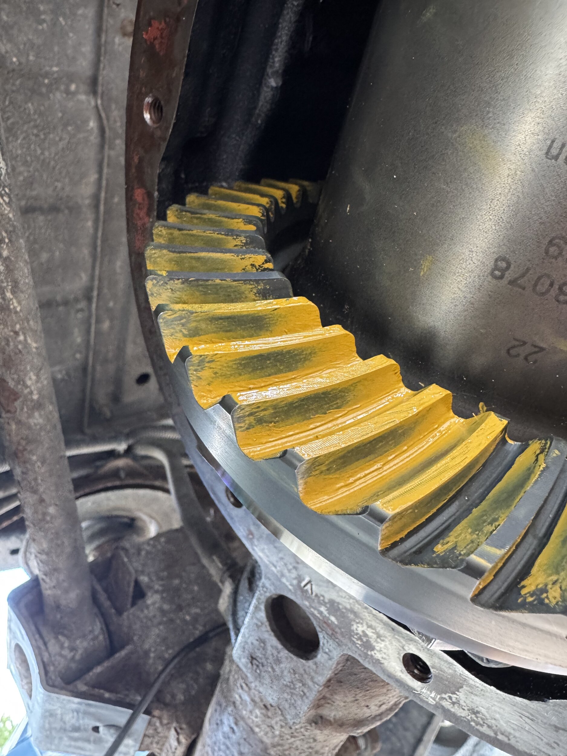

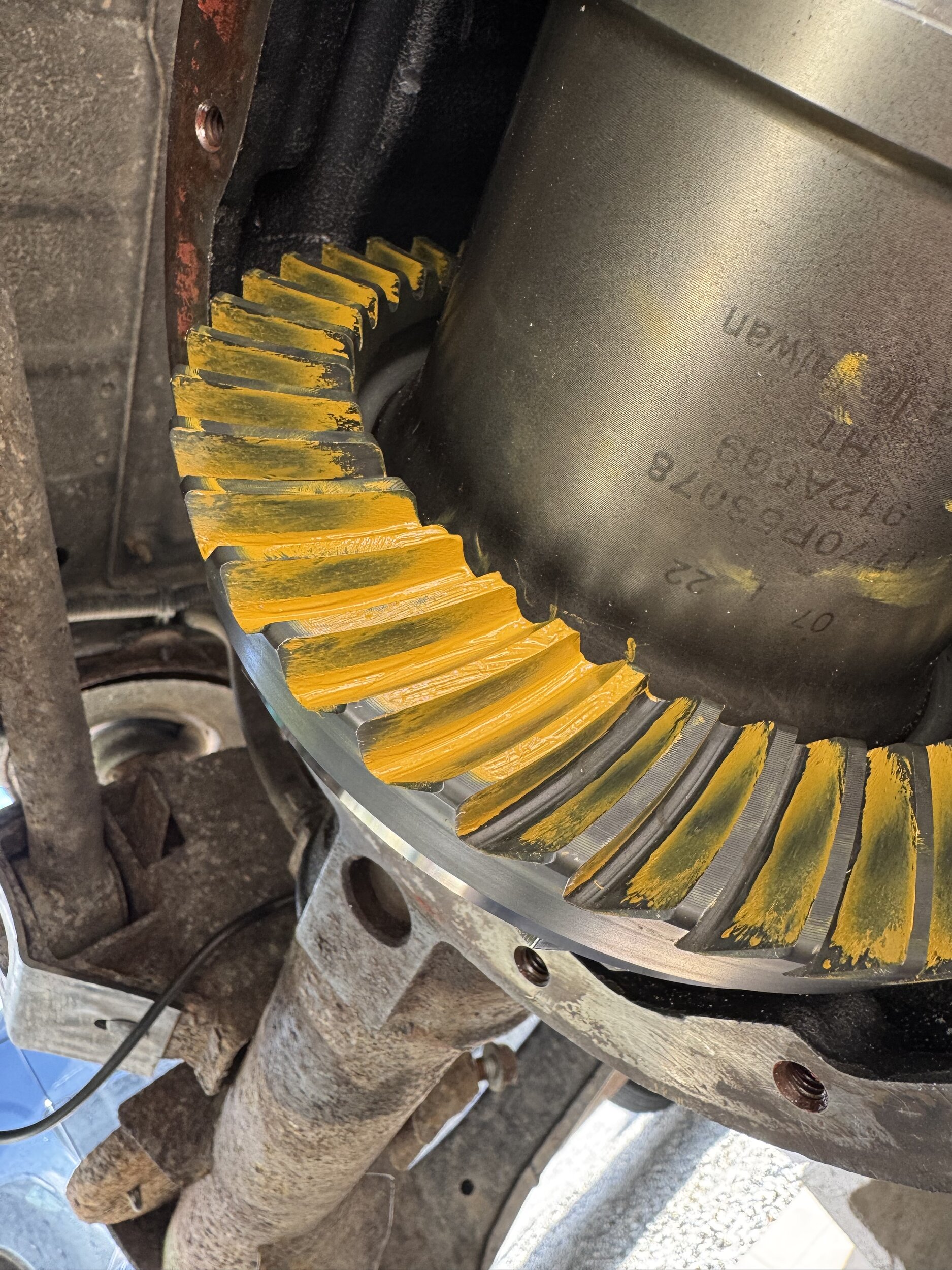

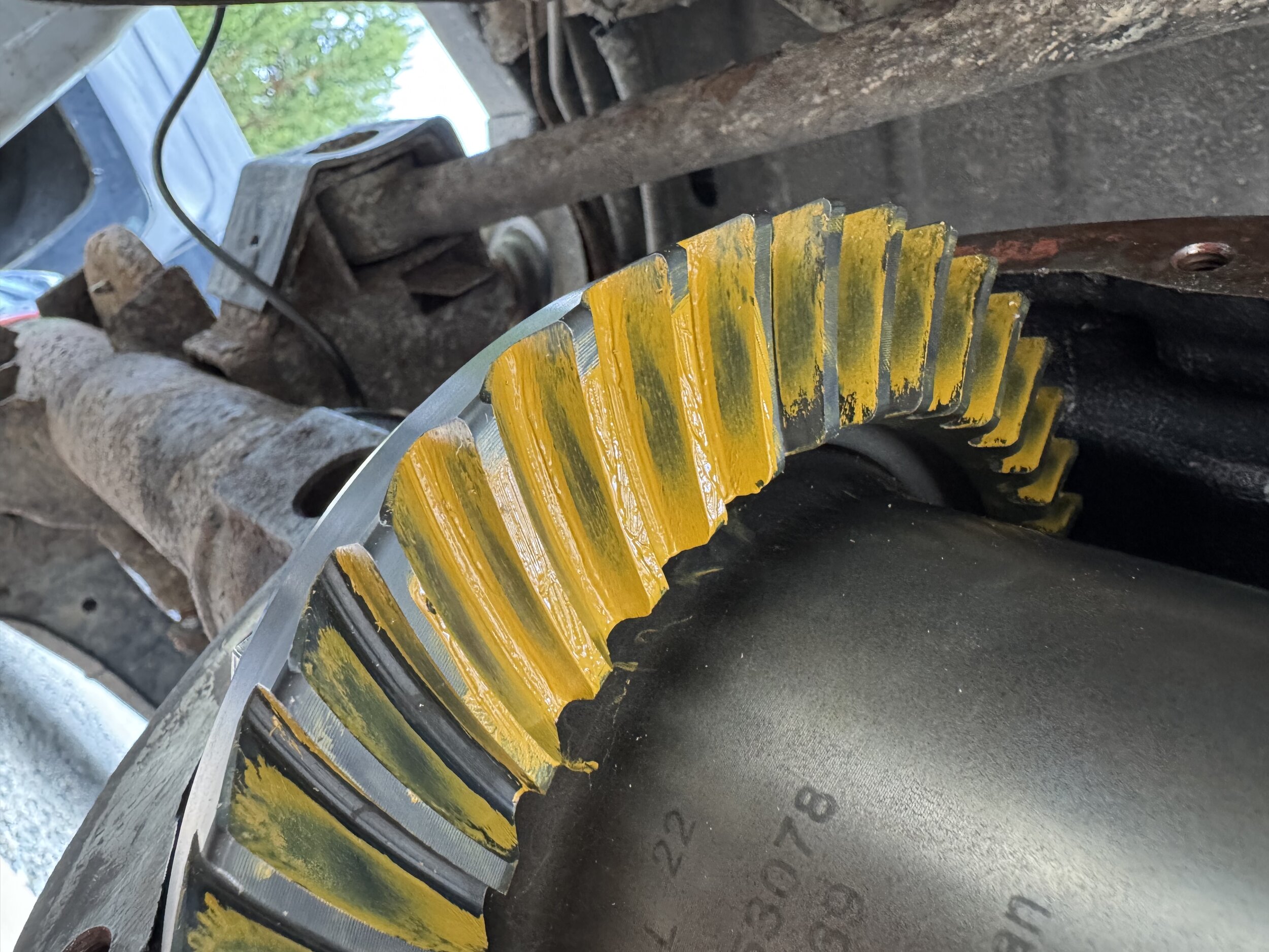

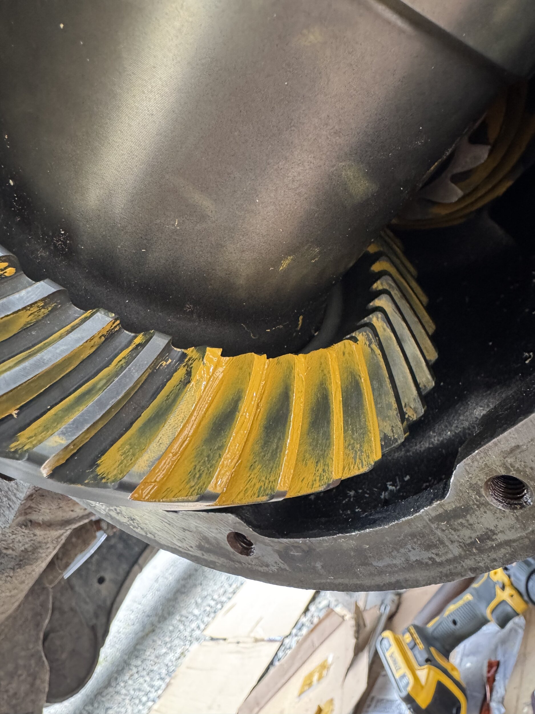

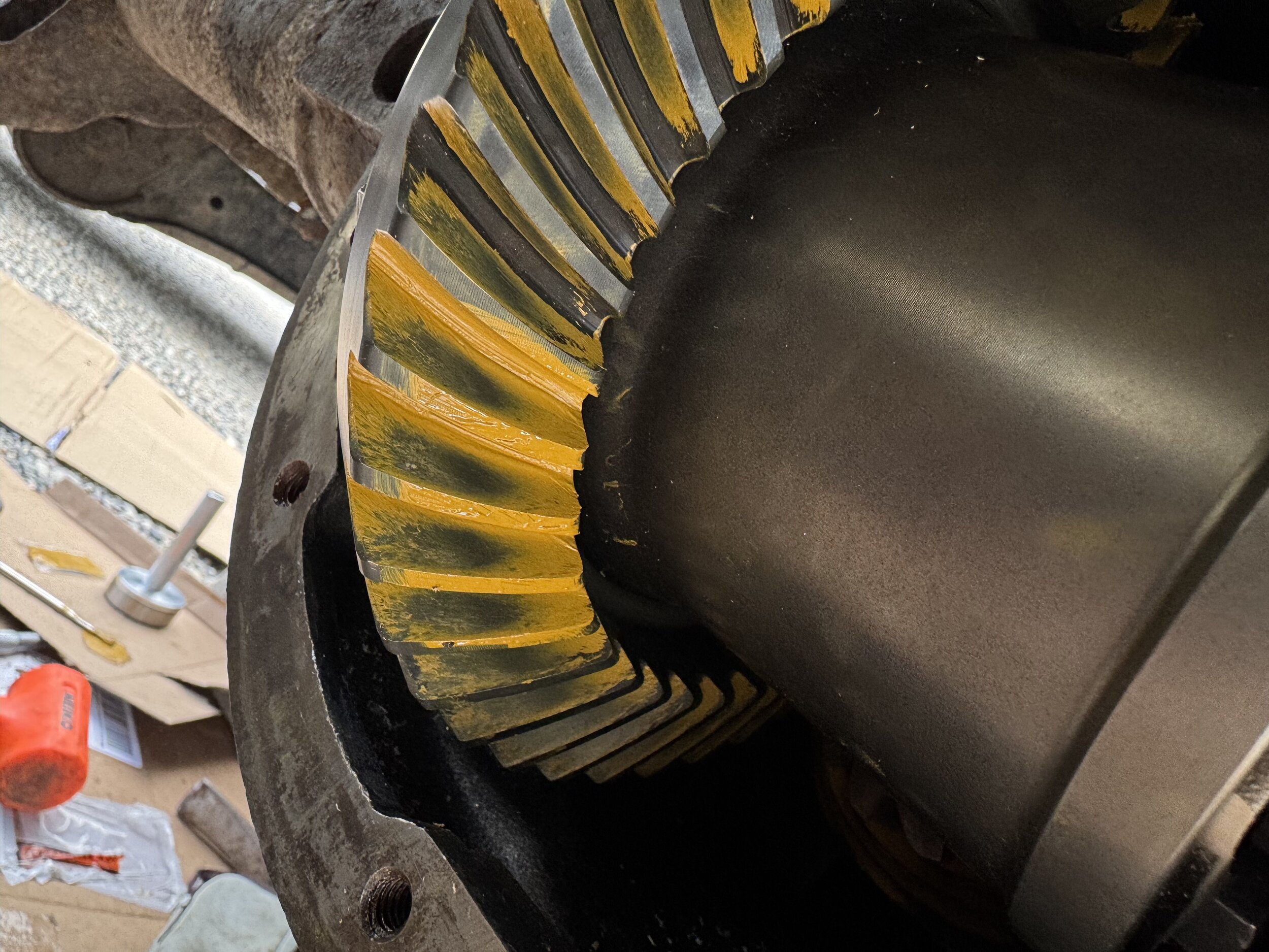

D delawarejake New Member Original poster Joined Aug 19, 2025 Messages 9 Location Idaho Sep 14, 2025 #3 Now going back through photos I’m second guessing and feeling like it’s too deep. Here’s a photo of 0.031 And this is 0.028

hosejockey61 FAFO Supporting Member Ride of the Month Winner Joined Apr 9, 2020 Messages 4,429 Location Parker, CO Sep 14, 2025 #5 delawarejake said: Now going back through photos I’m second guessing and feeling like it’s too deep. Here’s a photo of 0.031View attachment 643090View attachment 643091 And this is 0.028 View attachment 643092View attachment 643093 Click to expand... 28 is too shallow, 31 is runnable as is the 35 you posted. If you want to be 100%, run one at 33 and see. It is runnable as is though.
