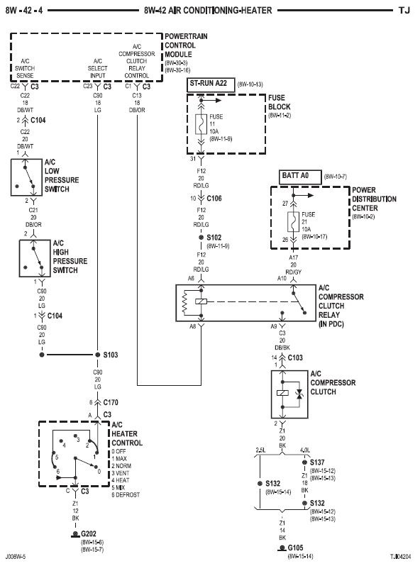

Hello Everyone! Thanks For The Opportunity To Meet With Awesome TJ Owners! Look Foward To Getting To Know You All! Just bought my first 20001 jeep wrangler TJ . Took dash face off today to examine toggle switch running fan for heat and a/c. What a mess! I dont even know where to start to diagnose the mess i found! Hope you all can help me. Fan control switch fried, air selection seitch has been very hot where 3 wire come into back of it! Currently one speed on fan bypassing fan control totally. Thanks for any guidance you all can offer.

@Jerry Bransford may have schematics and the FSM to help you out since he seems to have everything TJ.

Thee are four wires that i think control current or fan speed need to know where to reconnect to new switch . 4 to five spades on back of switch? Which color goes to each spade . Thks
