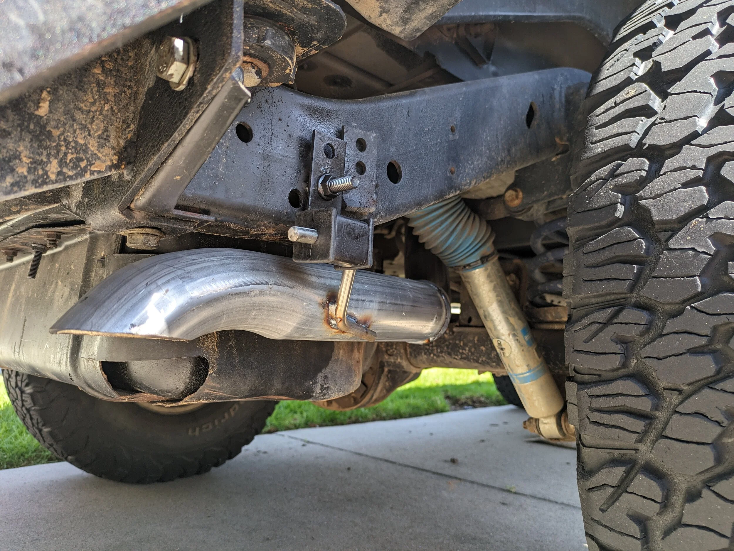

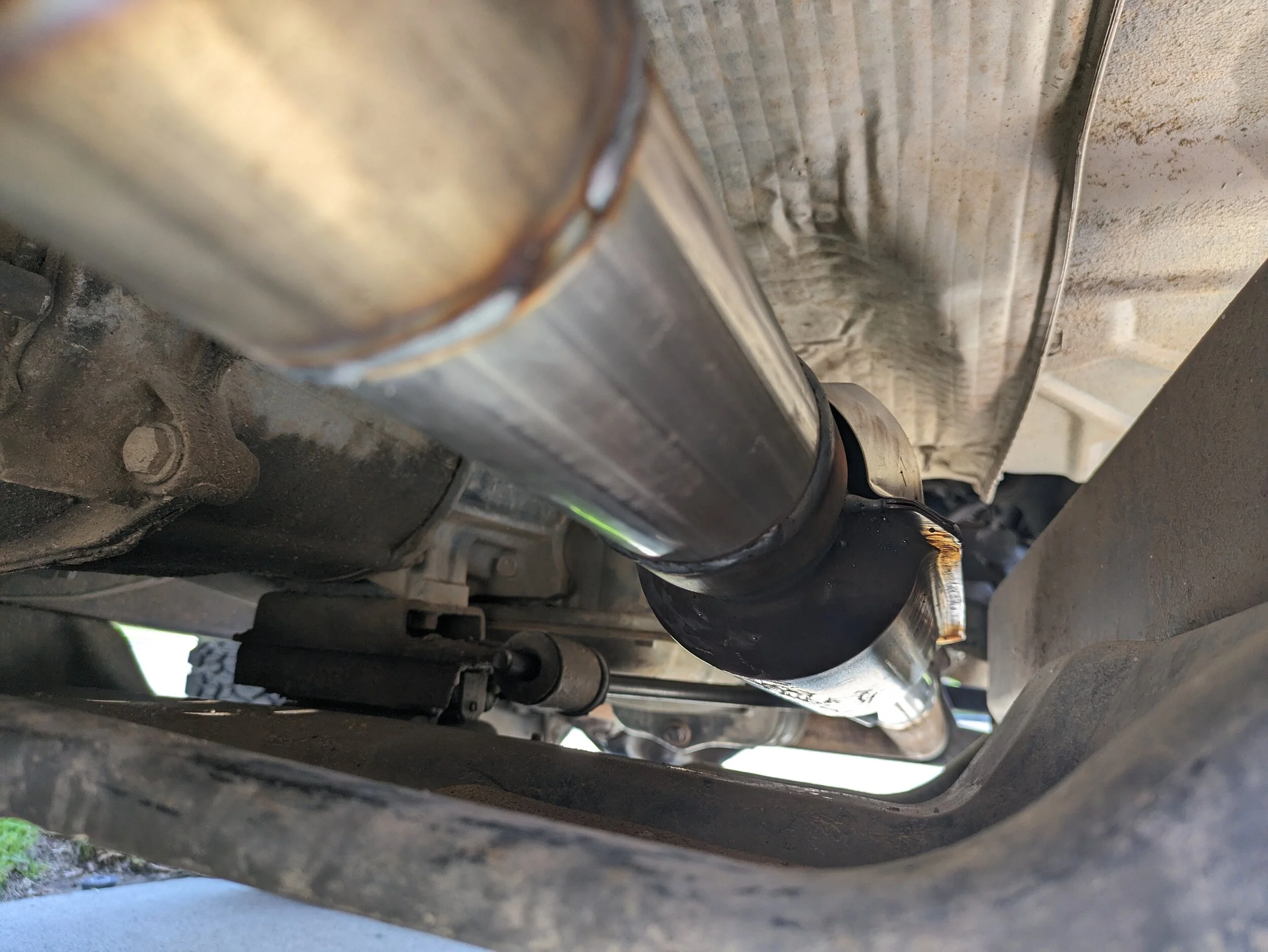

I also bit the bullet and had a new cat, muffler and tailpipe installed today. While not cheap I'm very happy with the new exhaust. Catco cat and new Magna Flow muffler installed by a local shop here in OC. They do great work, plus the owner has an LJ http://ocmufflerman.com/.

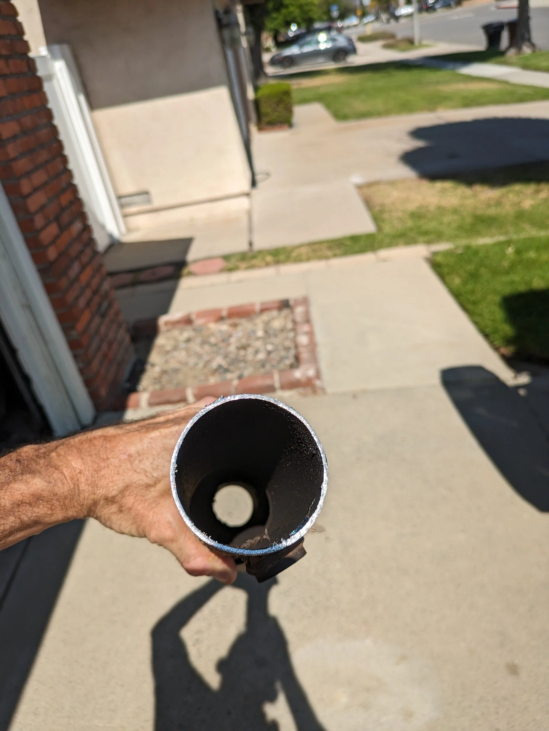

Here's a shot of my cat, it's a high flow version apparently!
