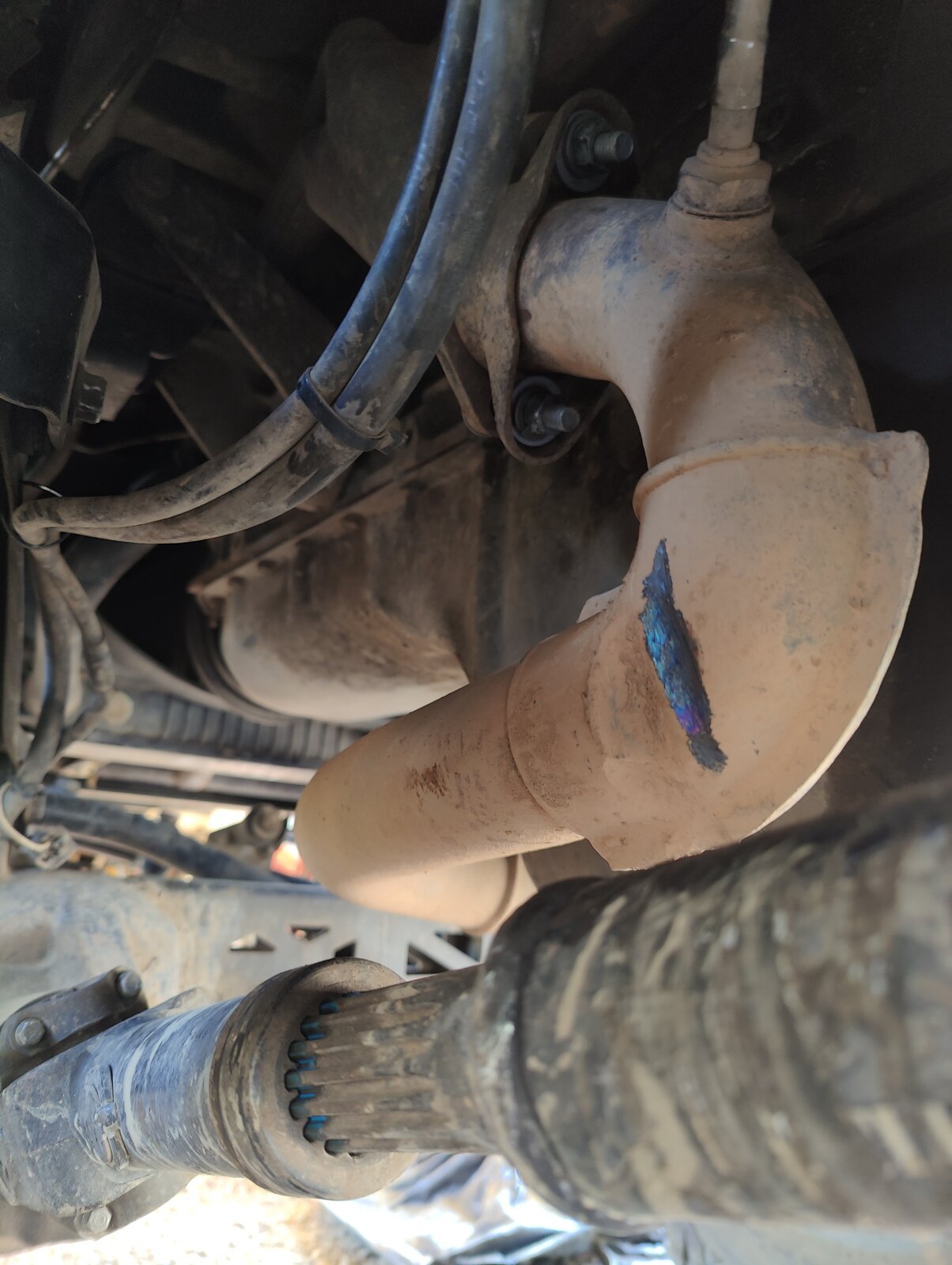

My down pipe/mid pipe is making contact with my front driveshaft. I looked the exhaust and jacked up on the passenger side and tightened things down and probably got an 1/8" of clearance.
I'd like to have more. I want to add an expansion joint as it wraps around the front, and a v band clamp just under the skid plate...then wrap the pipe in DEI exhaust wrap to maybe keep a little heat out of the oil and floor.

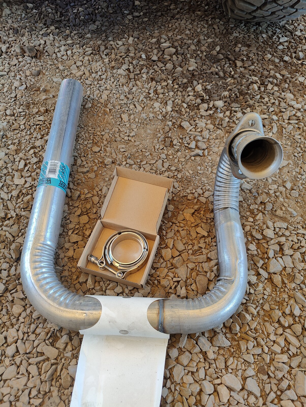

I bought a walker mid pipe. I don't think it solves my clearance issues and I don't like the bends.

Is there a mid pipe commercially available that kicks passenger a half inch or more straight down from the donut flange for the headers?
Totally down with welding my own. I'll probably get a hardwire roll of stainless for my MIG...would love to TIG, don't have the right toys.
Anyone have a good source for stainless parts? The flange and a mandrel bent builder kit? I think this is 2".

Is that elbow corner an inner and outter casing and maybe I can remove the outter for more clearance?

I would wait till you change the mounts and skids as the exhaust will move up. I just did my tail pipe after the shock outboard and track bar mod.
I used some u bends from speedway auto. They are a good supplier. Cut, fit and weld where ever you want the pipe to go.
