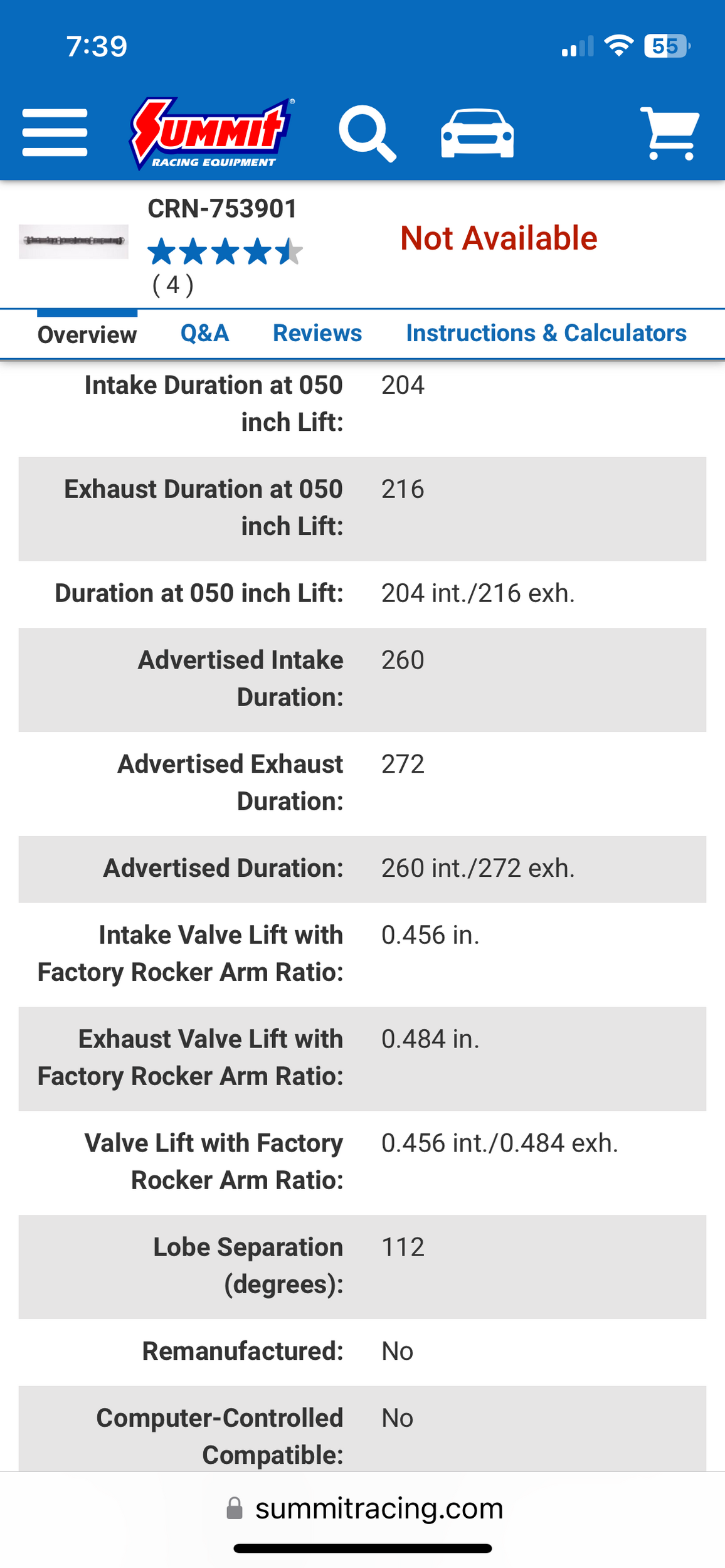

If they were still in business, this was a great cam that didn’t need to reprogram the pcm, ran 3 in different motors, a 258 with the carter carb and one in a 4.0, and the last one was in my 4.7 stroker. It just worked across all power levels.
I ran this spec cam in a 350 4 spd. K - 20 , it is a great no B.S. truck cam .
