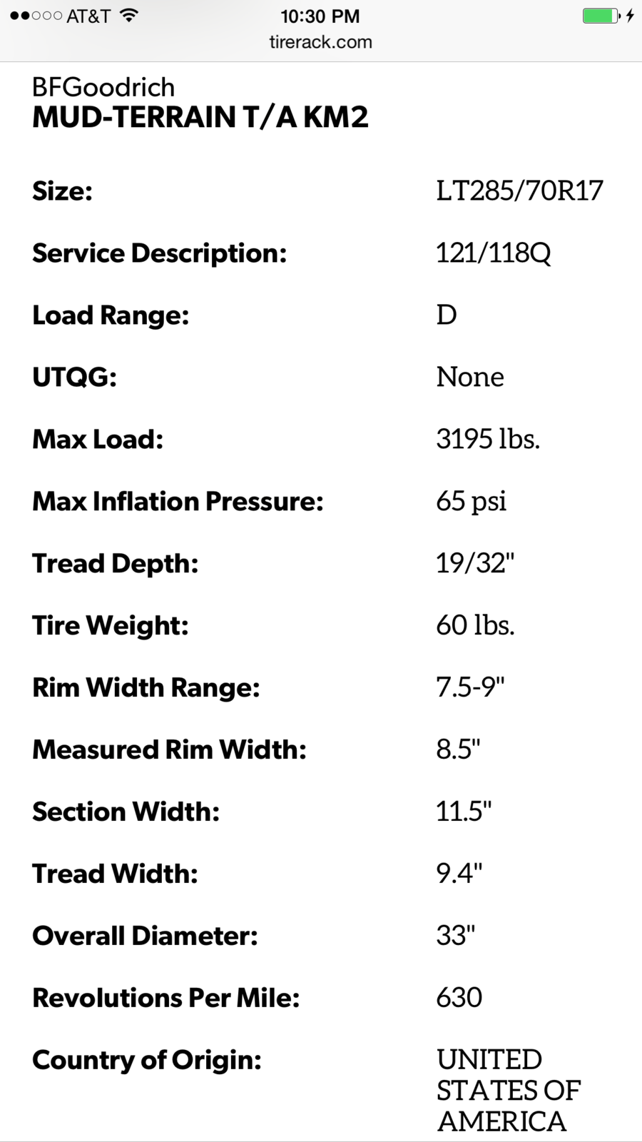

If I lived were it snows maybe Duratracs would be my choice ,but down south we have a lot of mud gumbo type so you need M/T that's good all around ,I'm happy with BFG KM2 it's D rated here's the specs
