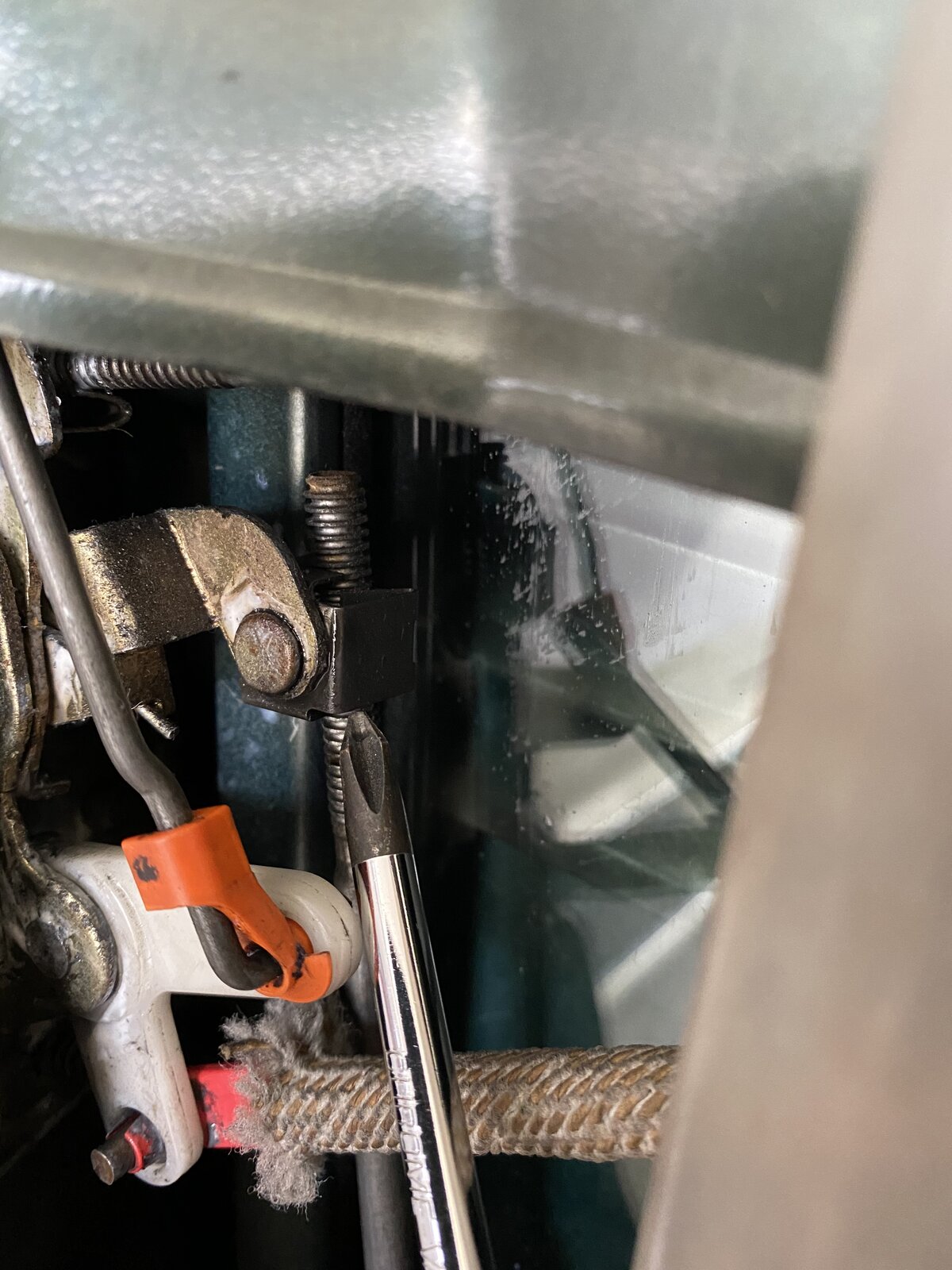

Ok everyone,
My body shop buddy found the issue, kinda by happenstance on one door and then that gave us the solid answer on the other door. There is a threaded adjustment rod inside the door panel near the latch/lock mechanism. The adjustment of this rod affects how stiff the door paddle is (or how far the paddle moves when you open the door). Because the handles/paddles I replaced were old, worn, and loose, when I put the new ones in, the adjustment of that rod was too aggressive for the newer handles. Maybe this will help someone down the road. I will attempt to attach a photo of the rod.

This is the door handle adjustment that can keep your doors from locking, unlocking, or opening.

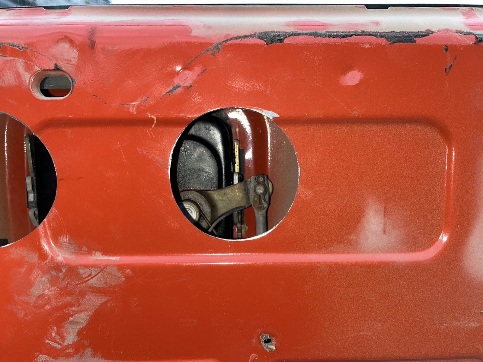

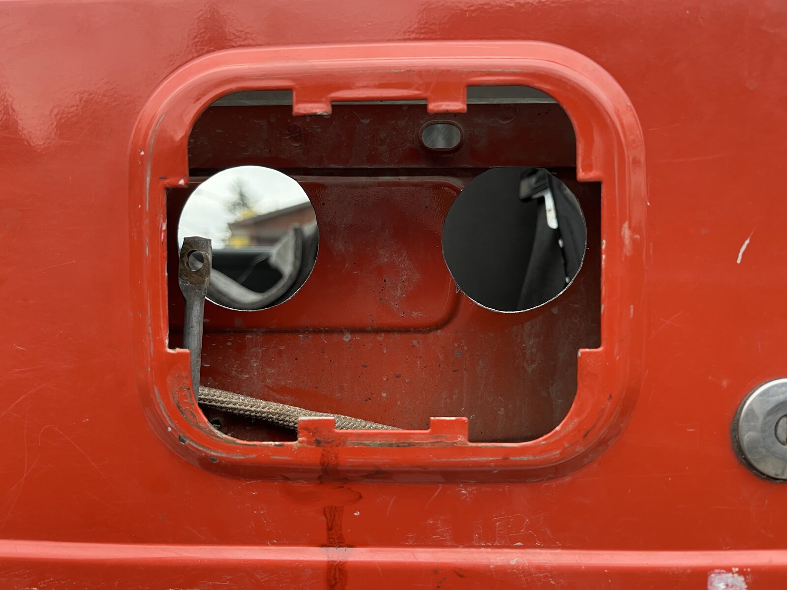

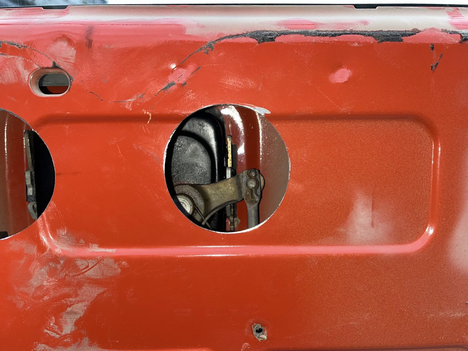

Same, just did this, a bit of lube makes a huge difference but getting access is painful.
After taking it apart I drilled 2 holes to get better access,
Now it will be simple to lube the latch every year.
My intereior lock/unlock mech was also sticky, same thing after 17 years it was due for some lube. Works like new now.
