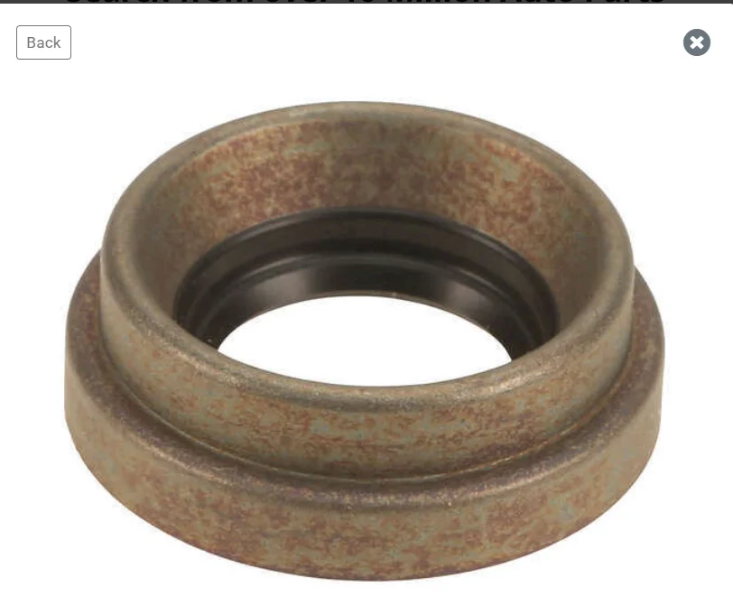

I was curious as to why this would have leaked. Looking closer at the silicone smeared around the seal, I noticed that the sealing ridge seemed to be at the very edge of the silicone that got wiped off as the seal was inserted. Taking a close look at it, it appears that the sealing ridge around the perimeter of the seal never actually reaches the bore. It sits in the bottom of the chamfer on the axle tube, but not compressed into the bore. I believe this is the source of the leak, as everything else seems fine seal wise.

@mrblaine sent over, and he saved my bacon by sending 2 sets of seals. One set was Timken, and the other was Spicer. The Timken seals for whatever reason were and extremely loose fit. Easily slipped into the bore with no friction. These would have been the same as the ones I ordered elsewhere. The Spicer seals were a nice fit though, and comparing the location of the sealing ridge on those, the ridge was inboard .030" more than the seal I removed, so it will engage the bore. So I chose the Spicer to install.
