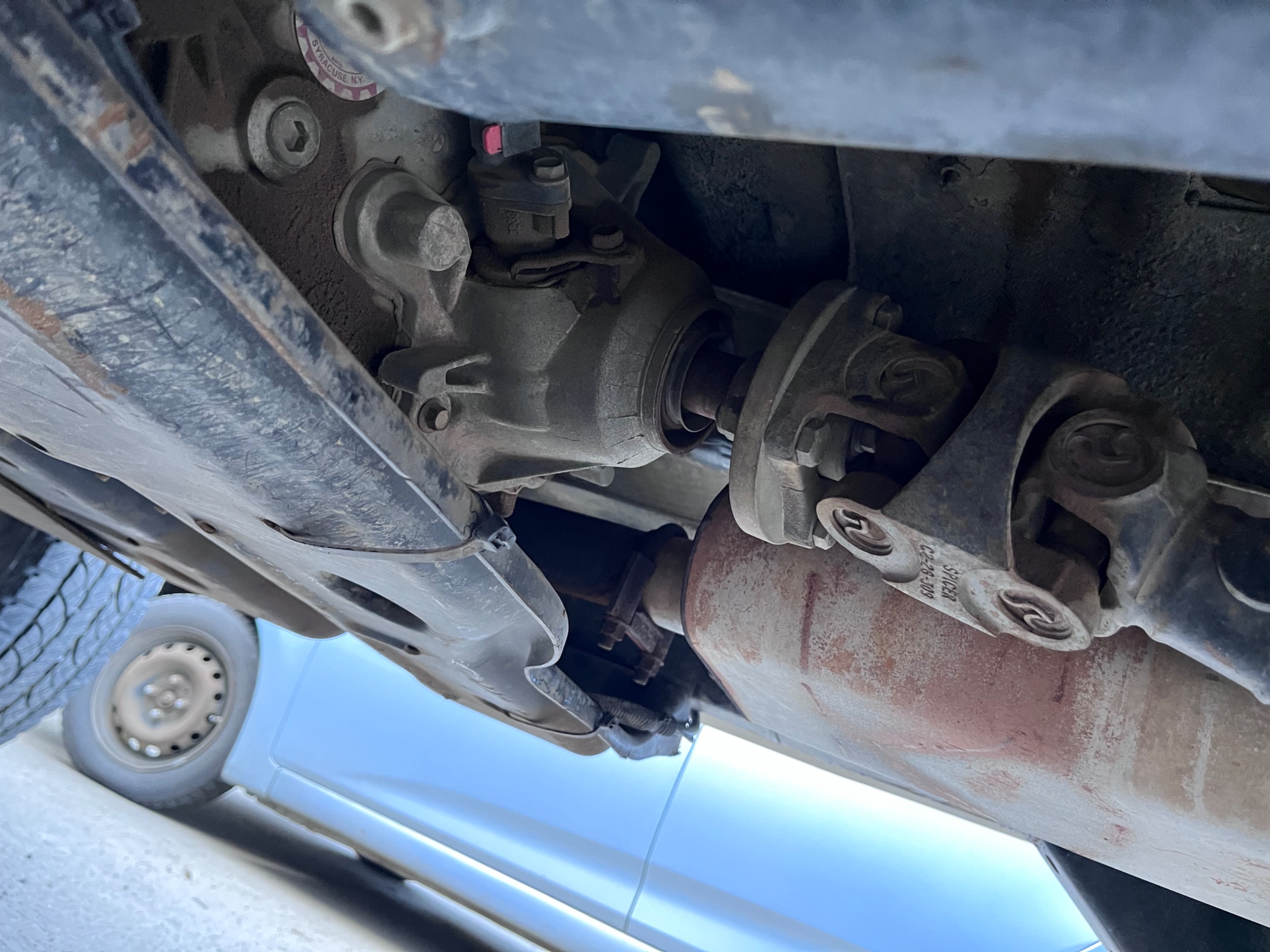

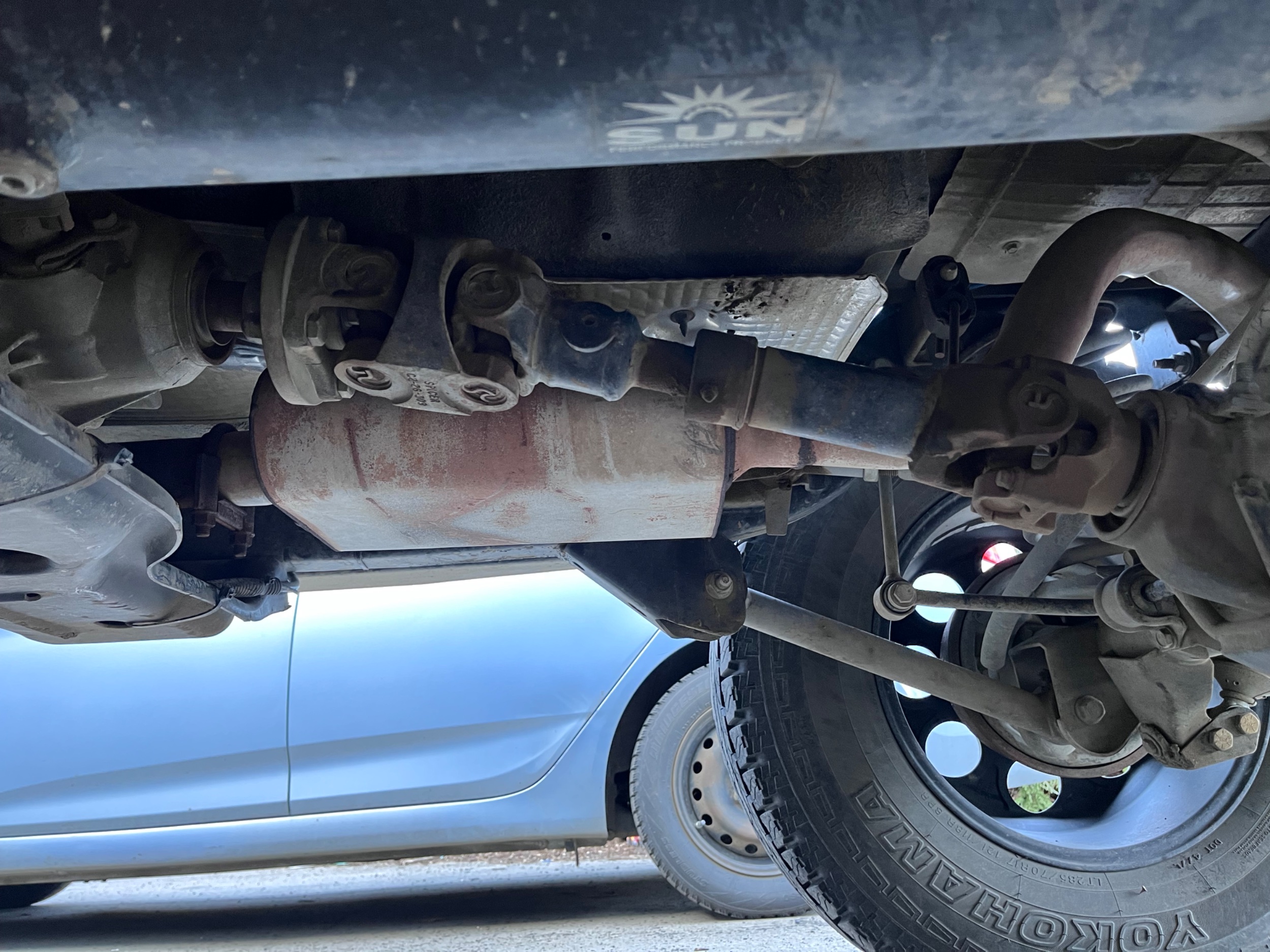

So i just got this jeep a couple weeks ago. It has a 3.5” rubicon express lift. Im figuring out what all mods have been done to it, and looking underneath it appears to have a double cardigan drive shaft. Not sure if thats a slip yoke eliminator or not. Didn't see a drop on the transfer case (maybe im not looking for the right thing).
Bonus points, you also appear to have extended shock mounts to keep your shocks from hitting the coil seats on the axle due to the housing being rotated rearward for the DC driveshaft.
