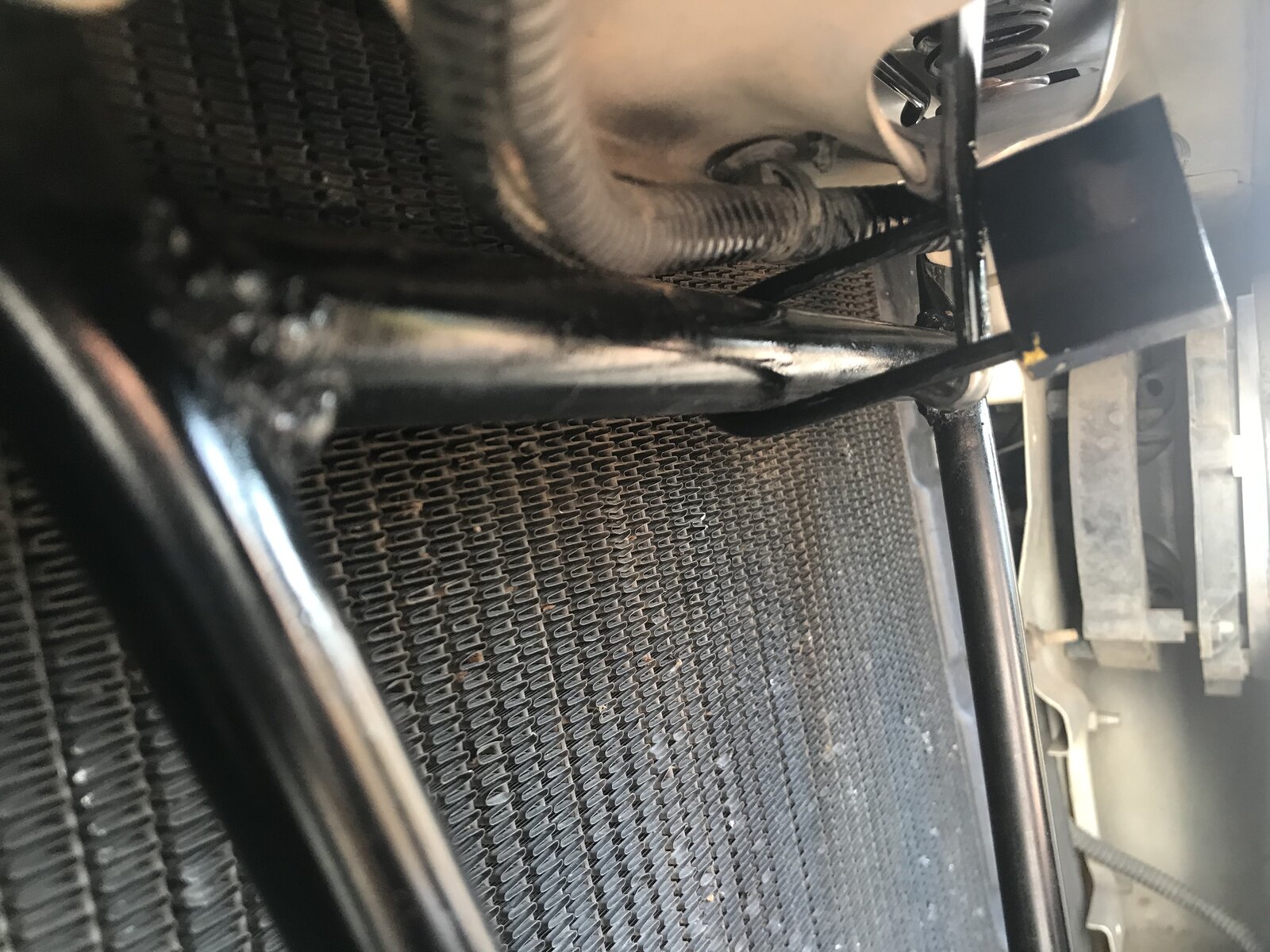

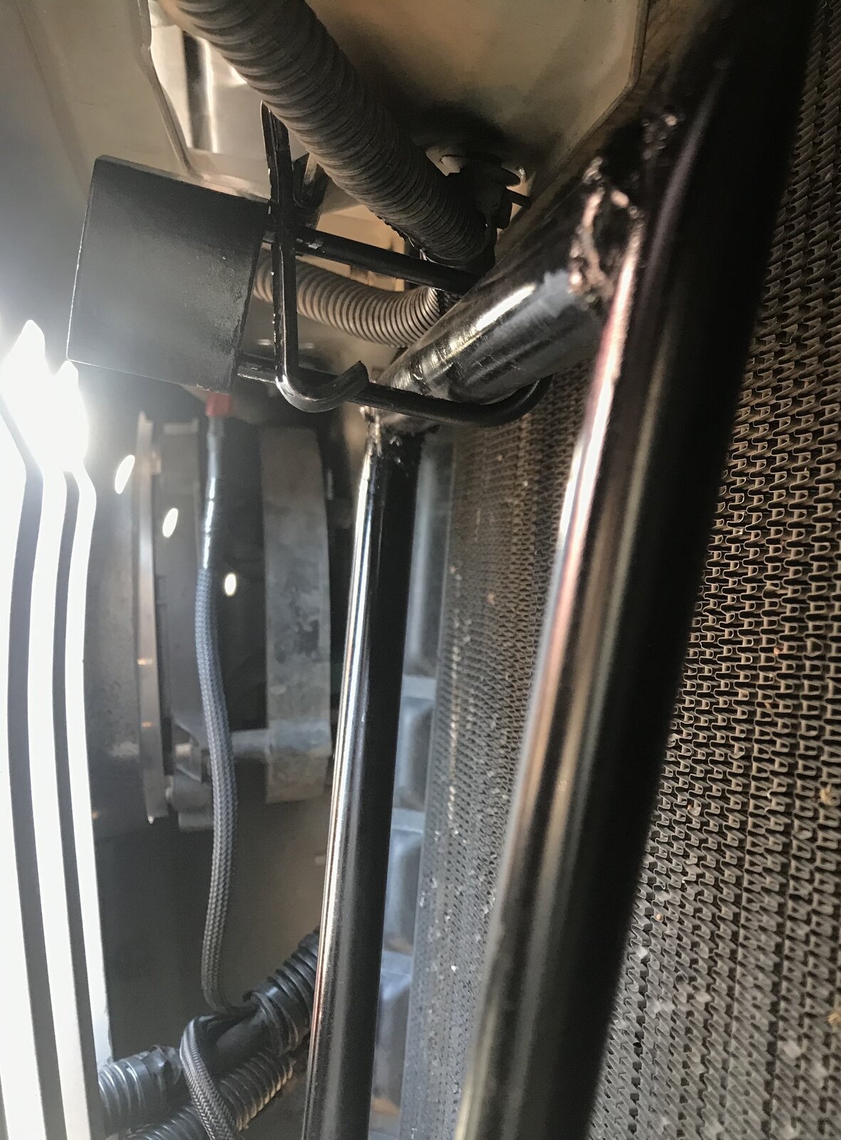

Remove the 3 screws from the “V” shaped bracket inside the grill and remove the bracket.
Cut the 1/2” metal bar to fit inside the top of the bracket. Sand the paint from the bar and bracket and weld together.
Drill a hole in the latch for the lock.
Paint everything black and install.
Lock goes through hole in latch, and around metal bar to secure the hood down.
