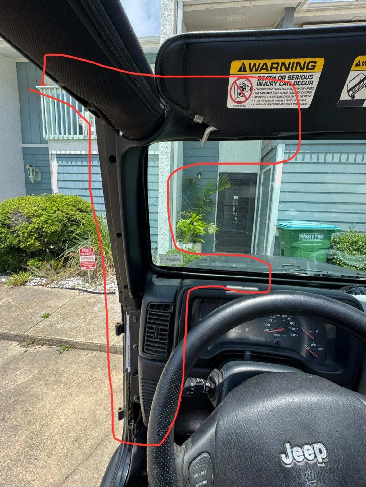

Any help or suggestions are much appreciated - I've read just about every post here that mentions rattles and haven't had luck finding this one..
A few things I've figured out & tested:
  • Removed doors, plastic door surrounds, soft top, top dash vent, and the plastic A Pillar cover . . . rattle still exists (almost louder after removing A Pillar cover)
  • Have tucked towels into various openings to stabilize cables under the dash, etc . . no luck yet
  • Always happens on small, quick bumps, washboard roads . . can be going 5mph or 75mph
  • Tightened all visible screws & bolts, checked dash speakers
  • Rattle occurs on both driver & passenger side, which made me think defrost vent/HVAC. But have used towels to wrap and doesn't go away
I've recorded a couple videos holding my phone near the dash to capture the rattle/clicking sound below:
It sounds like it's coming from somewhere inside the A Pillar, roll bar, or edge of dash:
(2004 rocky mountain edition if it helps. Thank you all!)

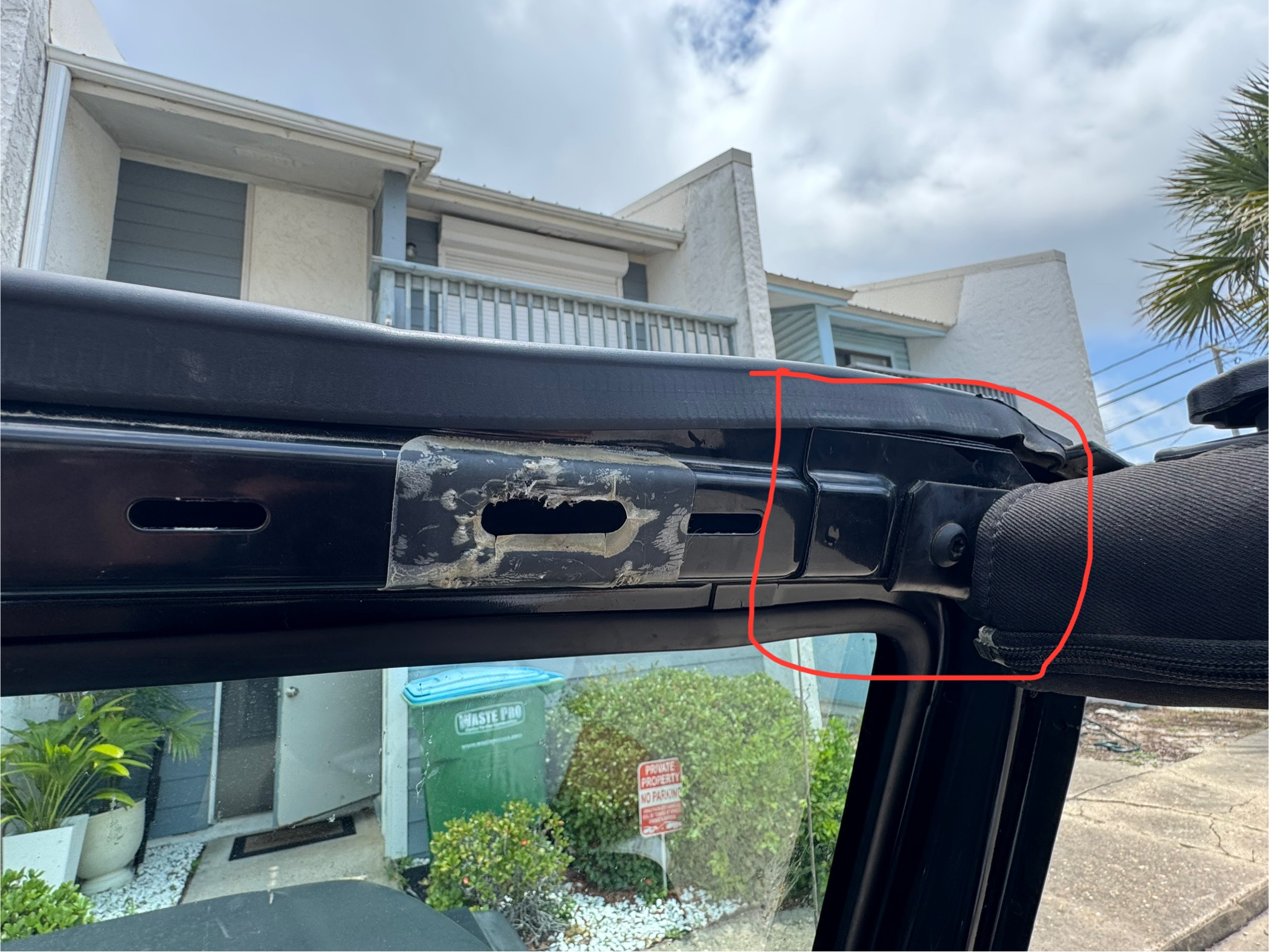

Finally able to recreate & identify the rattle (video below)... narrowed it down to this weird metal overlap / rollbar connection and can't quite figure out how to tighten more than it already is. Does anyone have a possible solution for this?
When driving, I can pull down the top of the windshield (towards me) and the rattle stops
There's a plate behind there that engages the bolt...I messed with mine forever...ended up tacking it to the windshield frame in a couple places so I could chase it with a tap...then ground off the taps.
-Mac
Reactions: beachjeepRME
-Mac
Decided to take the opposite approach first and barely loosen the bolts to see if it’d relieve pressure - it’s solved for now.. No rattles after a couple test drives. Might have to go your route in the future if it consistently comes back.
