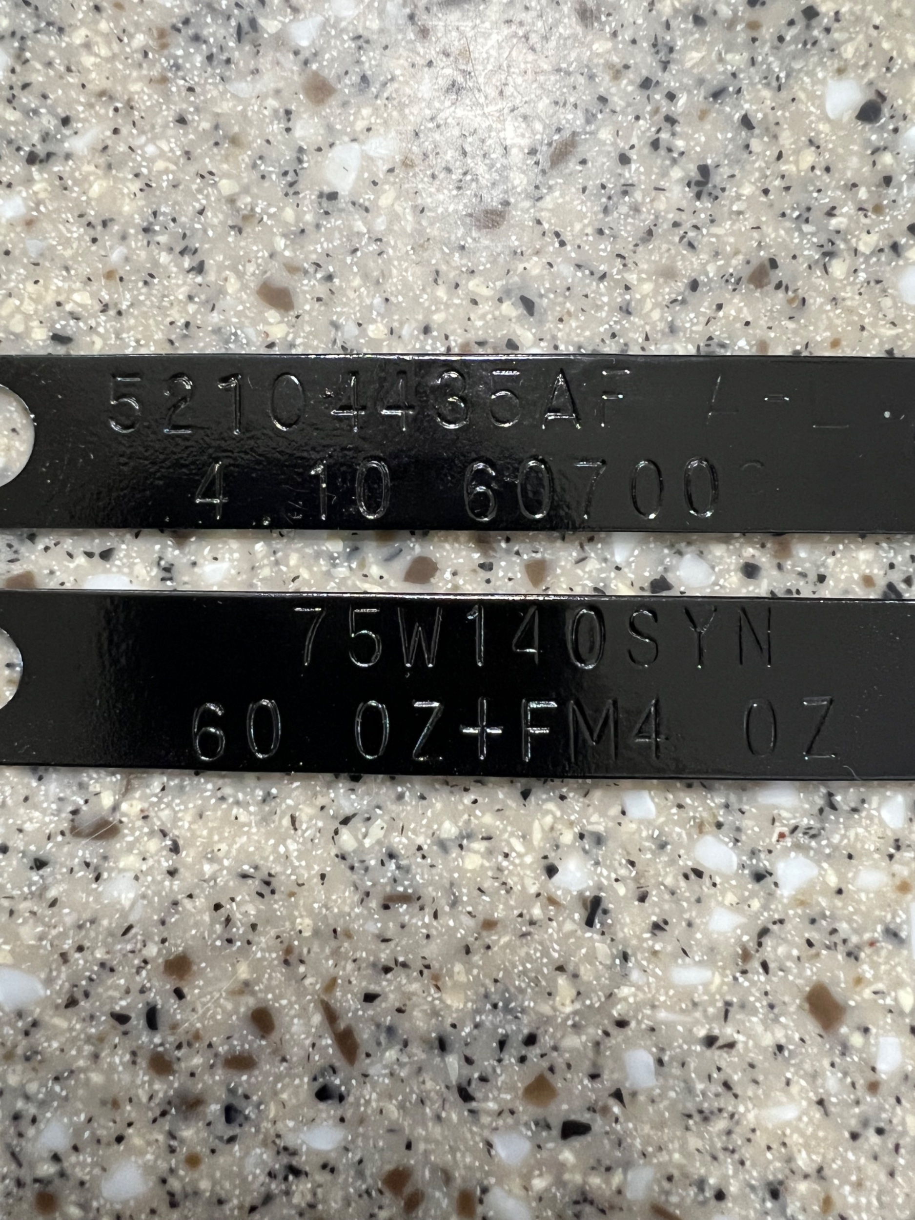

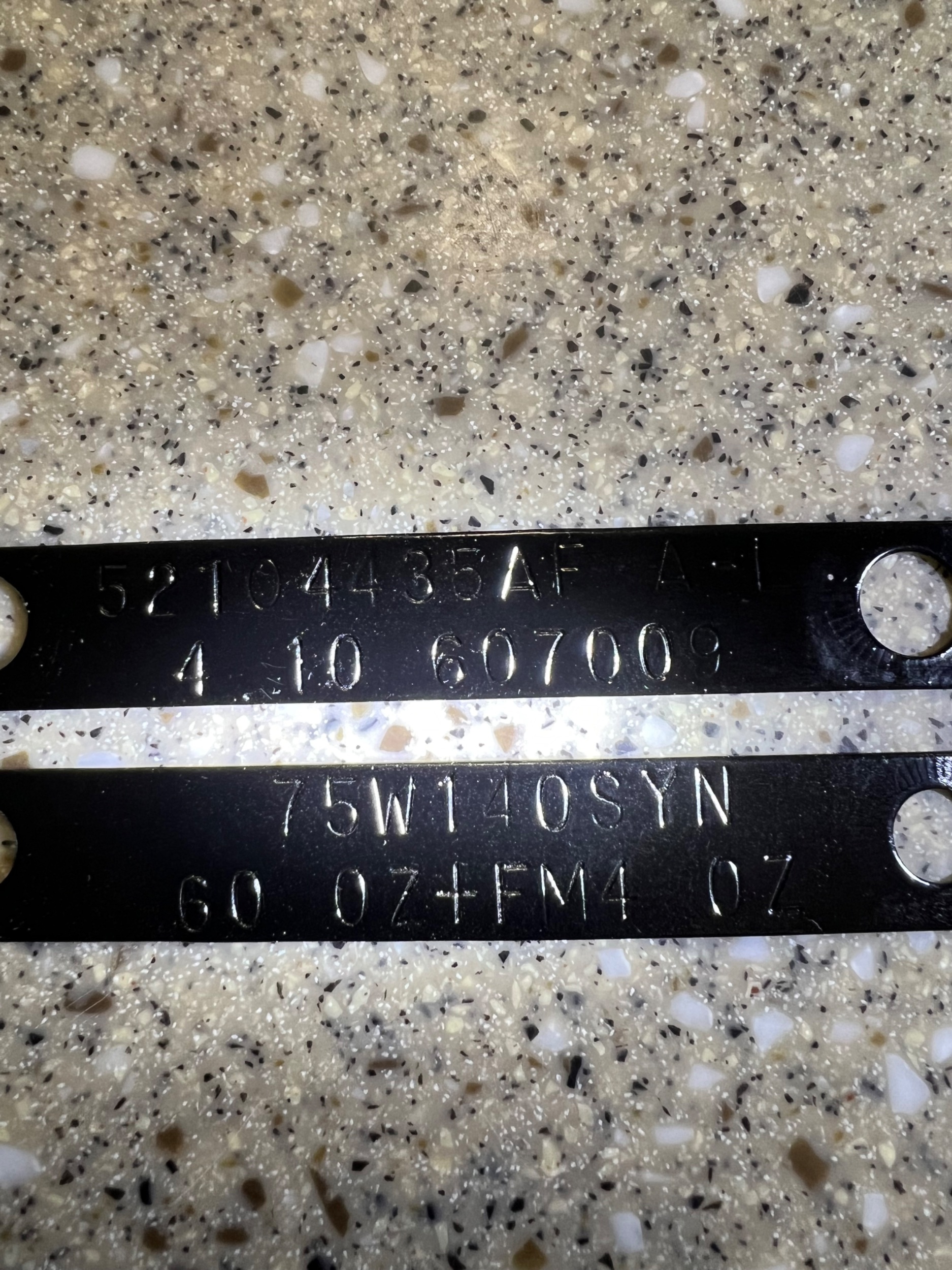

Hello jeepers, I’m new to the forum. I Just purchased an 04 TJ and I’m changing the Dana 44 differential fluid. The metal tag on the diff cover seems to be different from what the manual says. I won’t be doing any offloading but just want to put the correct fluid in it. Can anyone give me some advice?
The Rubicon rear diff specs the 75W-140 synthetic. No LS additive required as it is a helical gear limited slip, but it won't hurt if the fluid already has the additive.

welcome to THE BEST DAMN JEEP FORUM IN THE WORLD ! Post some pics of your Rubi. Use the one that Rubiconned said and you'll be good to go. congrats on the new purchase...
Follow the manual.
80w-90 is fine if you don’t tow. If you occasionally tow use 75w-140.
