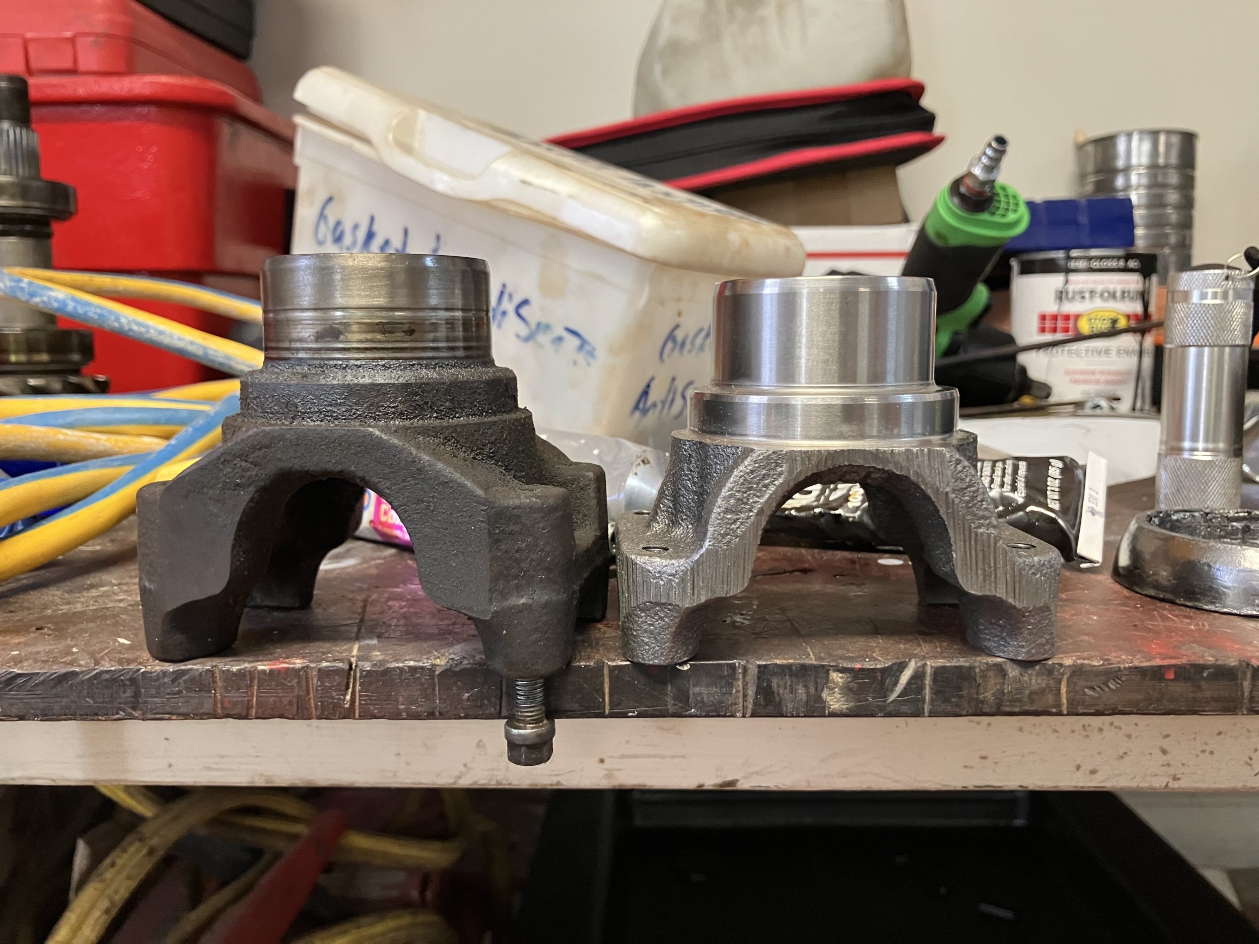

Got my first batch of parts and tools today. I ordered a new Dana Spicer yoke but it seems like a toy compared to the original. I am going to return it and have ordered a Mopar one. Here is a picture comparing them.
You're right that the original yoke had deep grooves!
I wouldn't worry in the least about the new yoke.
