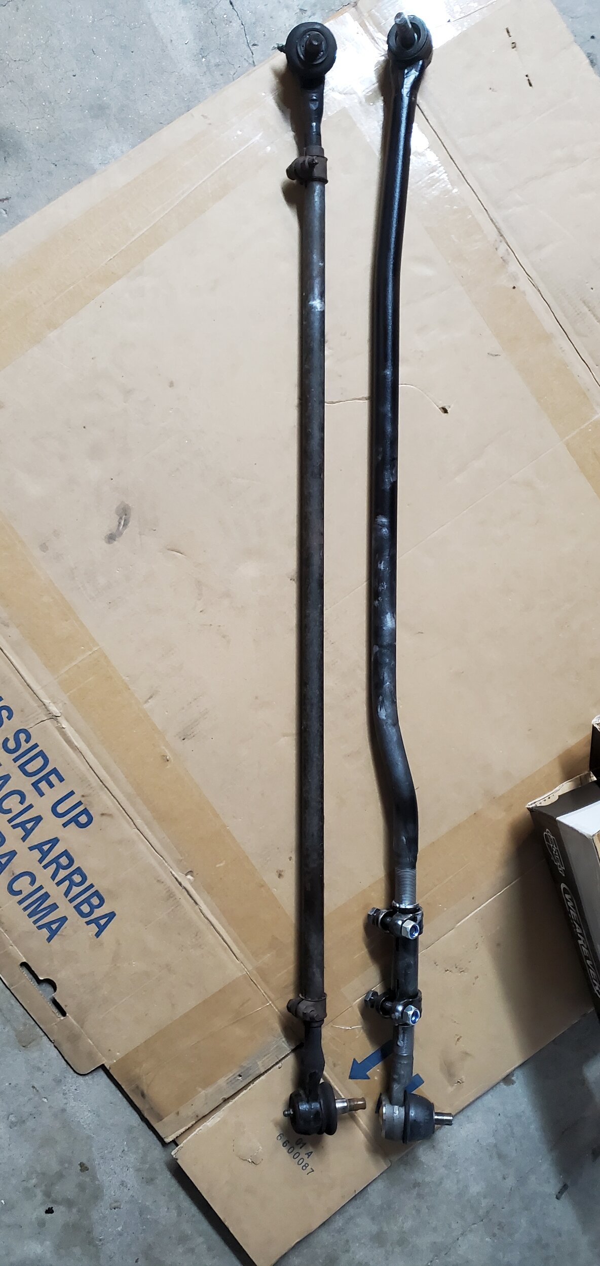

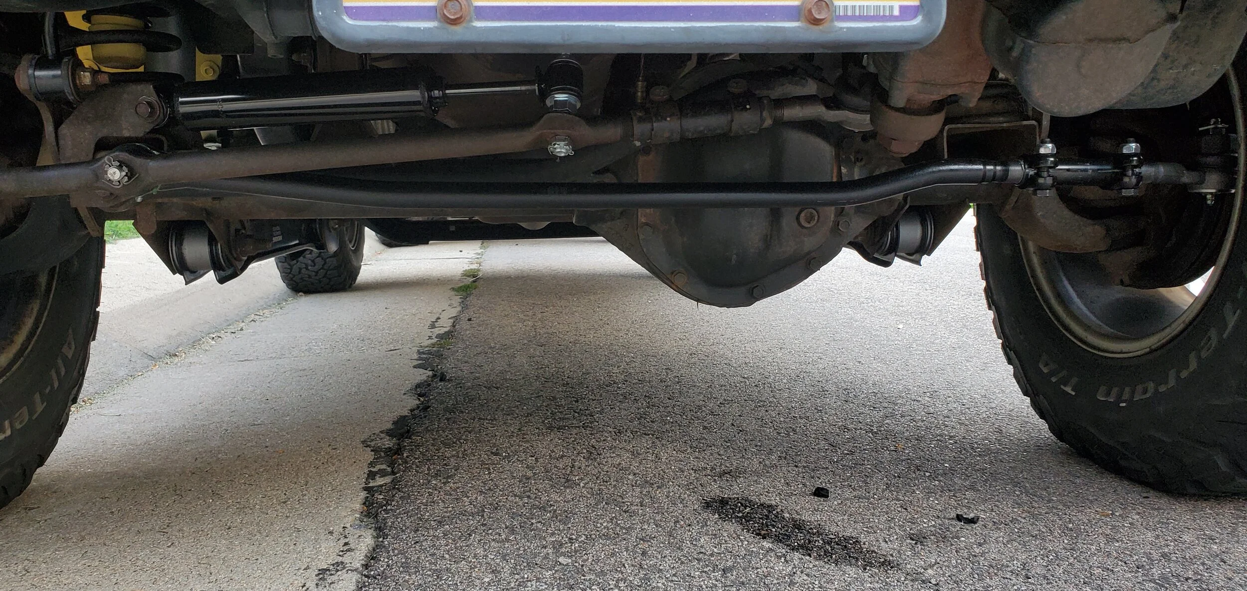

I wanna put the Currie in but I am not doing a lift till Spring will it work with a stock height Rubicon?
You can with the clearance things mentioned above, but it won't in itself cure the death wobble and costs about 4-6 times as much as the trusty ZJ V-8 mod. I just did that on my Dad's stock LR Rubi yesterday and mine quite a while ago. Solid steel and larger diameter than the stock parts. I also put a fresh tie rod end in at the pitman arm side of the drag link. His drag link joint was is good shape so I left if be.
Reactions: Intimnasc
