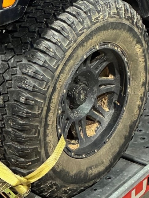

That’s a good price, even if you have to do some engine work, but I don’t know about it being babied. By the looks of that, I’d definitely scope the frame and see if it looks like that in there. I’d drill some drain holes in the frame and wash it out with a water hose at every opening you can find.
I live in SC too and that looks like the sandy/muddy mess that most mud holes have.

Yeah the guy said he was driving it through his fields to do something with the cows he had. He said he hadn't been off roading with it and that he knew the owners of it for 15 years before he got it a year ago. He seemed like a real straight up guy but who knows. I'm def gonna inspect further but I did look at some of the holes in the frame already and they seemed solid
