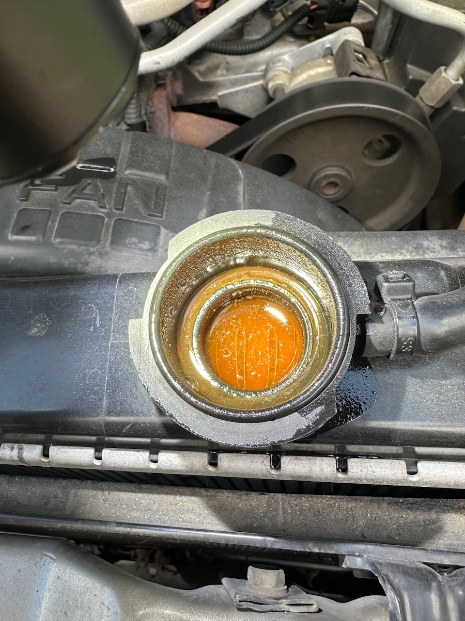

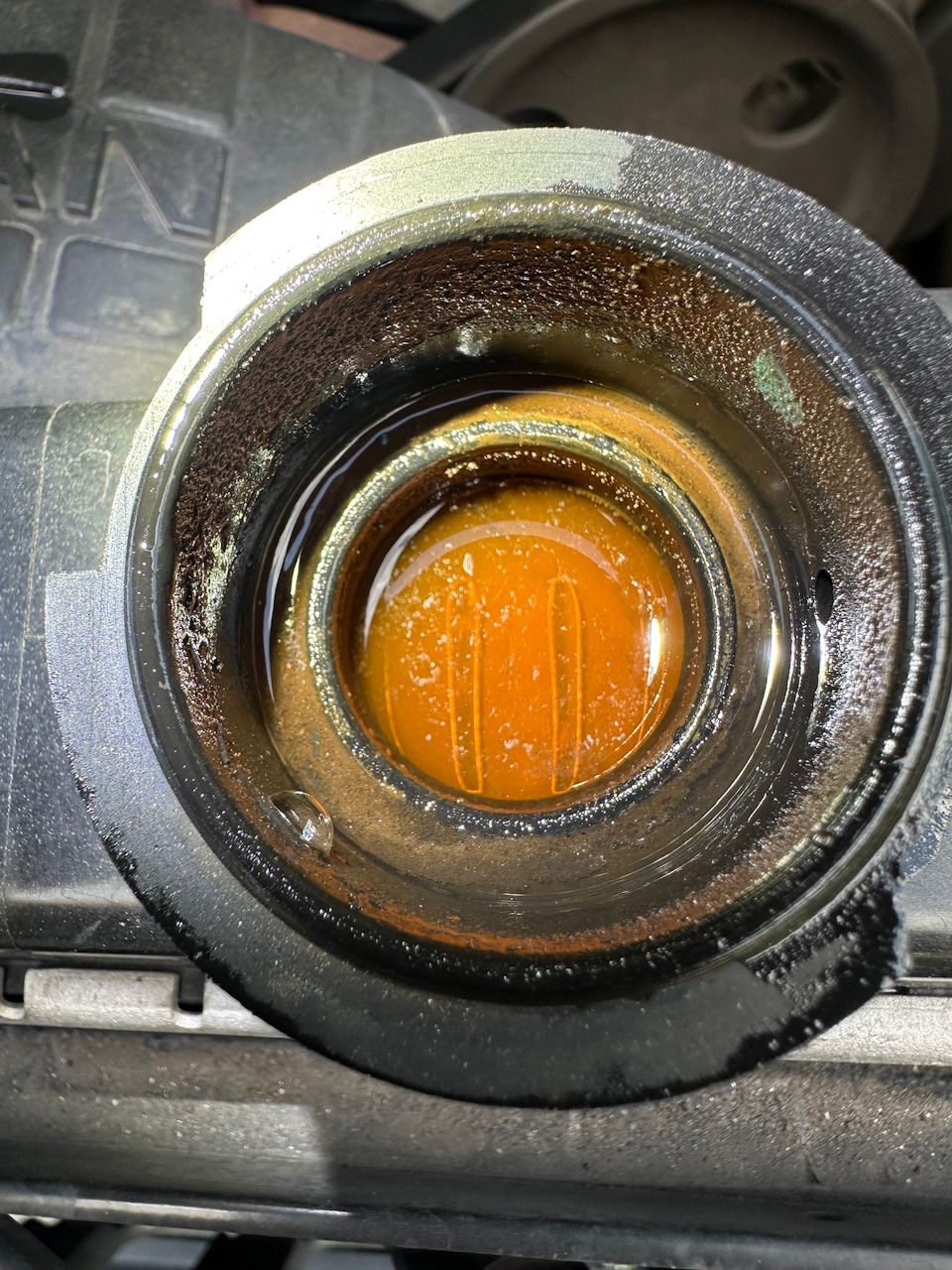

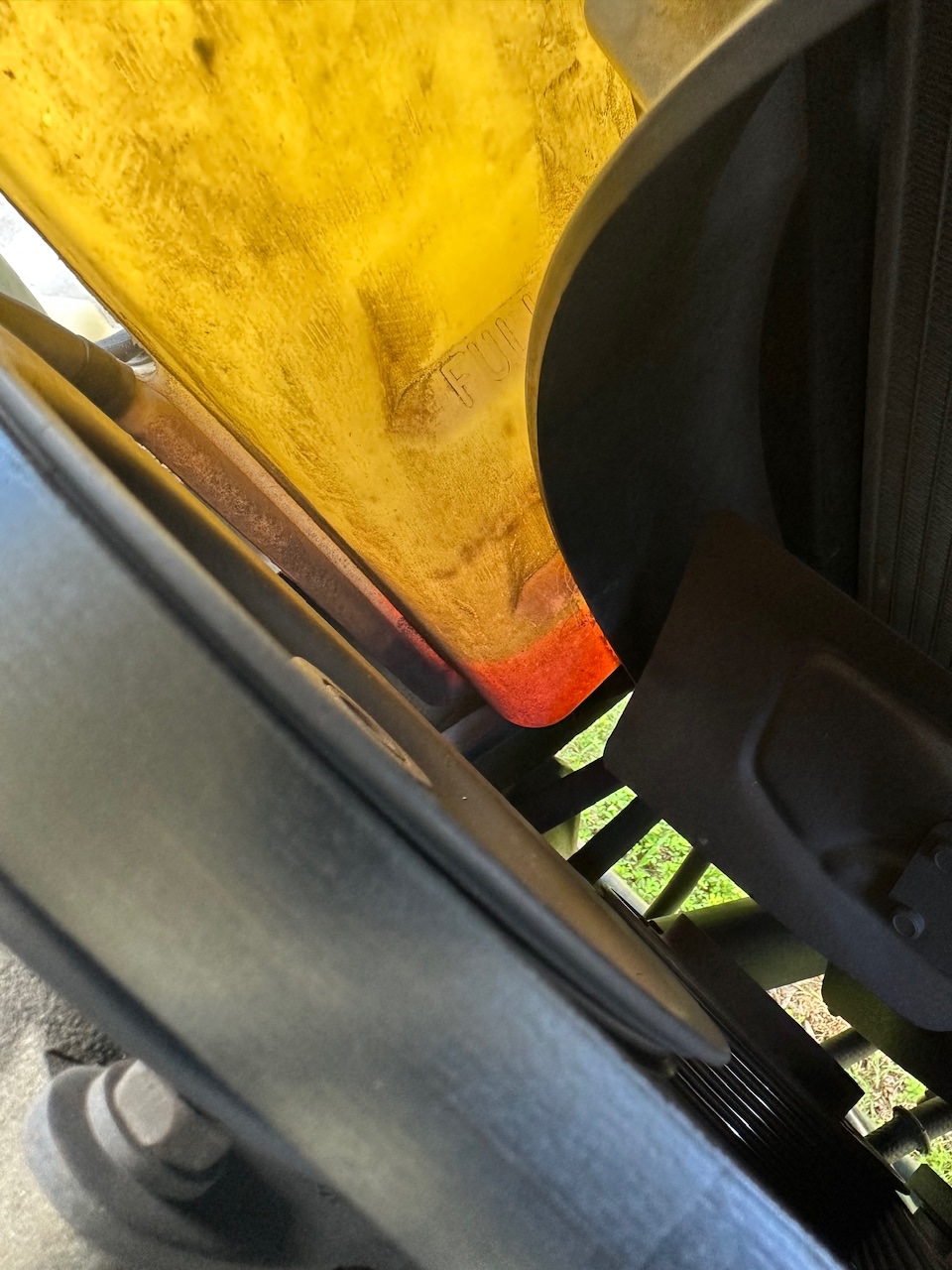

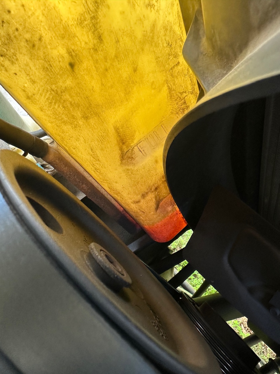

I have a 2002 Jeep Wrangler 4.0 that I purchased early last year. The guy I purchased it from was an auto tech for a Chevy dealership and said he just replaced the radiator in it before I bought it because it failed on him. He mentioned he changed it in a fast food parking lot and used coolant from advance but never mentioned what kind. It has been an extremely reliable and fun toy for my wife and I! I was going over fluids the other day and realized the coolant reservoir was a little below the add line. From what I can tell by shining a light through the top of the reservoir the fluid looks orangish-red. I’d like to top off the reservoir but unsure of what to use. Here’s what the coolant in the radiator looks like. I believe these call for Zerex G05 which has a yellow tint to it so I don’t believe it’s that but not 100% sure. I’m beginning to wonder if I should just flush the system and add new. These pictures were taken on level ground with the Jeep sitting overnight so it was nice and cool.

Is the engine running hot? If not running hot, why would you do a flush because of the color? Peak ,Prestone and others are all different colors. I have seen green, orange, yellow etc.. I would buy a tester at parts store and be more concerned with the mixture. 50/50? 100% glycol? and what temperature it will keep the engine from freezing. Wal-Mart https://www.walmart.com/ip/Prestone...=sem&msclkid=5eab65310693126aece00d7ce483d575

It does not run hot whatsoever. Like I said I was just wanting to top off the reservoir but unsure of what coolant is in it.
Because he has no idea what the guy put in there and mixing coolants leads to trouble. Especially Dex Cool which is what a Chevy guy would get at work.
While true, he did mention to me that it failed at a fast food drive-thru and he changed it there in the parking lot and got coolant from an advance auto next door to the restaurant. I wish I had a way of getting ahold of him.
Ahh, Ok. No telling what he put in. Probably some universal as I doubt he flushed it in the parking lot.

Because adding green/yellow to a system full of dexcool (which is very likely what is in his system, it doesn't look rusty. It looks red-orange like the newer Dex-Cool) does bad things. My truck had the antifreeze flushed at a Sears Auto Center in 2009, and replaced the green factory coolant with Dex-Cool. They clearly didn't do a good job flushing, and I suspect they simply drained the radiator and block and called it a day, leaving a good amount of the original green behind to mix with the Dex-Cool.
There are now permanent "pudding skin" orange deposits inside of my hoses and inside the coolant jackets. I believe this was after Dex-Cool's formula was changed so it was less likely to turn acidic and eat gaskets. I replaced the water pump, rad hoses, radiator, etc. but the coolant still turns brown-ish after about 3 flushes (and $100 in concentrate) at this point.
You NEED to know what coolant is in your vehicle, in case you ever have to top off. If you have any sort of mixing of two different types of coolants, misery arrives. If there is any uncertainty, take it from me. Drop the coolant drains, flush it out, and fill it back up with distilled water and the proper coolant for the system. It really is a nightmare when coolants are mixed.

You really can't go by color, but it appears the Chevy guy put Dex Cool in it.
I'd flush completely and put in G05.
That's my guess too. DEFINITELY flush it very well. Don't ever mix coolants. Universal coolant is probably ok but still, never mix it. I have G05 in mine.
