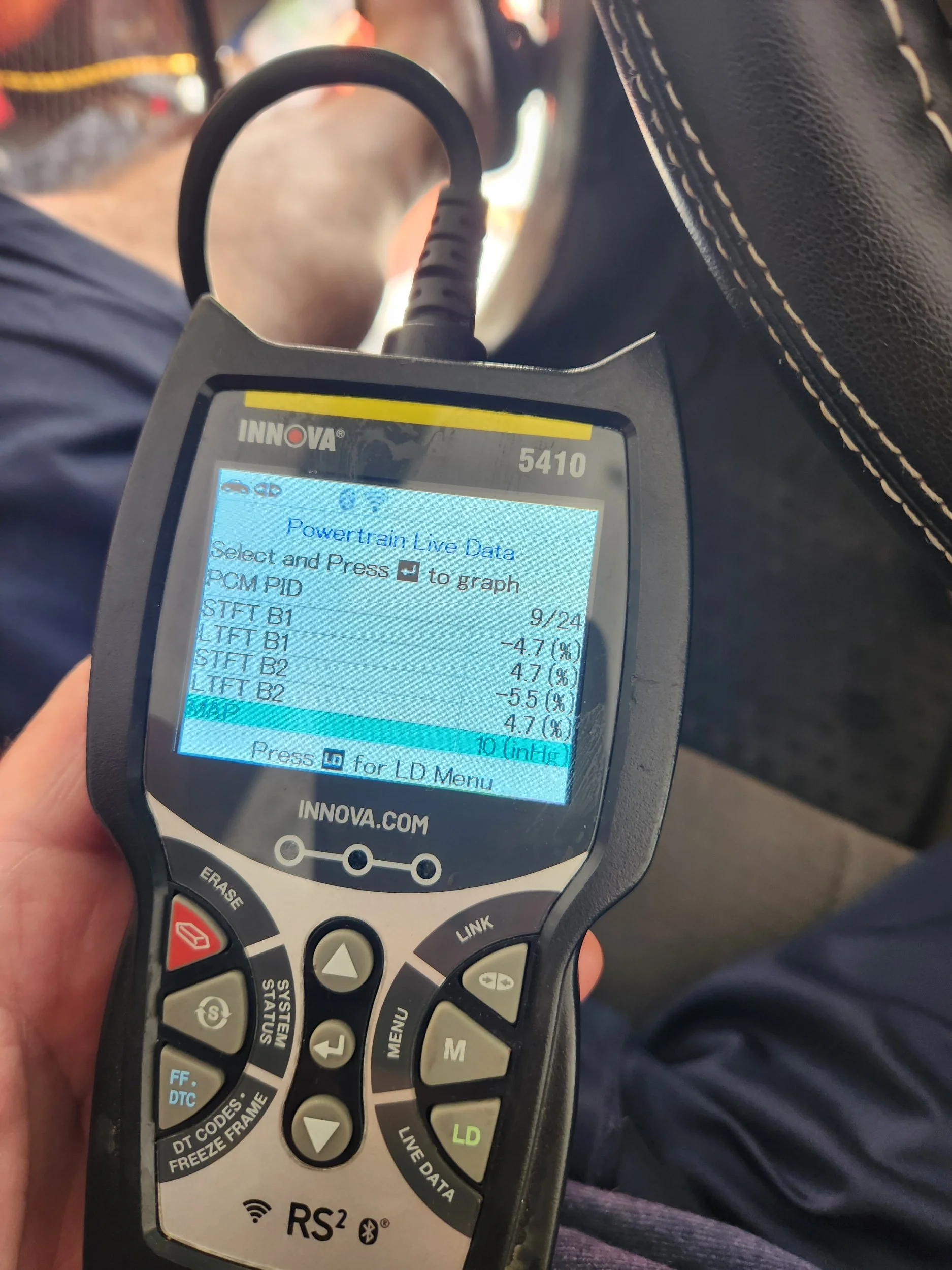

Fine, they were cracked, but trust me that the replacement injectors could be bad. Get a scan tool with live data. Look at your STFT and LTFT. If the combined total is above 10% at 2000 rpm, you’ve got a lean condition. My guess is you’re negative because the PCM is trying to remove the extra fuel you’re shoving down its throat with the aftermarket injectors.

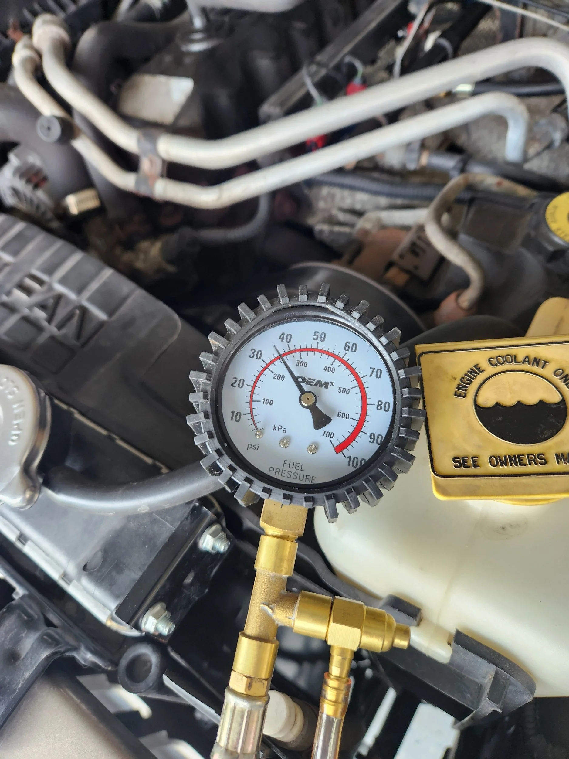

That’s too low brother. It’s a little confusing why STFT’s are trying to take fuel away with low fuel pressure though.
Well if the injectors are hemmoraging fuel... it's possible the regulator can't maintain pressure. But then I'd expect to see fuel trims maxed out at negative values around -20 or -25.
I'd replace the pump assembly. I put a Brute Power in mine from Rock Auto.
