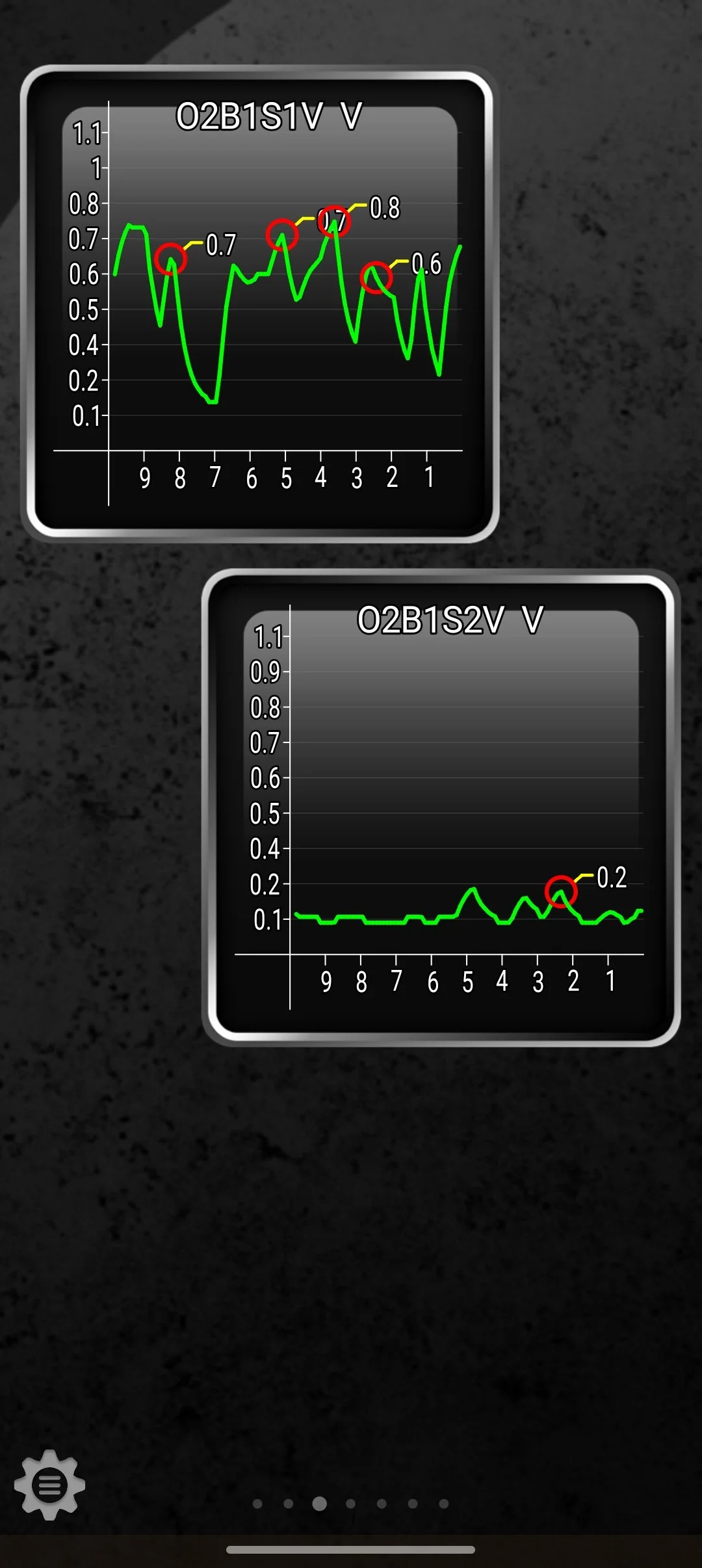

I'd get a ODB reader plugged in that can read live data. I can do that with a $30 Bluetooth ODB adapter and Torque Lite.
You want to make sure the voltages, generally and crudely speaking, don't exceed .9v.

Are the replacement O2 sensors OEM? I went through hell on my JK after replacing the sensors. I was getting misfires and a check engine light. I finally did essentially what Mac suggested and found the voltages were off a little bit. I bought some used stock O2 sensors on e-bay and the problem was solved. That was many miles ago and the problem has never recurred. Jeeps are very picky about which O2 sensors they like. At lease JKs are.
I tried NTKs. Even though they are supposed to be the same as OEM, they did not work.
