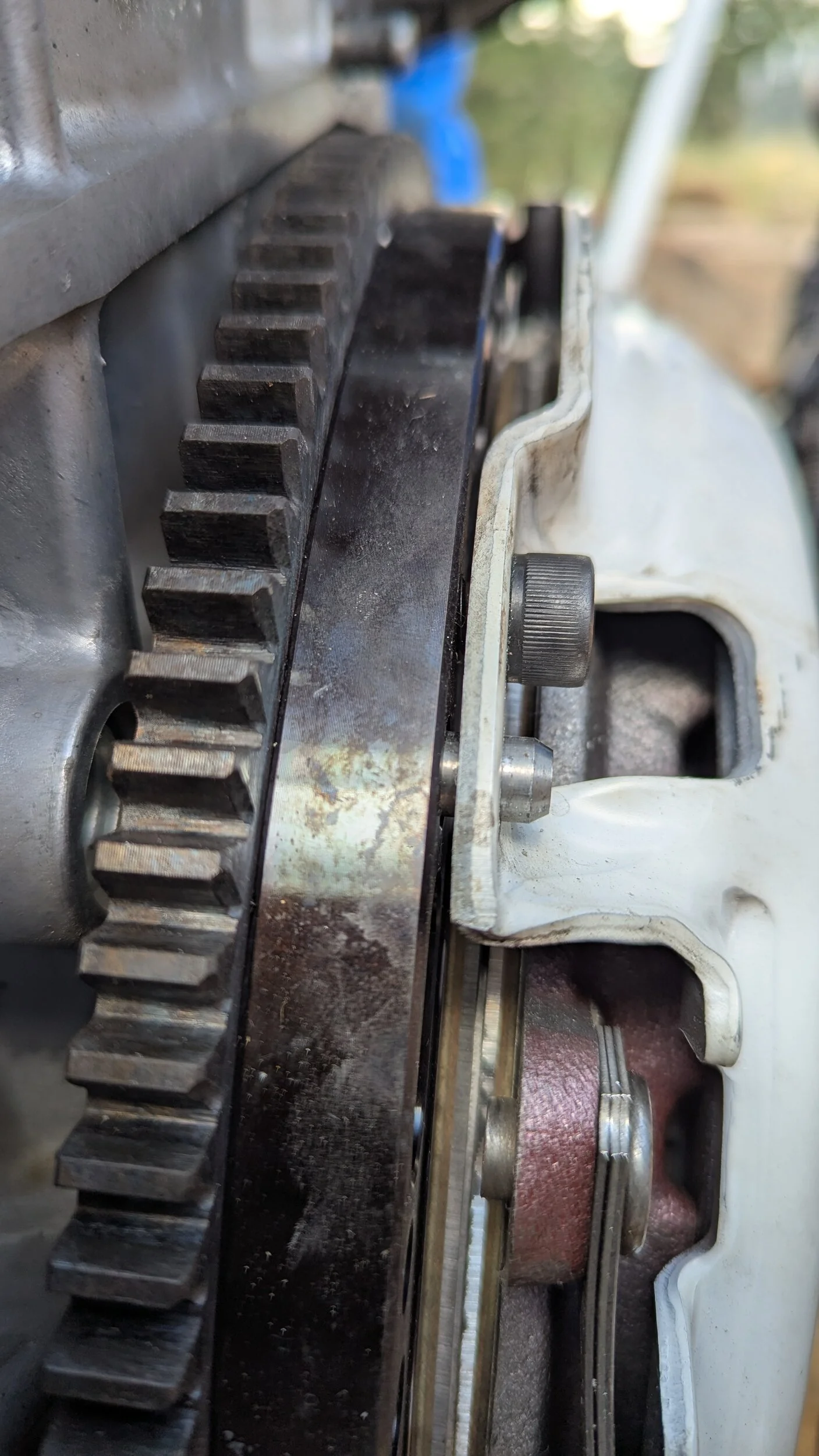

For anyone interested in my struggle bus.
The dowel pins were not the problem, I pushed them in and put it all back together and still had no functional clutch.
My pressure plate is deflecting under the preload from bolting it down. So, maybe I don't have the right one? I have another one showing up today.
Project cars are dumb sometimes
